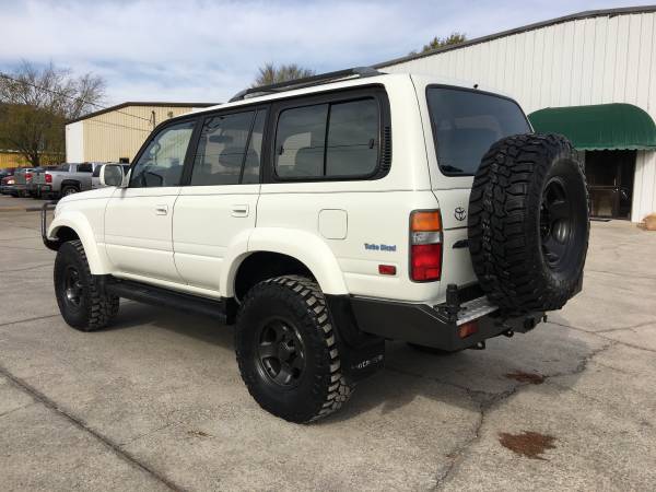

So locally to me is an FJ80 with a Cummins 4bta VE pump. Anyways here's some info from the ad.
Let me know if this would be better posted elsewhere also.
I guess my questions are what to look out for, what's it worth, and should I buy it.

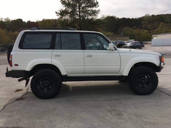

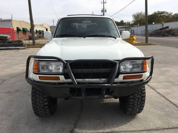

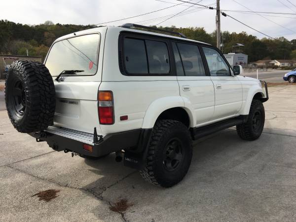

1993 Toyota Landcruiser FJ 80 337,000 body miles
4bt Cummins Diesel 3.9 with 6bt accesories, 150,000 engine miles
ICE COLD AC
Larger Radiator
Diesel Spec built 700r4 Transmission with lockup
Exhaust temp, boost and transmission temp gauges
All gauges on dash work, except oil pressure, which has AUX oil gauge
Center differential lock
Front Axle Has All New Seals and Fluids
Dual Brand New batteries
4" Slee lift
5 Brand new 315/75/16 tires
Dual fuel tanks, needs fuel lines for 2nd tank
Double carden front driveshaft
Adjustable panhard, caster plates

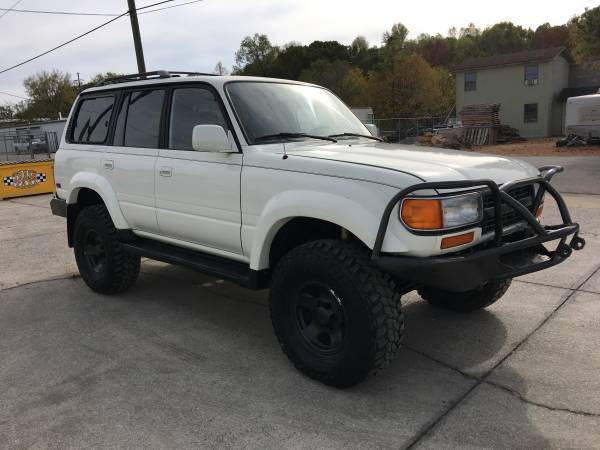

Custom front bumper with winch mount
Rear kaymar bumper with swing out tire carrier

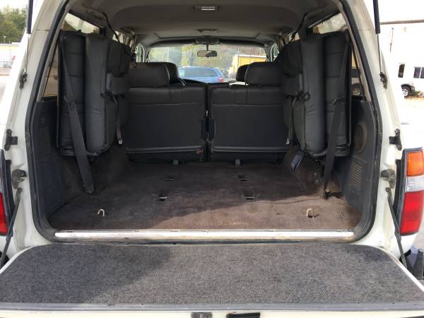

Rear jump seats
Fully loaded
Power everything, sunroof
ABS light is on
Everything works as it should
Title in Hand

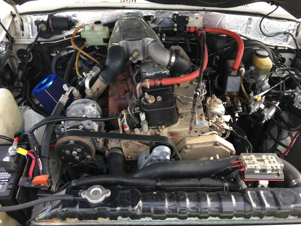

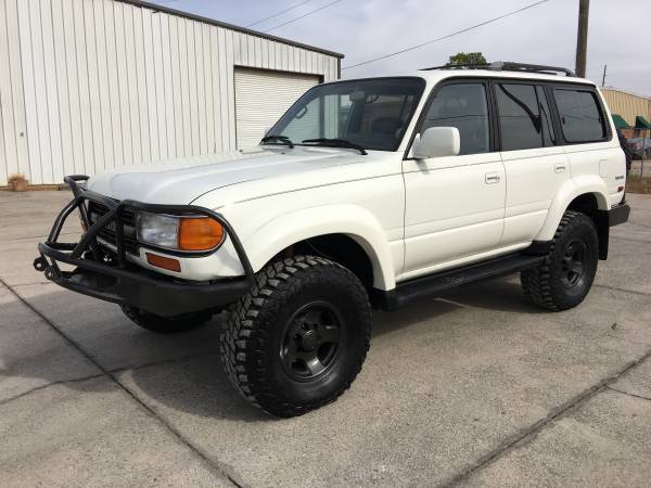

This motor mirrors the first gen cummins super simple bosch VE rotors pump. It's got an aftermarket air to water intercooler nothing special. swaps like this I always try to look at the parts and there used street value . this has a ton of good parts that in my neck of the woods seem to add up pretty quick. if your use to cummins you'll probably find that it's revs a little high at highway speeds. 3.55 gears are a lot better than 4.10 but that my be my opinion
Well, what kinda price range would you put on it of course cheaper is better.
10k to 15k that's what I'm trying to figure out myself.
I think that range is reaistic. The truck looks like it needs some love but if you follow guys' swaps on here, you realize they went through a ton of work getting the swap done right. The caveat is that if the job is done poorly it isn't worth squat. Do some searching about engine vibes with the 4bt, especially at idle, and make sure you're ready for that. Hope it works out, good luck!
I believe there are mods to the 4bt to smooth her out. Can't remember what, 6bt balancer maybe?
I've seen that one for a while. I think it is a little high IMO.
You can get a 4BT with balance shafts, but IIRC that was only an option on marine powerplant engine blocks. Nothing that you'd yank from a bread truck.
My range would probably be more around 9k - 10k, maybe 11k, but I doubt it's as nice as what images make it appear.
Given it's high mileage, but I feel it's a vehicle worth maintenance money and cleaning up.

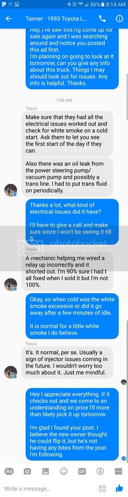

I did find a previous owner and this is what he said.
Pic of messages.
4bt will always have a rough idle. liquid fluid mount help 6bt damper might do a little but a flat crank 4cyl gas or diesel will always have that tractor feel. high idle makes it smooth out but most complain about it pulling to hard at stops. i don't mind mine at all. but if your use to an 05 Common rail it will be night and day difference. once there going down the road they are very similar to all other diesels.

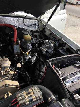

also the ac mount and belt looks goofy. do you have to remove the radiator hose to replace the belt? I've goofed mine up before there area few different tensioners and they mount different places to allow for different belt routing. that looks like an industrial/commercial mounts

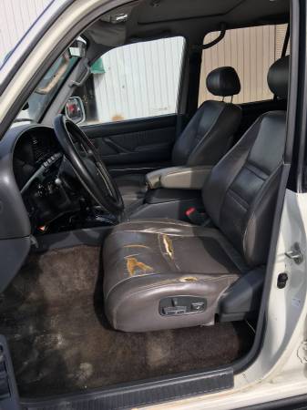

Well guess what, the new owner hasn't touched the thing. so safraid to expect it still has transmission leak, power steering leak, and it appeared to leak a bit of engine oil around oil pan.
Okay, so wow, it's loud it vibrates and idk if I could get used to it or not.
It's also sad that the new owner said it was a 2000 model engine, where the old owner said 1995. maybe I need to be schooled bc the truck had a rotary pump and I'm pretty sure those went out a long time ago.
I may give him his money back for it. 7000 it shifted great and had okay power though.
It definitely is a fixer upper and you'd be buying someone else's problems.
The body all in all was good for a rig this old that I'm sure has seen trails, nothing serious off road though. also I don't believe the front end has been rebuilt newly or recently, possibly in the vehicles life just not recent.

Do you know who installed the engine. Proffit's? Check the frame and see if it was notched to fit the accessories on the passenger side. Like @cjmoon said the belt routing is not good. You shouldn't have to unhook a coolant hose to change a belt. Oil leak on the power steering/vacuum pump is an hour fix with a $20 seal kit from Cummins. If the dude bought it for 7K he shouldn't expect to get more for it. It's not that special.
If you don't know if you can get used to the rattle and shake walk away. You won't. You need to love the rattle and shake to own a 4bt. Depending on where they mounted the motor you may be able to drop in a 6bt later on simply.
Also, is that Goodyear red hose being used for the heater lines??
