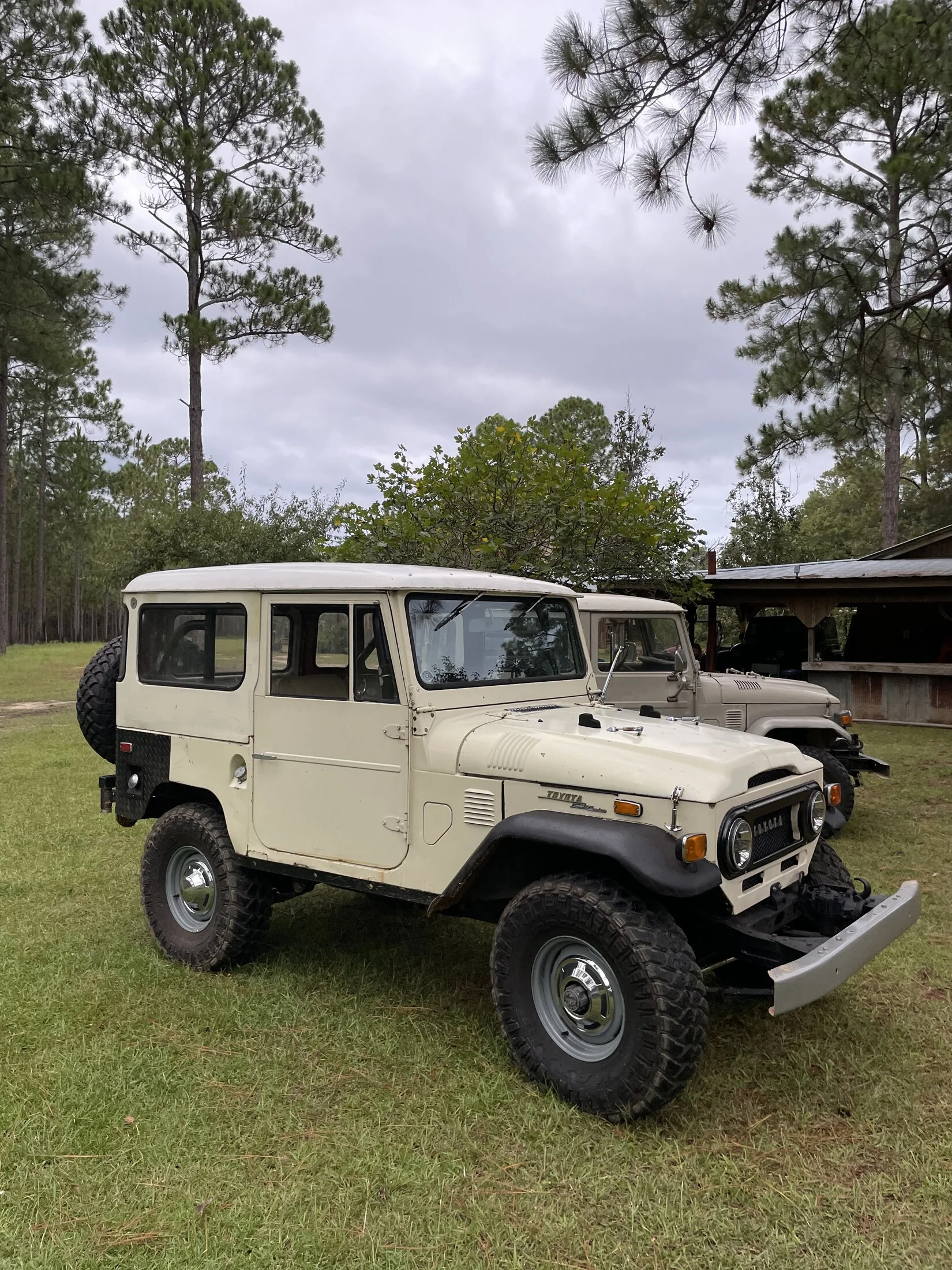

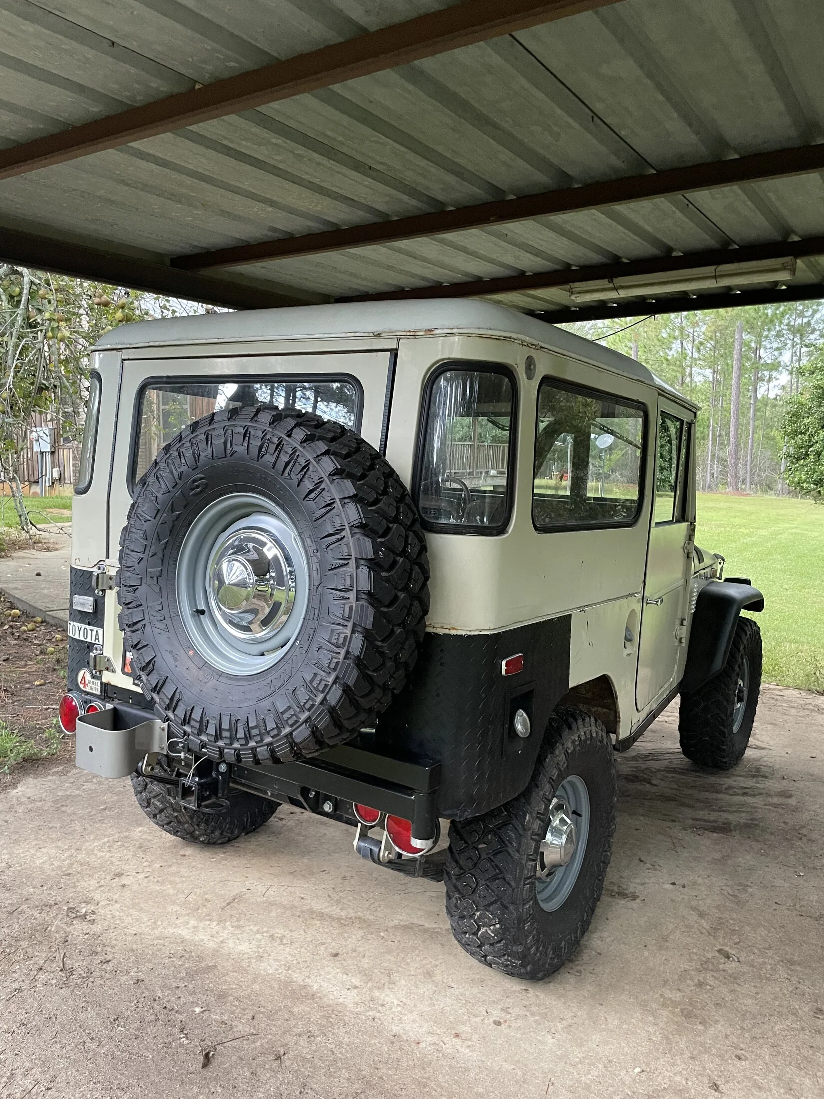

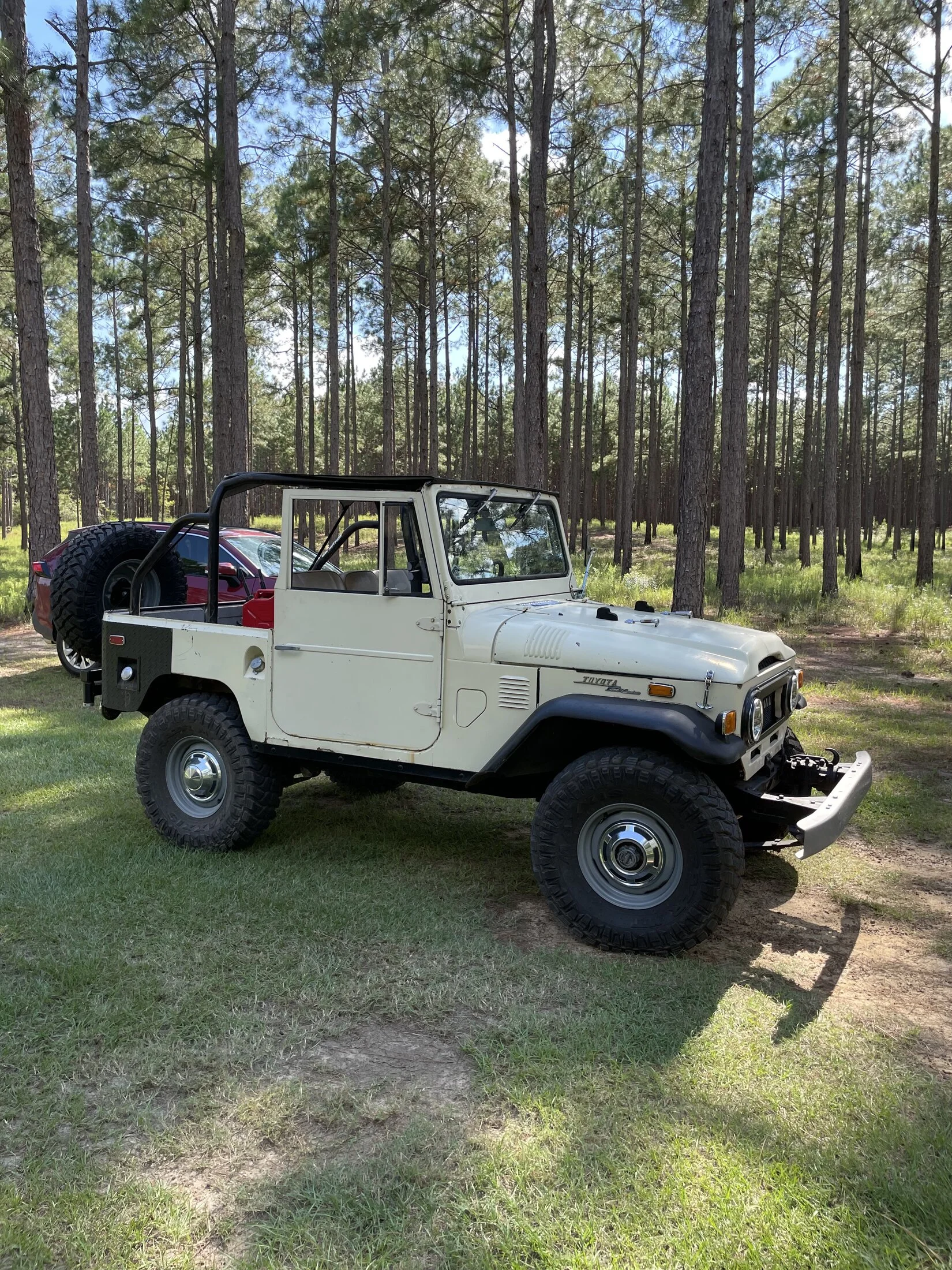

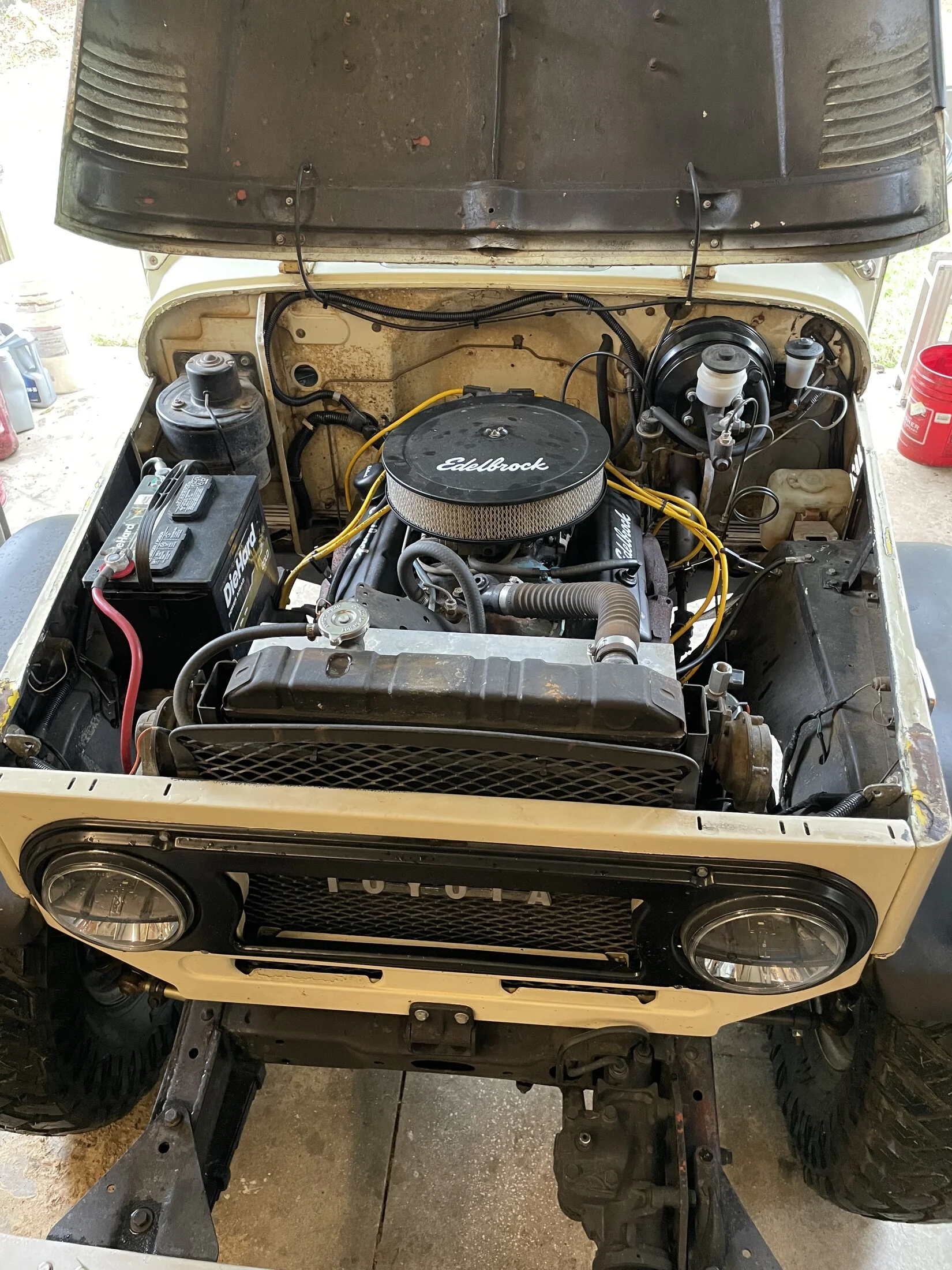

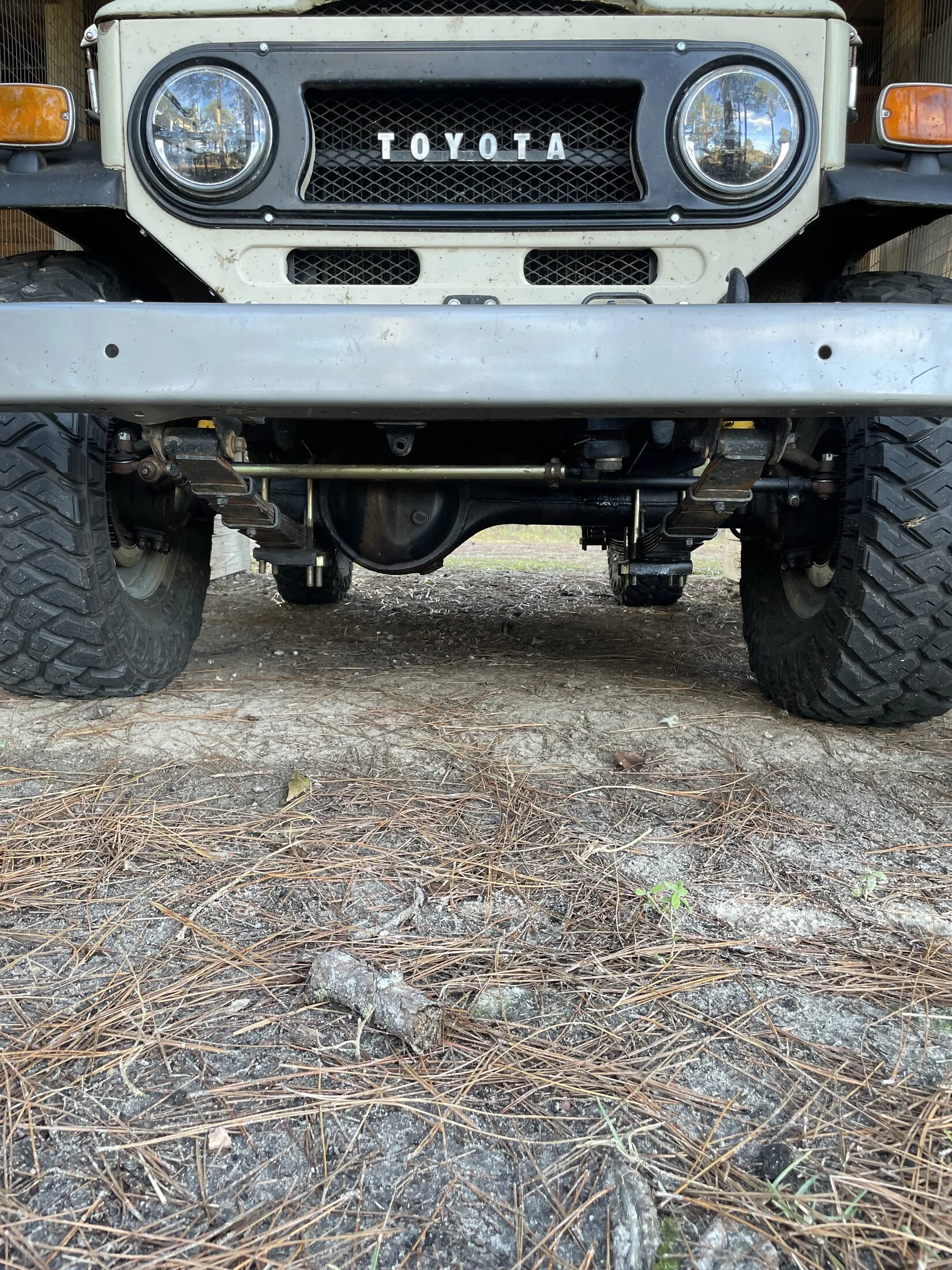

I picked up this ‘72 FJ40 last year from a member here in the Mud classifieds. It’s been an absolute blast to drive and wanted to detail all the mods that have been done by the PO’s and any future mods. She hauls ass and has been an absolute pleasure to drive.
The details:
350 SBC from late 70’s Corvette with the Quadrajet four barrel carb, rams horn exhaust manifolds.
SM 465 transmission mated to the oem transfer case
Flow master exhaust
Front shackle reversal with lifted Arb springs and shocks.
Four plus rear tire rack.
Maxxis 33x10.5 MT’s on new oem rims and hubcaps.
New oem bumpers
Saginaw power steering
Front disc brakes
New clutch master
New brake booster and master
New aftermarket gauges
Rear auxiliary gas tank
New body mounts
LED headlights
The frame has been refinished at some point and new oem body mounts were added. Rides really nice and not too many rattles. Body has the aluminum diamond plates in the rear but there seems to be very little rust overall. I have to admit the diamond plate make the look of this mad max style beast so I don’t plan to remove them. The paint is not original and not well done, lol, but it has a nice patina.

Had a pressure leak spewing antifreeze on buttercup this evening after giving it some beans earlier. Looks like a new water pump is needed. Love how simple these sbc 350’s are designed and shouldn’t be a big deal. I’ll give a closer look tomorrow in the daylight and know for sure. Topped it off and drove the last mile home with it, didn’t overheat and still had some pressure so must be a small leak. Napa should have a new one i’m sure. Stay tuned!

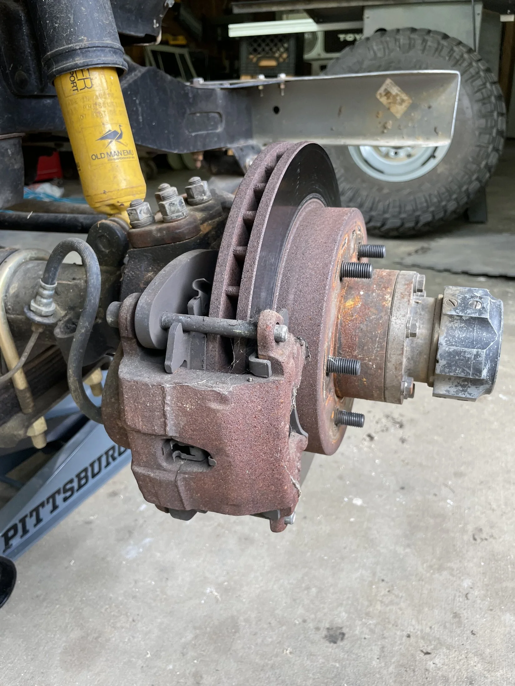

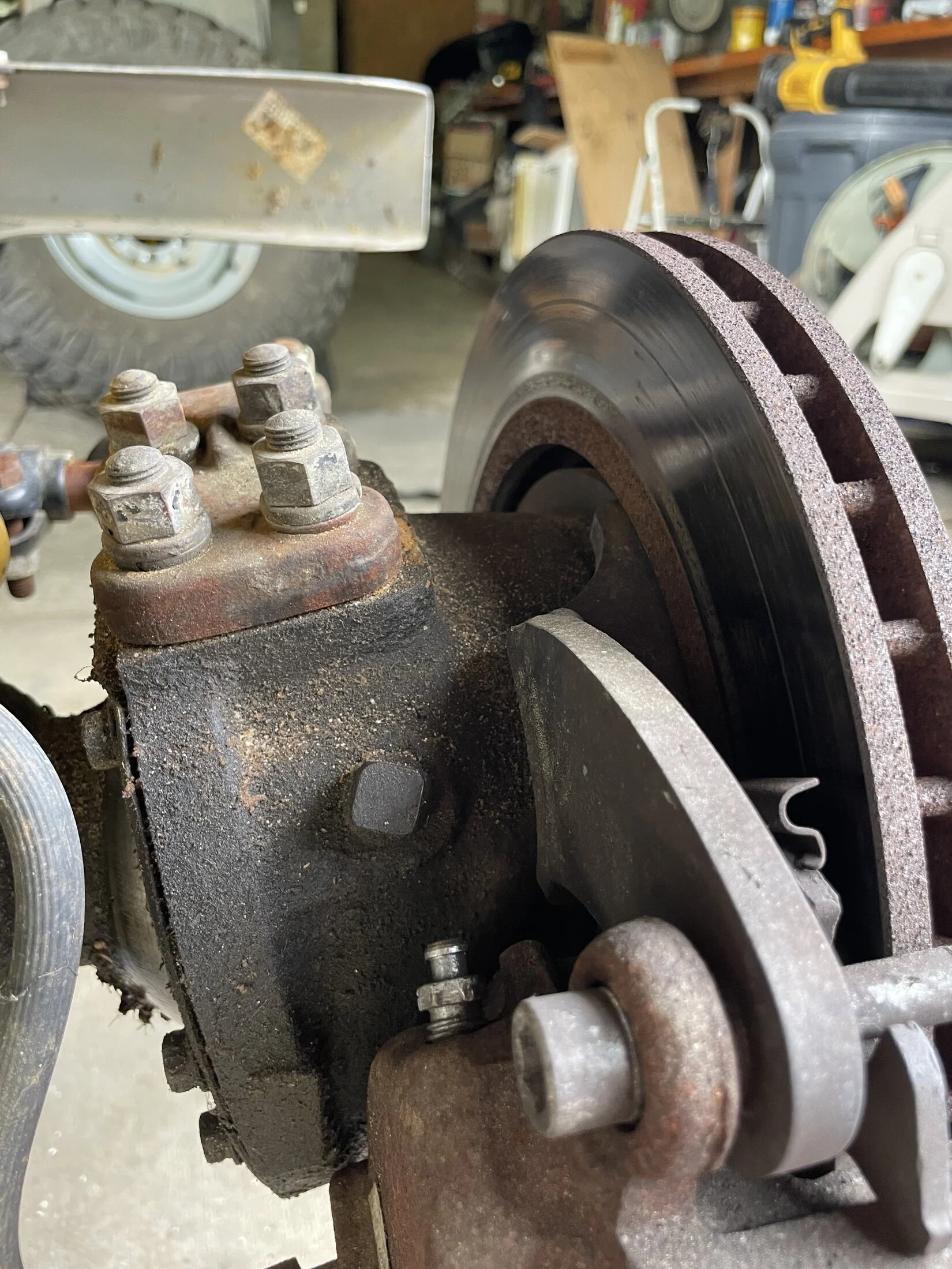

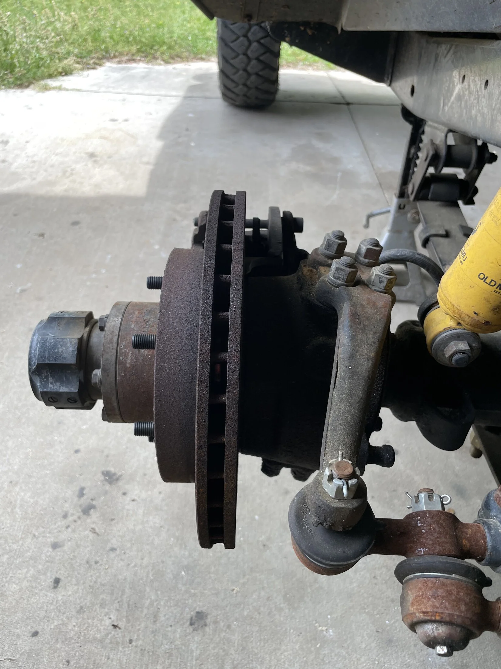

The brakes look like GM calipers probably off a Monte Carlo type car. Sbc's area easy to work on. You might want to take the water pump with you to napa. The later model ones are similar to each other, but some accessories holes are threaded or not. You may also run across some spacers on some accessory brackets.
Thanks for the info, I had heard that the brakes were from a monte carlo but had no way to verify. I’ve never owned a gm product or worked on one so its new territory for me. We’ve got a good local Napa so I’m sure they’ll be a great help sourcing parts.
