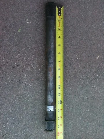

I think I broke my short side axle shaft. I dug out my extra shafts and I found two long side and two short side shafts. The two short sides are the same length. The long shafts are different, but the shorter one is tagged FJ40. According to my notes:
Mini-truck short side is unique.
FJ40 long side is unique.
FJ60 short side and FJ40 short side are the same.
FJ60 long side and mini long side are the same.
I recall harvesting FJ60 shafts and mini shafts for the birfields. Damn, I have no idea what I have. Anybody know the length of an FJ60 short side axle shaft? Or the length of a mini short side?
can't help you with the 60 but the mini short side shaft is 15&1/4 ''
Mine are 15-3/8" so mini truck shafts. Thanks guys.
