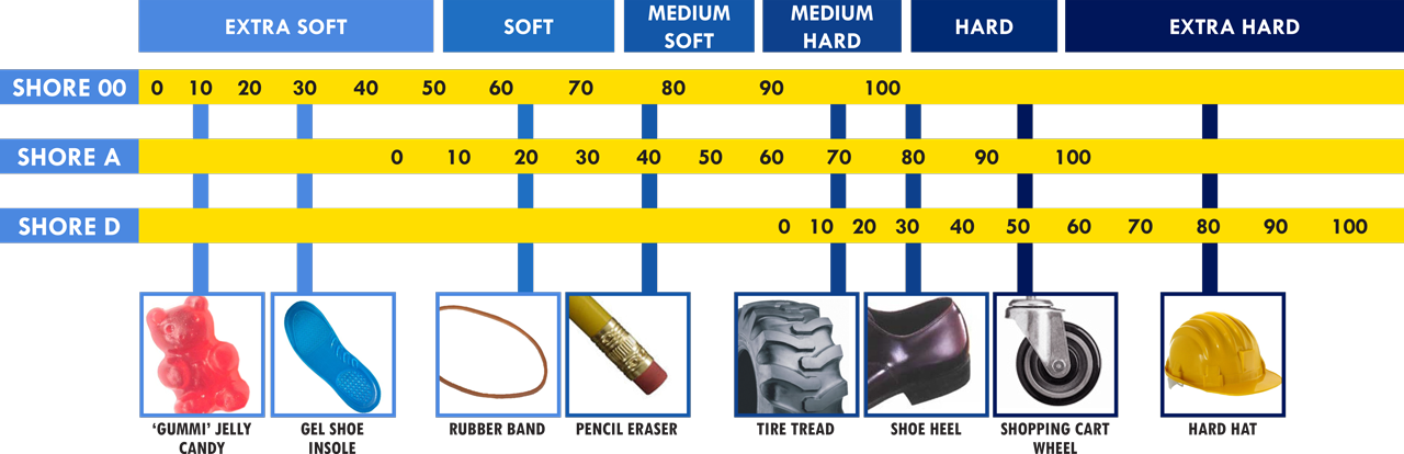

All of this results in a highly increased lifespan, lasting as long as the car does for many owners. On the Shore hardness scale, rubber bushings read between 18A and 60A (similar to a pencil eraser), while Polyurethane usually resides in the 80A to 95A range (similar to a skateboard wheel). Since the bushings reside in areas of movement in the chassis and suspension system, different hardness materials will affect both comfort and vehicle handling. With polyurethane filling these areas, the joints and linking points in the suspension have less cushion to impact and torsion. This ultimately translates more details of the road surface into the chassis, providing a stiffer ride. Whether or not car owners prefer this change all comes down to personal preference.
Polyurethane is typically measured on the Shore A scale and can be anywhere from 0 to 100.
Depending on where you look, poly bushings can range from 62 (softer than a tire) to over 100 (harder than a shopping cart wheel.) That link is a good interview with Energy Suspension. CCOT, speaking more narrowly about spring bushings says 65 (soft) to 88 (hard) is typical, and that makes sense.
It would make sense that softer bushings are less harsh, deflecting and dampening vibrations. However harder bushings would likely have a longer service life (when they are not asked to deflect too much) and provide more "road feel." I'm looking for softer myself but want to share this information as I find it.
