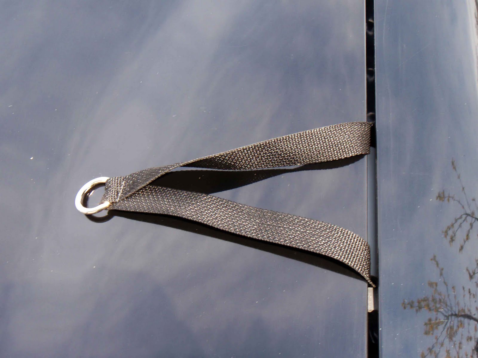

There are underhood bow line attachment points we use for canoes and kayaks to secure the bow and stern. They are two straps with brass eyelets that you bolt or screw into inside of hood area...when not in use the stay inside of hood area..when used you flop them out and then shut hood with them outside. Then connect your limb risers to them only when needed.
Here is a pic of one type of the hood mounting straps
In this one you run the straps through a piece of PVC pipe..then shut hood over it...it stays in place and you dont have to drill into engine bay wall if not wanted and can be easily moved from one vehicle to another.
Picture of inside mount on the bolt type
images
How it looks from outside
LIkely not as sturdy as mounting permanently or sem-ipermanently to bull bar or rack but is a good option for those that may only need or want them once a year for light brush and limbs.
The fender attachment bolts under the hood's sides might be a good attachment point. You could use a small piece of rounded edge strap iron to stress relieve the strap, and make it so it doesn't put pressure on the edge of the hood.
