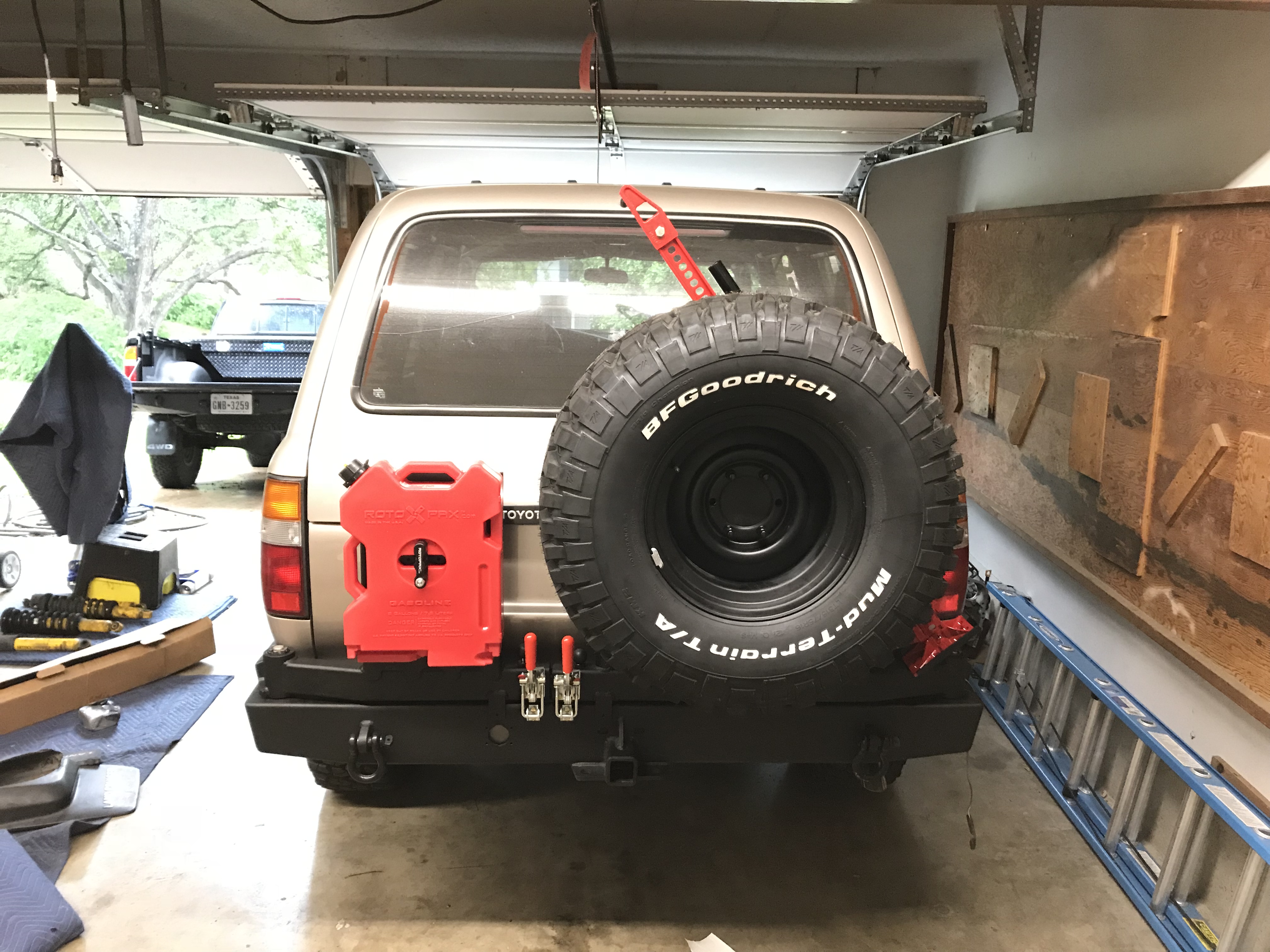

I've got 4" OME comp coils in the rear and with a full load of camping crap, full rear bumper and single 35" spare, the truck is starting to lose some rear ride height for me. I plan for a larger fuel tank and drawer system too, so the weight will only be going up, but I will say that as it stands I've got "enough" lift in the rear. Moab-grade rock crawling is still totally possible with a full load on the suspension setup I've got, but I think I'm due for a stouter suspension setup overall when I take the next step, gear-wise.
Attached are photos of how the truck sits *mostly* loaded (just my table and 60lb. box of gear unloaded) as well as a representative picture of how much crap I haul.
