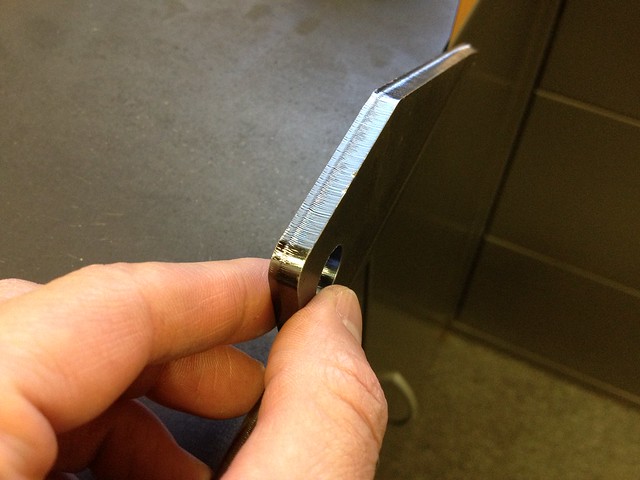

In my "spare" time at work I drew up a nice looking tube bumper design. I went back and forth whether to weld or bolt on. Bolt on won and I sent my drawing to our sheet metal vendor we use at work and got this back:
At the last minute, I settled on 1/4". Glad I did. It's stout:

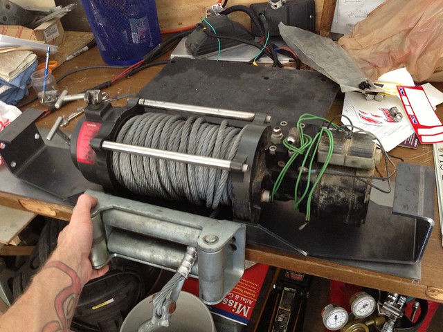

I'm using a Mile Marker 10500lb hydraulic winch that I had on my last 4x4. It's a pretty compact low-profile winch. I guess it's the regular non-integrated solenoid winch size? Either way, this is the winch on which I based my dimensions.
In the next photo there's some non related metal on the bench that isn't part of this. Mocking up the winch while holding the fairlead:

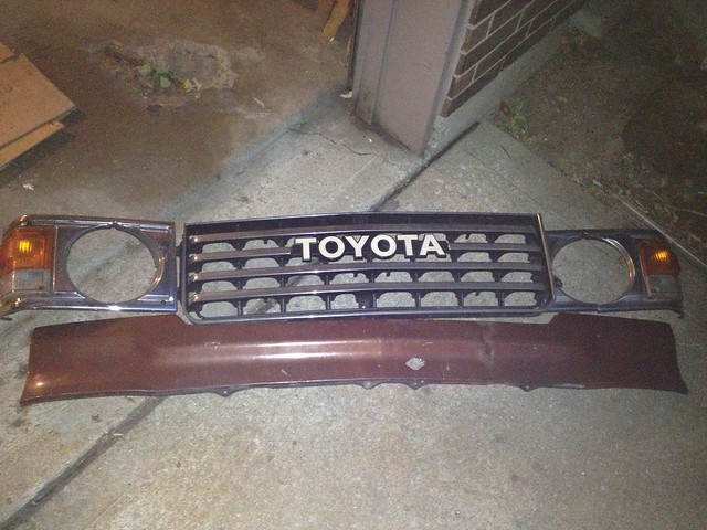

Disassembly:

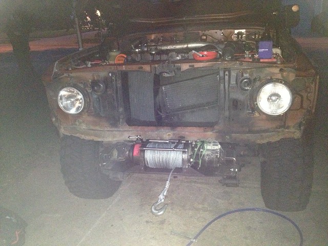

The goal was to get the winch between the frame rails and back as far as reasonable. This meant removing the valence which I didn't mind. But I knew that this would open a can of rusty worms :rolleyes:. Ugly naked shot :o:
You can see how ugly the rust is at the bottom edge below the headlight:
After some rust trimming and black spray paint it's not too bad:
Now the fenders look like fangs coming down on either side :D

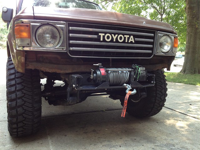

Approach angle. Of course the fairlead will stick out a little:
A shot with the plate painted and no winch:
There is some design for assembly in here too. The winch can be removed with the plate bolted to the frame. And, this is SUPER easy to install AND remove. Slide it over the frame rails and bolt using existing holes that are from drilling out the bumper bracket rivets.
