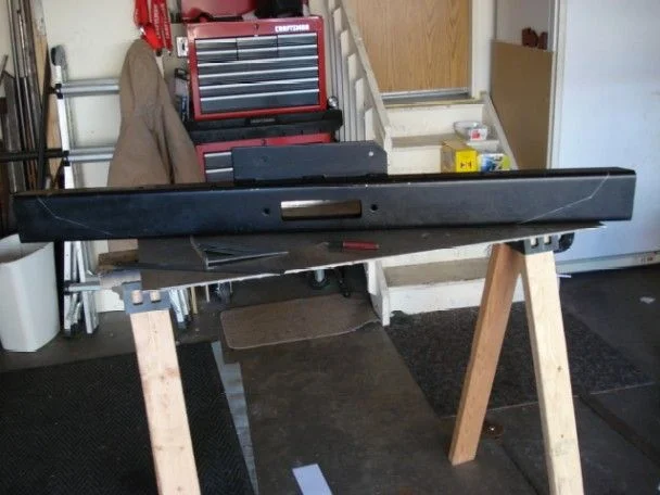

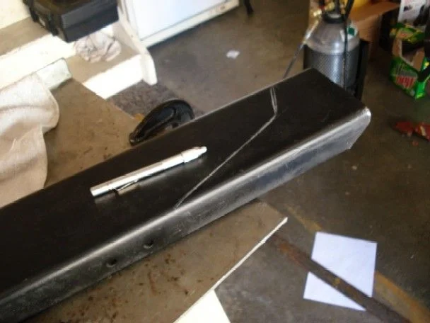

I started with an old winch bumper that I have had in my garage for years. I like the look of upswept "wings" so I marked off what I thought looked nice. I like to use soap stone for marking things up, if you don't like the lines you can simply wipe them off with your hand or a rag. That is my soap stone marker "pen" by the mark.

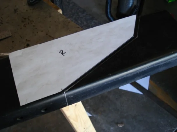

Next I made a quick template out of some scrap paper and cut it out with an xacto knife. Then you simply flip the template and measure from the middle and you have identicle sides. Another nice thing is using a silver sharpie, I just recently was told about them and they are awesome on metal! :D

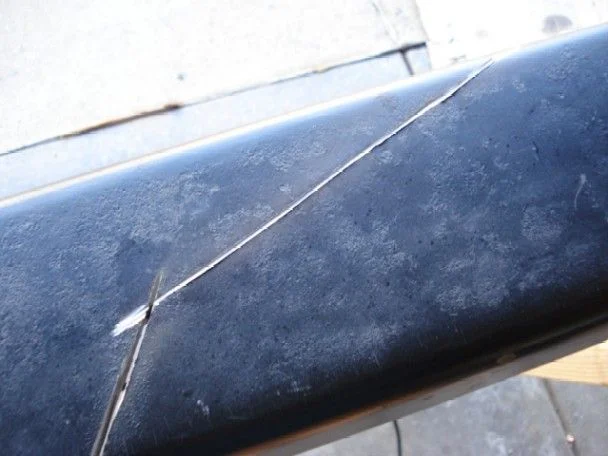

After both sides are marked it is time to bring out the grinder with the cut off wheel. The key to getting a good clean line is allowing the cut off wheel to just score the surface while you focus on keeping it straight. After your first pass the grinder kinda runs inside the groove you just made. A good cut off wheel is worth the cost over crappy ones IMHO.

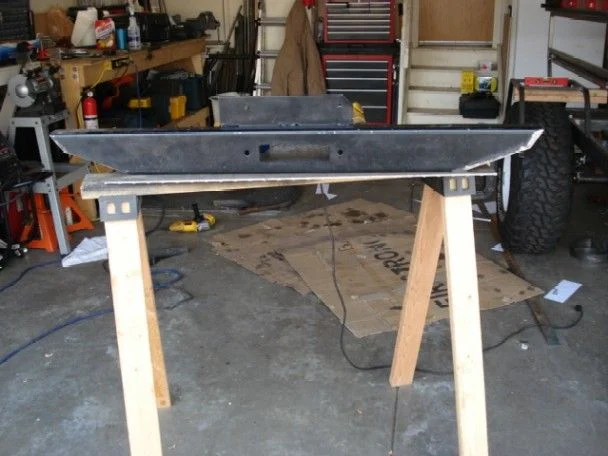

A few minutes with the grinder later and I have both ends cut to size and shape.

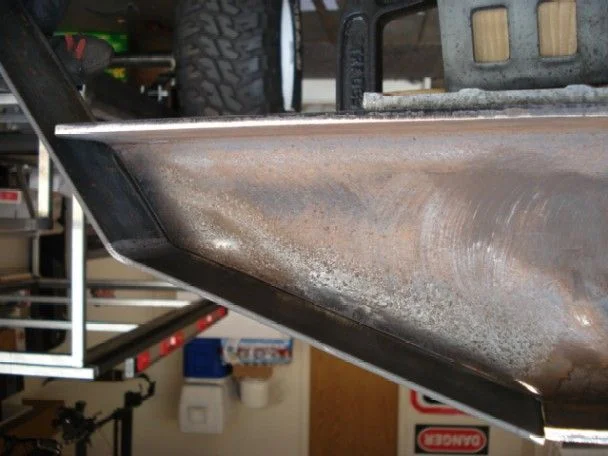

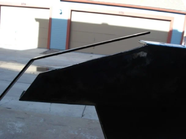

Next I bent up a piece of 2" x .125" flat stock to the shape and profile of the new cuts I made on the bumper. I simple measure the piece, cut it to size, put it in the vice at the bend point and beat on it with a 3lb hammer until it fits just right. FWIW, I probably went from the vice to the bumper 8-10 times per side until it was right. Slow and steady wins the race... I guess :eek:
This is about where you want your gaps to be.

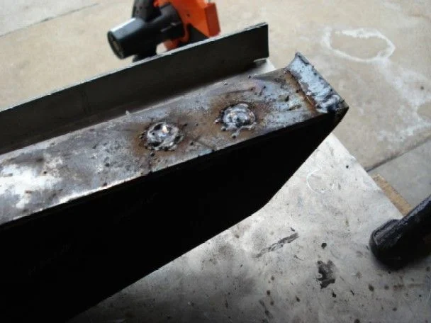

Next I filled in two holes with the welder. I am not sure what they were for, maybe a license plate mount?

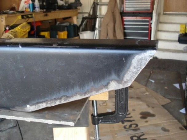

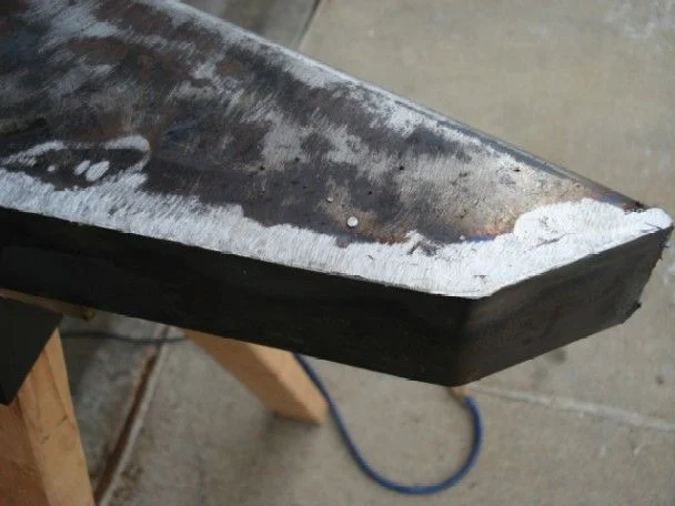

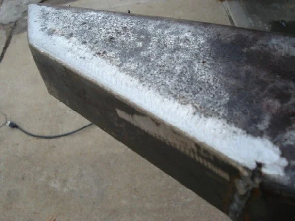

Anyhow, now it is time to grind, this is by far the most tedious part of fabbing things up. This is one of the reasons I think that strong welds that also LOOK good are so cool, instead of grinding everything down you can show off how good your welds look. This wasn't the edge to show off :D
The key to grinding your edges into a clean smooth nice looking edge is really easy IF you:
1. Knock all the big welds down first.
2. Keep the grinder perfectly level to the surface you are grinding on.
3. Just feather the weld into the original metal... THEN STOP.
To make a nice rounded edge you:
1. Keep the grinder moving fast up and down the edge.
2. Each pass you over lap the last to start to make the curve.
3. If you have ever used a hand plane in wood working, it is the same idea.
To clean it up, use a flap disk it is much less aggressive and it will give you a nicer over all look.

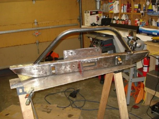

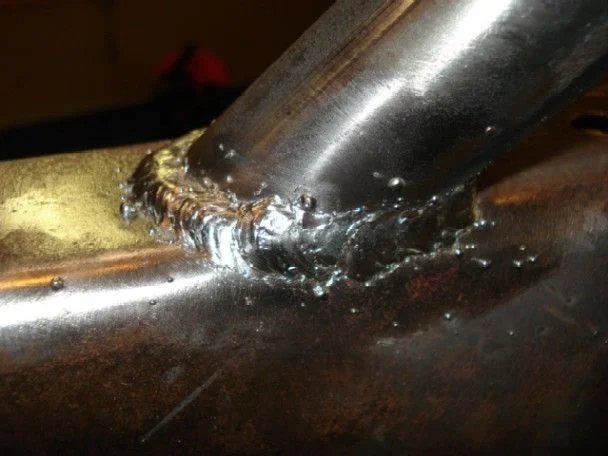

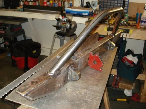

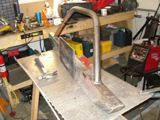

After the foundation was where I wanted it, it was time to move onto a few of the doo-dads that will make this a fun little bumper on the front of my 40. First, I wanted to add a bit of winch protection and a little protection (though not much) for the lights as well. So, I bent up a piece of 1.5" .125" tube of HREW steel. A big prop to Ullr for using his JD2 bender, it makes light work of bending up steel.
The hardest part of mounting the tube is cutting the bottoms correct and flush and EQUAL. Then it is simple as a tack weld to hold it while you burn the rest of the tube in.

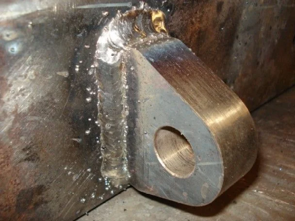

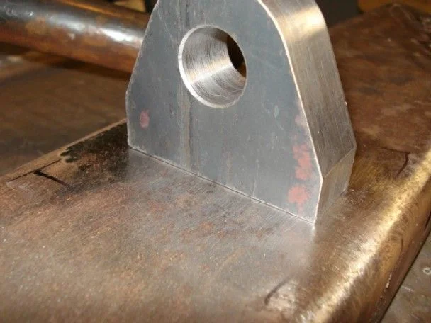

Recovery points were next. I sourced these screw pin shackle mounts from a dude in Colorado Springs called Rocky Mountain Machining, they are really nice and beefy, you can find him on Ebay.

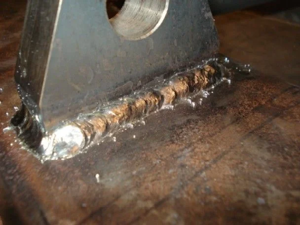

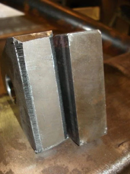

With something this big and thick it is important to bevel the edges so that you can make multiple passes with the welder. Remember, these mounts will experience HUGE loads and making these stick is a MUST. If you don't feel like your welds/skill/welder won't penetrate enough steel to keep these mounts in place, then source it out to a pro or a friend who can make the correct, safe welds. I used my 220v Lincoln on the hottest setting and did two slow passes to burn them in properly.
This first pic shows the weld after one pass, the second pic is after the second pass with welder.

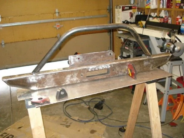

This is where I ended up tonight will all the major fab work done. I like the way it came out :D Nothing really new, I just wanted to give some insight into what goes into making something like this.

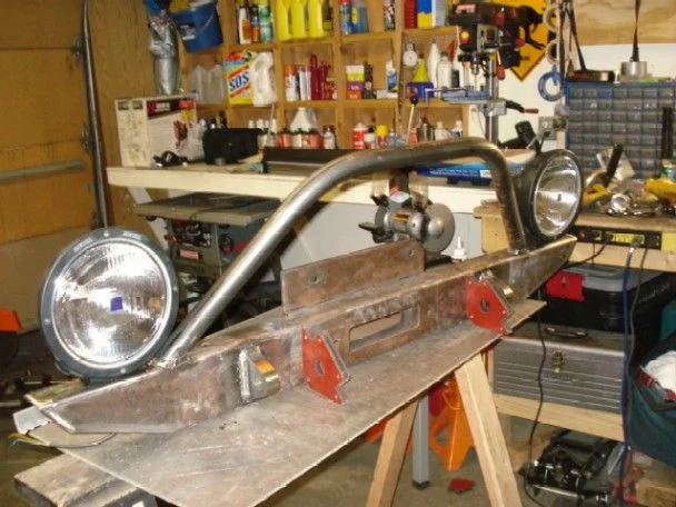

And one pic with the reasons for the bumper build...
Now I simply need to clean the rest of the metal up for finishing. I may use a simple rattle can, but I have thought of trying Hammerite (sp?) Finish, any use this stuff, I have heard good things. If the metal cleans up without too much work I may consider powder coating it. Either way, I hope to wrap it up soon.
