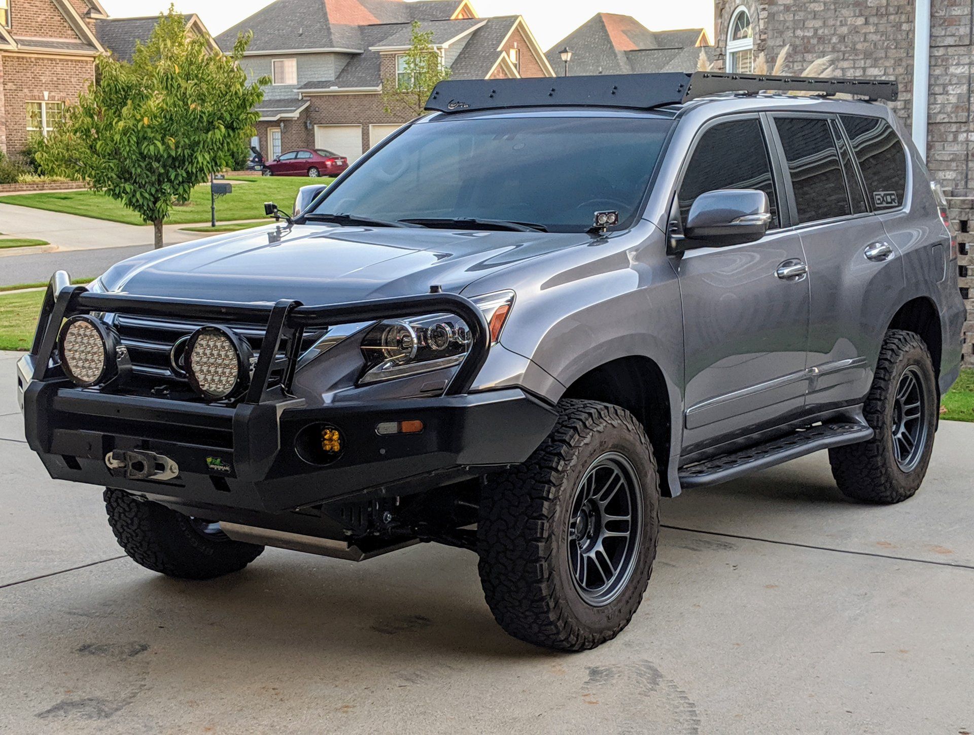

I've had an ARB on another rig and IMHO, the Ironman is comparable in quality. I only paid $1250 for the Ironman, so couldn't justify the extra $1000 for the ARB. The ARB does fit a bit tighter to the grille, but I'm happy with the Ironman fitment. I do like the 2 piece winch cradle as well for ease of installation.
Sweet build - Do you ever have problems wheeling with the tint? Looks pretty dark but perhaps you wheel with the windows down all the time.
No issues yet...it is only 18% in the front, 35% over factory in the back and 55% on the windshield. I usually run this combo on all my vehicles, so am very used to it. The ditch lights definitely do help out the sides, but it is no big deal to roll down a window either. However, I don't typically do too much night wheeling.

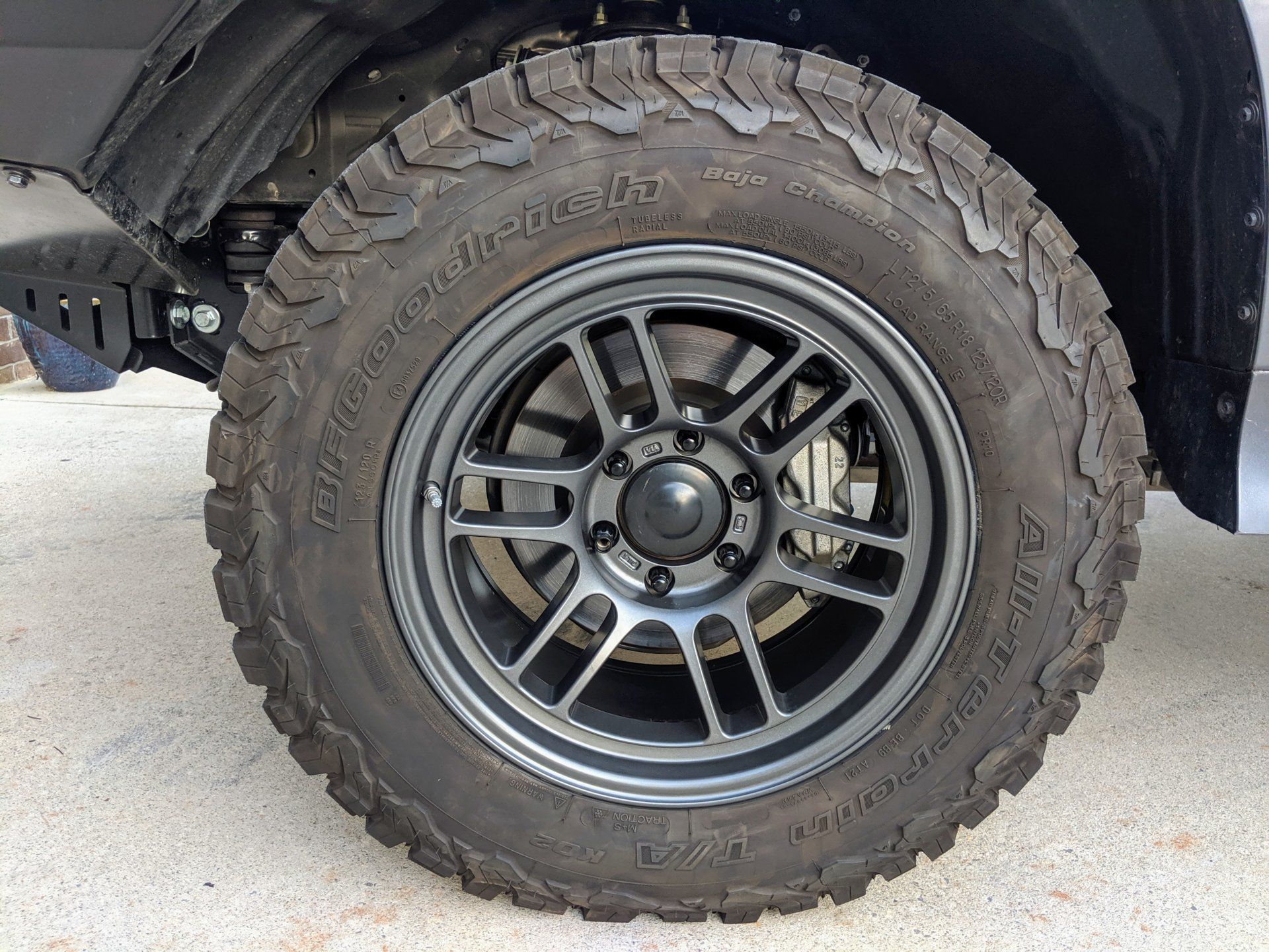

Funny thing about wheels and tires. I would have just gone with a M/T on my factory wheels (I kind of liked my factory wheels), but the cost of going to an 18" M/T tires over time in relation to the cost of 17" M/T tires was just too much. Yes it cost me more to purchase new 17" rims and tires rather than just the getting 18" M/T's and mounting them on the factory wheels. But I considered the long term effect of purchasing new tires every time my 17" tires wear down or (heaven forbid) blowout. I found the cost over the long haul going with 17" wheels and tires is cheaper than 18" tires on factory wheels. Also, 17" is the most common rim size for trying to find a tire. I considered this, should I ever be in the middle of nowhere and need a replacement tire my chances of finding my size increases.
Fair points, but I personally feel the "price of tires" thing is overblown. Let's be real...any 32-33" quality tire in a 17 or 18" wheel size is $300ish give or take $25 or so, even cheaper if you wait for sales/rebates and do price matching. Over the life of a vehicle, that isn't a whole lot of money differential. Also, quite a few pickups come with 32-33" tires standard on an 18 these days. In some super rare case that I ever have 2 unrepairable flats and need a 2nd spare, I'm sure I could find my size street tire in a pinch.
@r2m I’m not sure what brands you are shopping but as an example, KO2s in 285/70/17 and 275/70/18 are within $15-$20 of each other in price. You’ll likely not own the vehicle long enough to get that savings back when you factor in the cost of purchasing wheels.
Depending on your use, there are lots of benefits in going to a 17”, but long term cost is likely not one of them.
