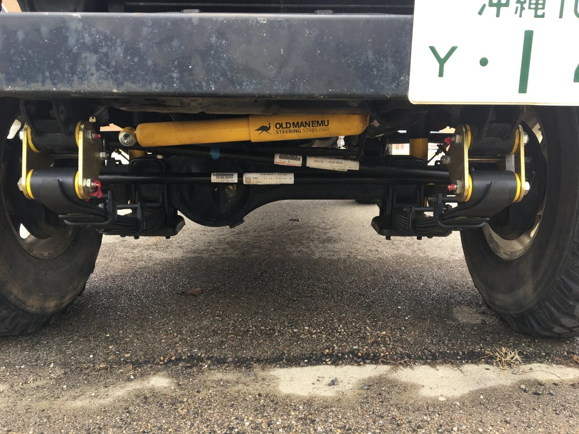

85% done with my suspension. Did new steering bars and tie rods as well. Won't be anymore progress till Tuesday. My phone is full so no pictures for now.

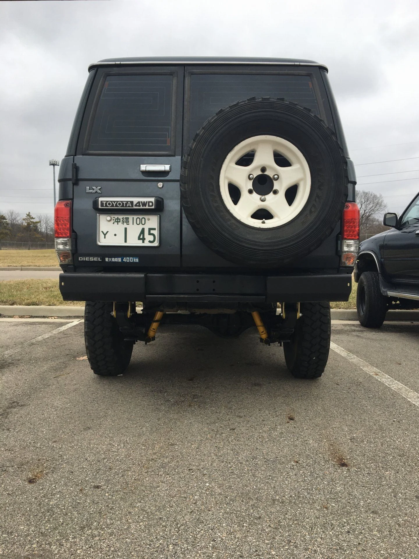

Suspension is in. Raked out bad but the lean is gone. Also installed my steering links. Truck is awaiting alignment. I'll take her out tomorrow. I will likely end up pulling a leaf out back. I can't imagine they will settle enough to level the truck.
One leaf in the rear will absolutely settle it a fair but but I'd get some miles on it first. The front has the heavy load of the engine, the rear gets all the migratory load. Worst case pull 1-2 rear leafs out of each rear pack. Front stance looks really nice :cool:
