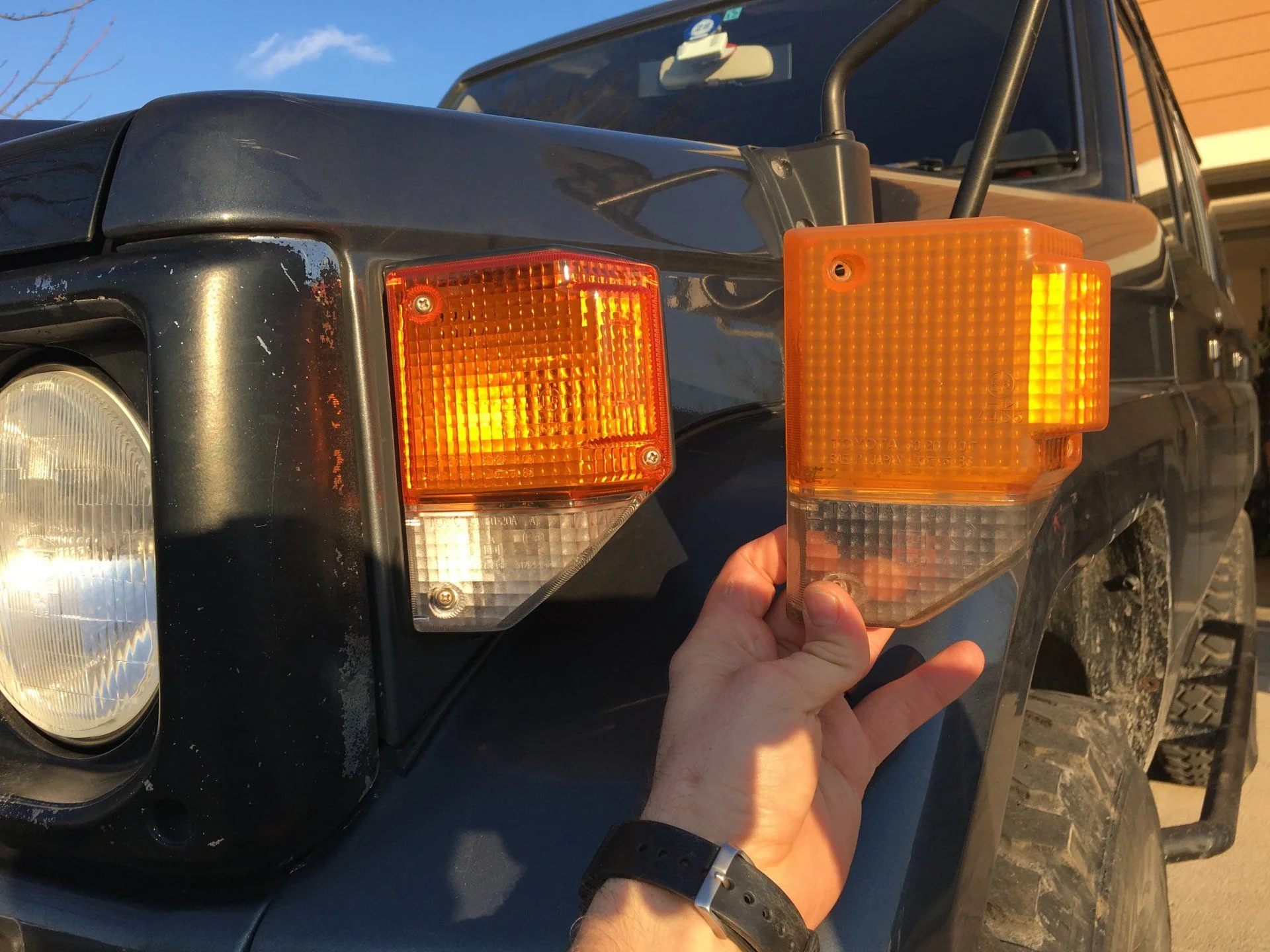

When those indicator lens look dull or faded, polish them with car polish. They come up like new.
Plan is to polish them up and put them on the shelf "just in case". I bought new ones because the PO tried to smoke the clear section.
