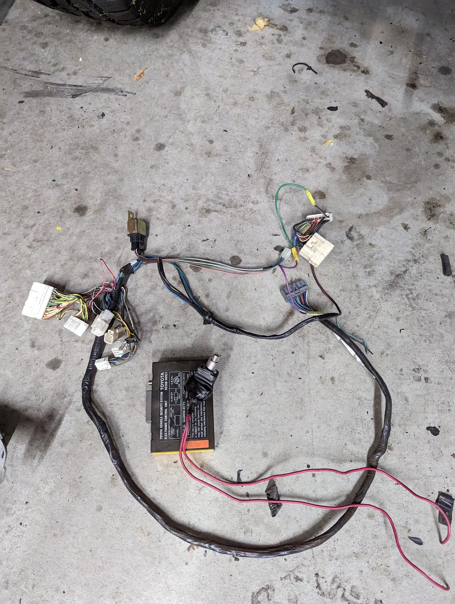

And one last project before bed. Removed the alarm system and some other random aftermarket wiring that wasn't going to anything.

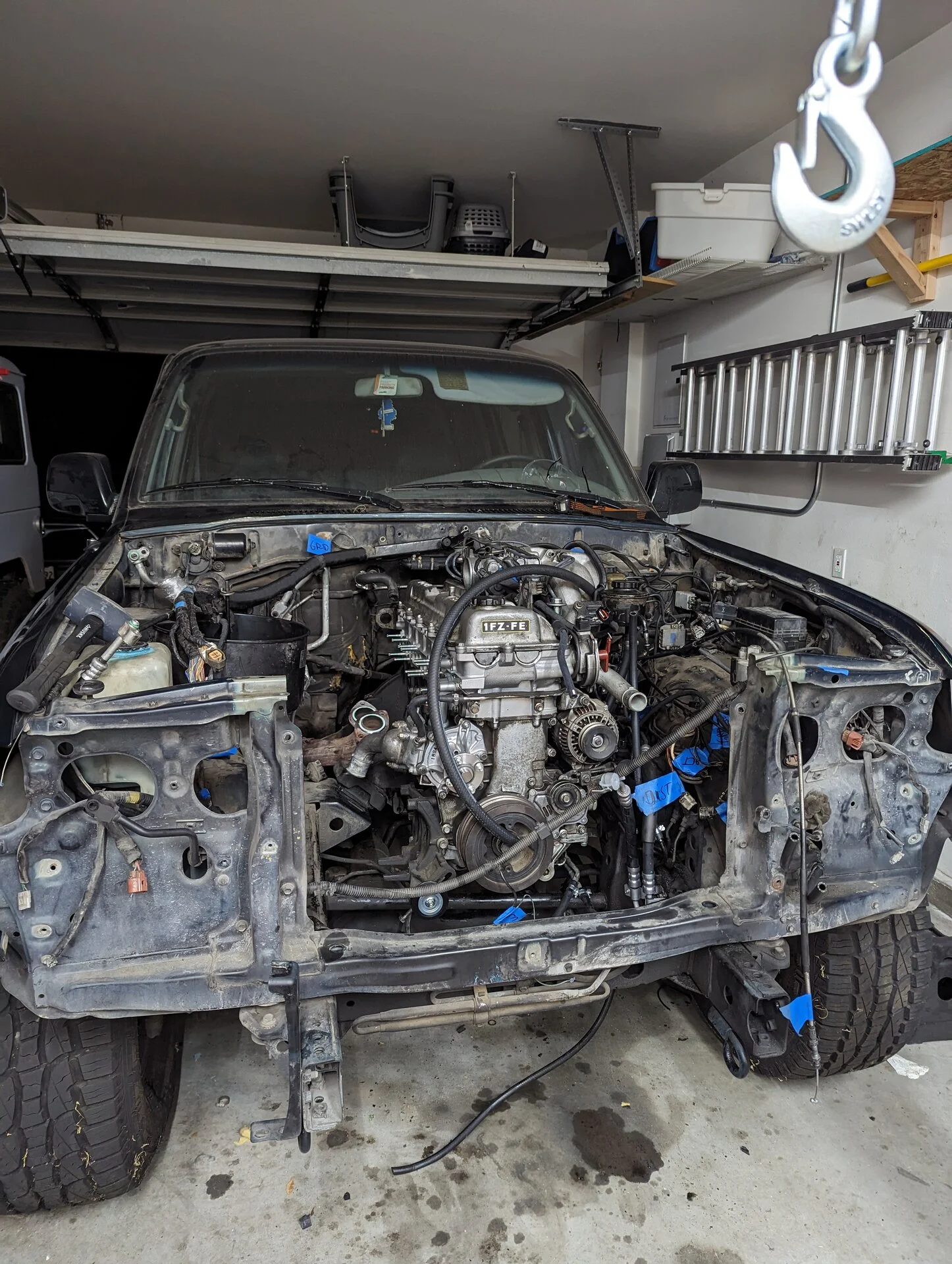

Well, I thought tonight might be the night I get to try to start it but as I was adding oil I had a large spill. At first I thought my upper oil pan was maybe leaking but I had the wife pour while I was under the vehicle and its coming from behind the harmonic balancer. I look in my parts case and what do I find? The front mail seal sitting in its packaging.
I had put the HB on to check my timing marks as seen a couple post back and I forgot to take it back off to seal it and ended up torquing it down yesterday. Im done for the night but tomorrow I am gonna attempt to change it out without removing the radiator as I literally just filled it in preparation for starting.

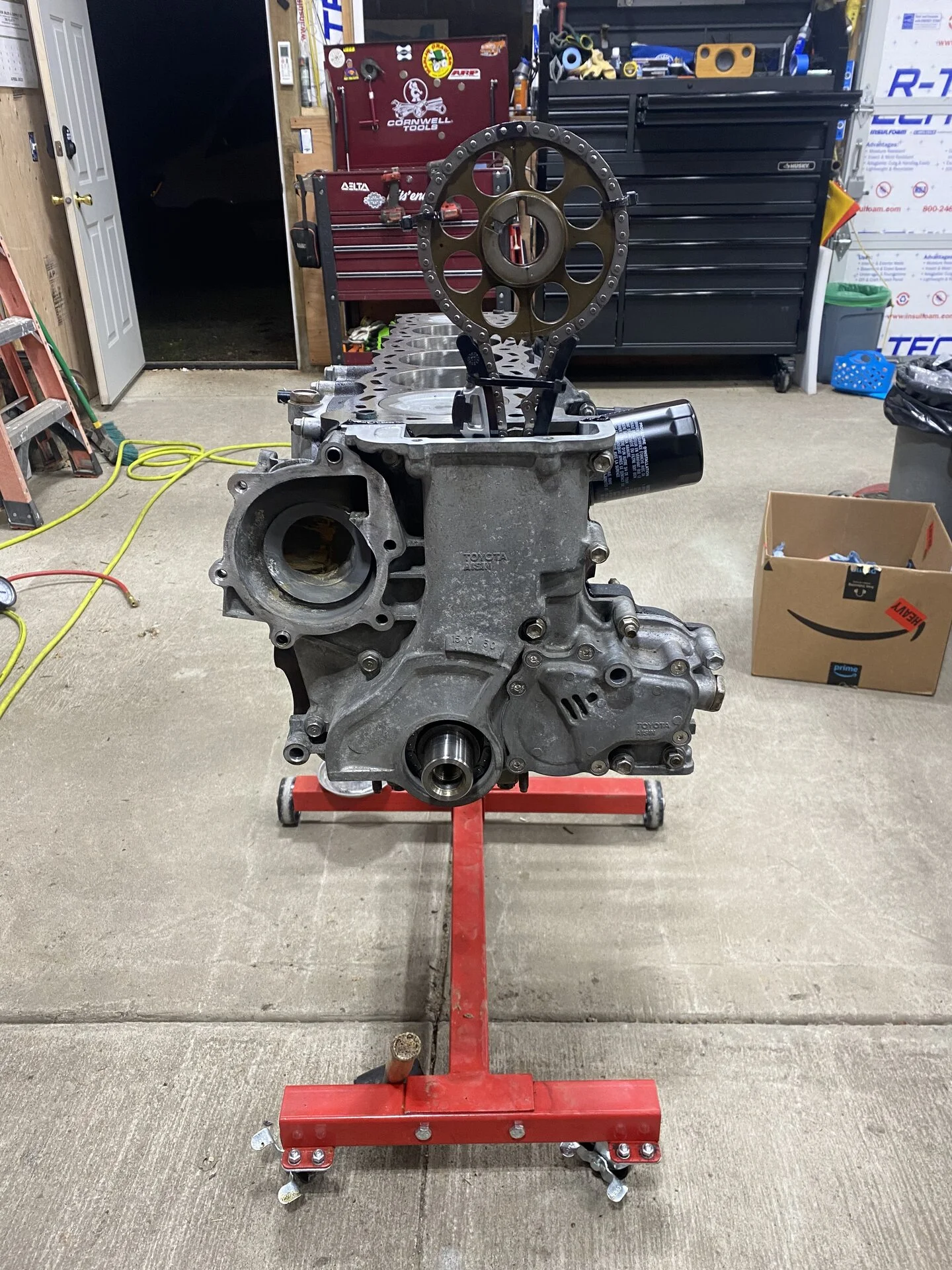

Man long repair! But good job following thru! Do you have a holder tool for the harmonic balancer? We have all forgot something on a Huge job like this. Great work and keep it up you’re so close to the end. Motivational pic for the front main seal just put one in Last week a 2” pvc or abs hard cap are a perfect seal driver. Obviously pic is with seal not installed.
Yea I have the HB holder. I could have sworn I put a new seal in and that the one sitting on the work bench was just an extra but I guess I was wrong. Plus looking at some recent photos I took before putting the HB on to check timing marks I can see it doesn't have a seal.

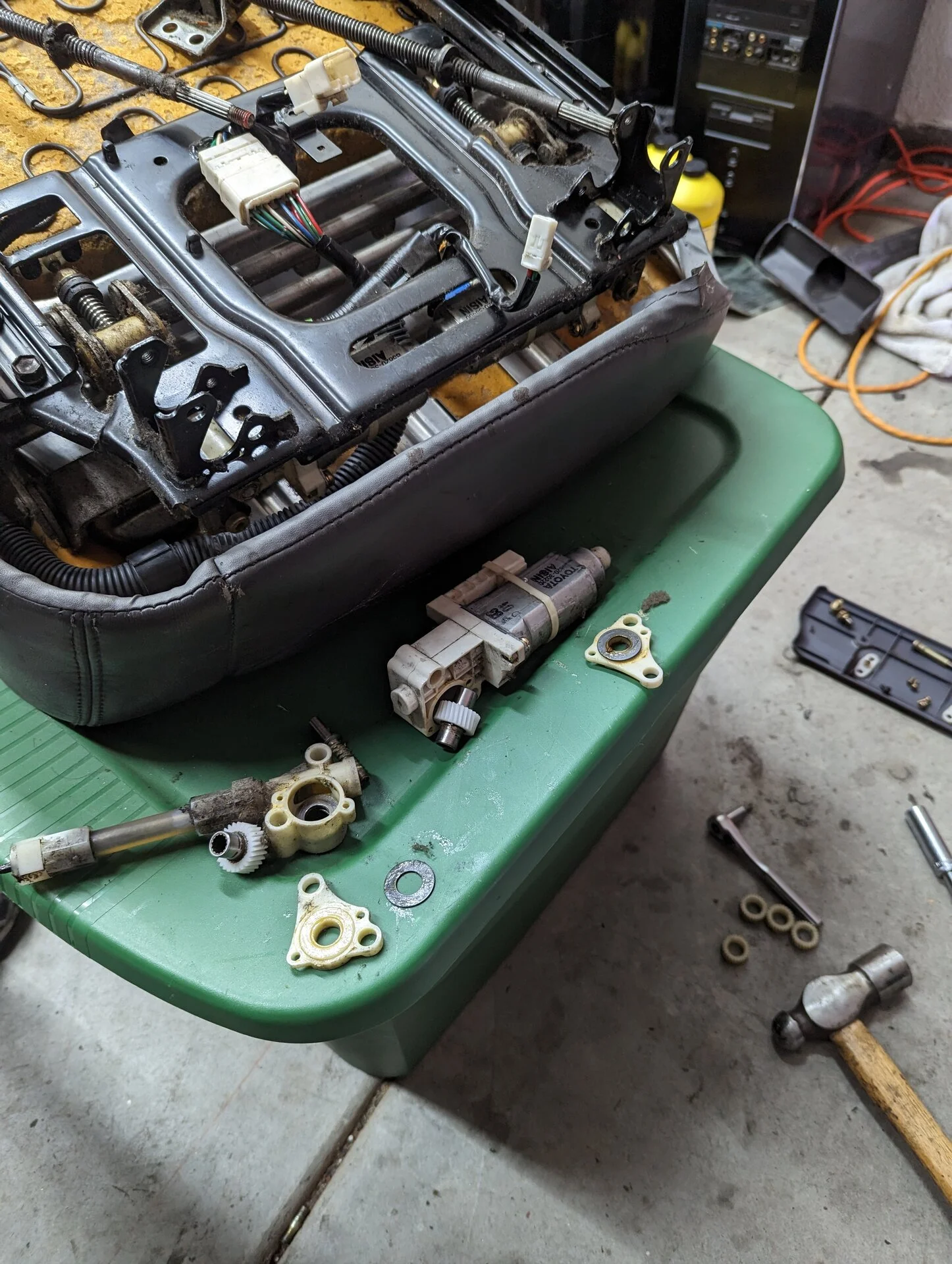

replaced the seat gears today. Passenger side is working good. The driver side not sure what is going on. It was working with the new gear and then started acting like the new gear was stripped again. Not sure if I put to much grease or what. Have to pull the seat again and tear it all down to take a look. At least for now though its stuck in the furthest back position so I actually fit vs the closest position it was in.

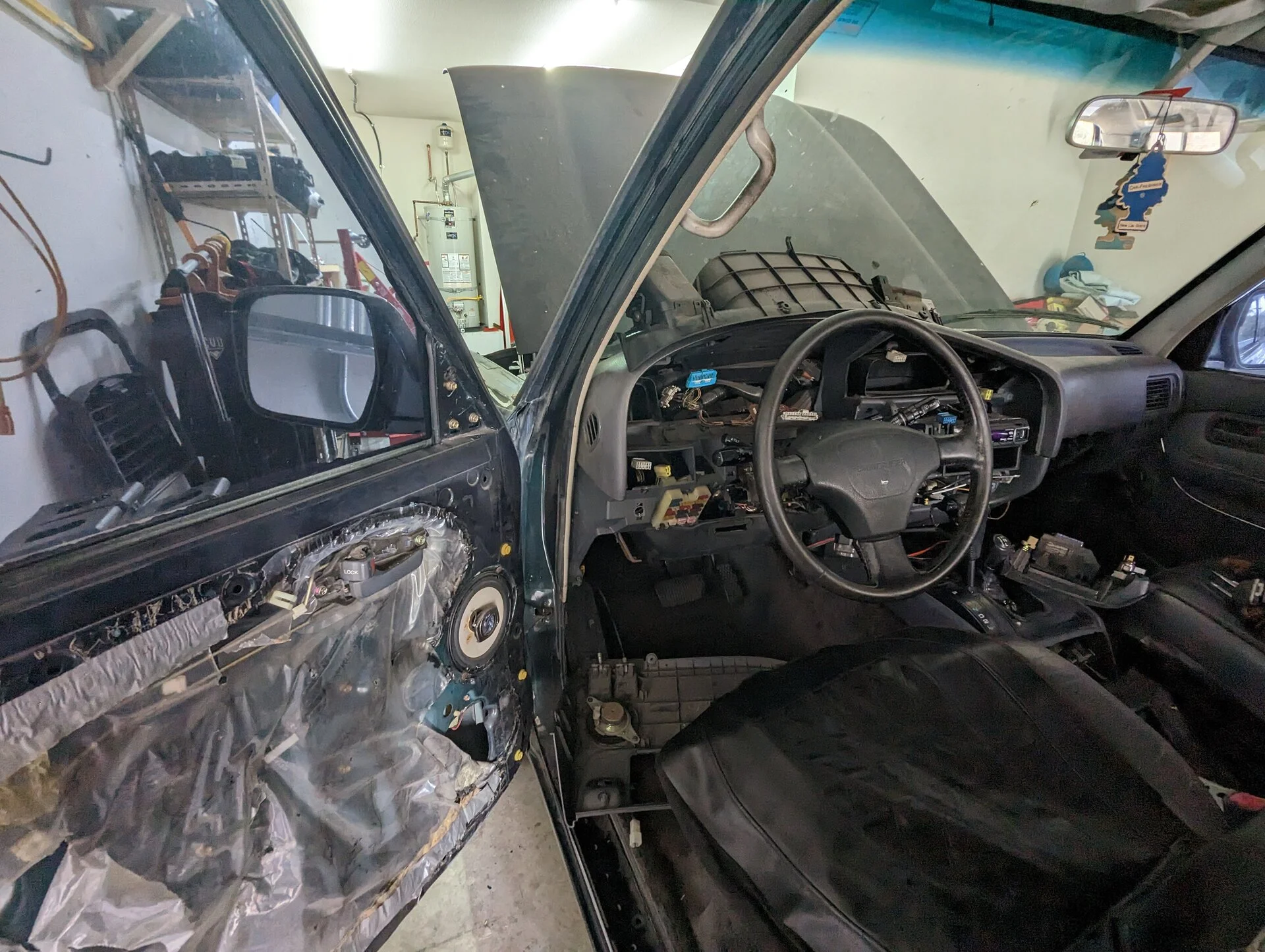

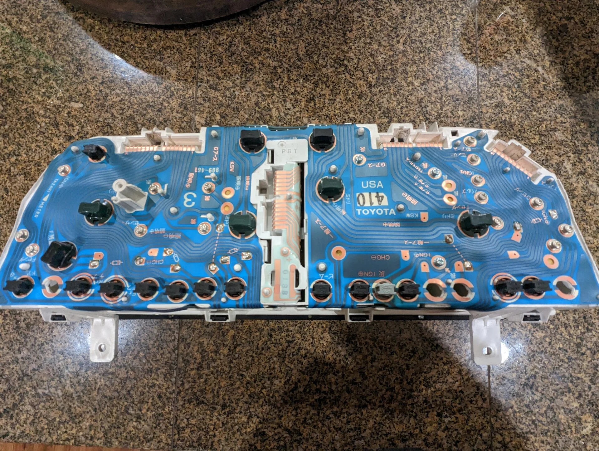

Dash and door apart and all cylinders removed to get rekeyed tomorrow. Also replacing bulbs and removing abs bulb for the delete I did.
Some really good videos on YouTube for dash removal. Not as hard as I thought it would be..... Especially when you're missing like 50% of the screws lol.

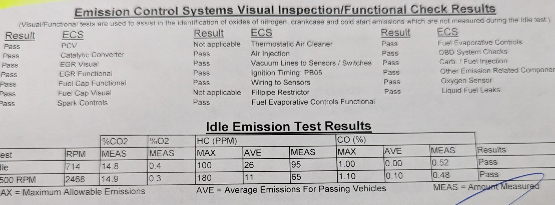

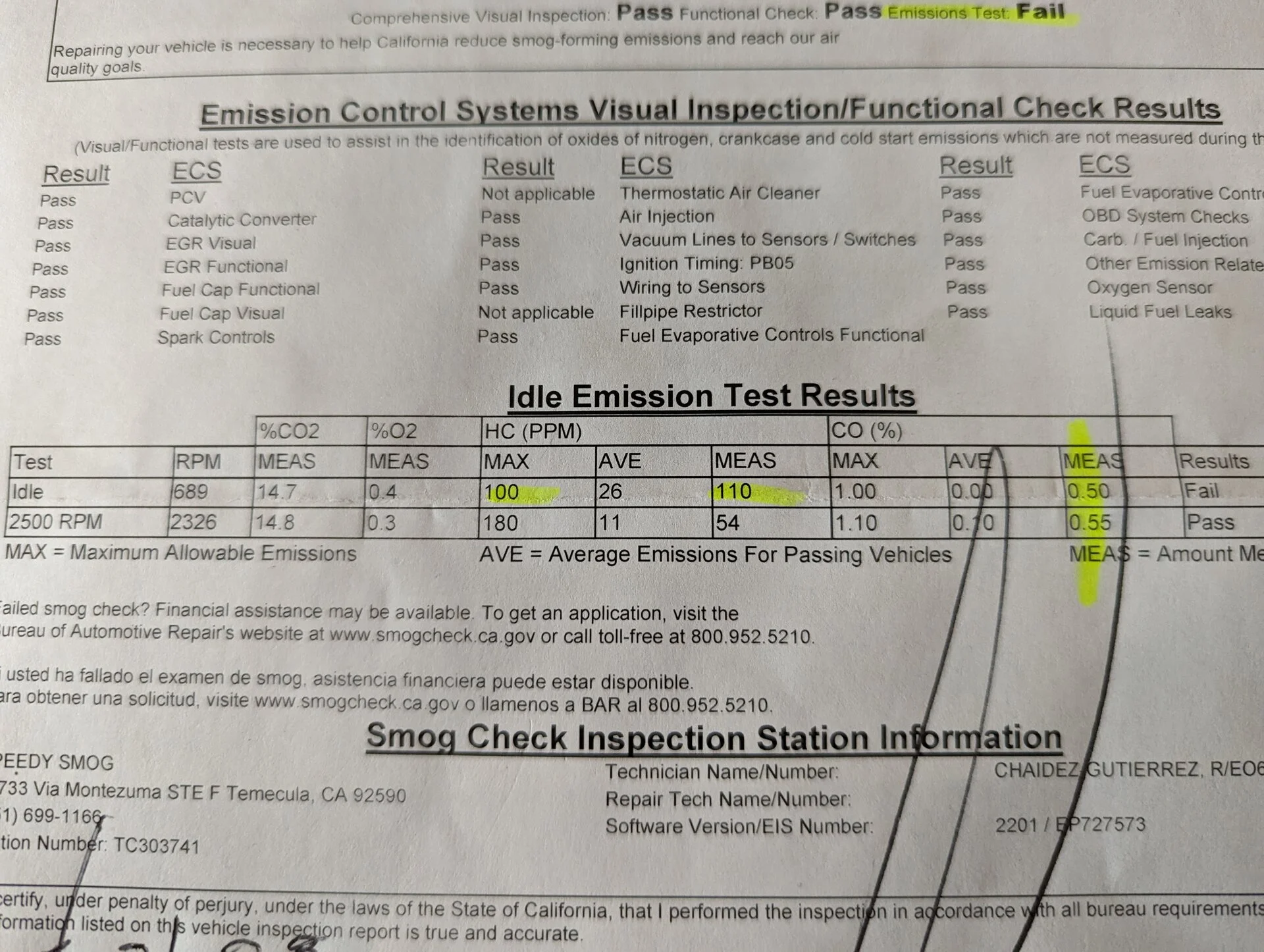

Failed smog today though. Just barely. Considering everything is new I'm gonna recheck the timing, new air filter and make sure all my other hoses are tight.
Tightened an air intake clamp and added a little e85 and squeaked by.

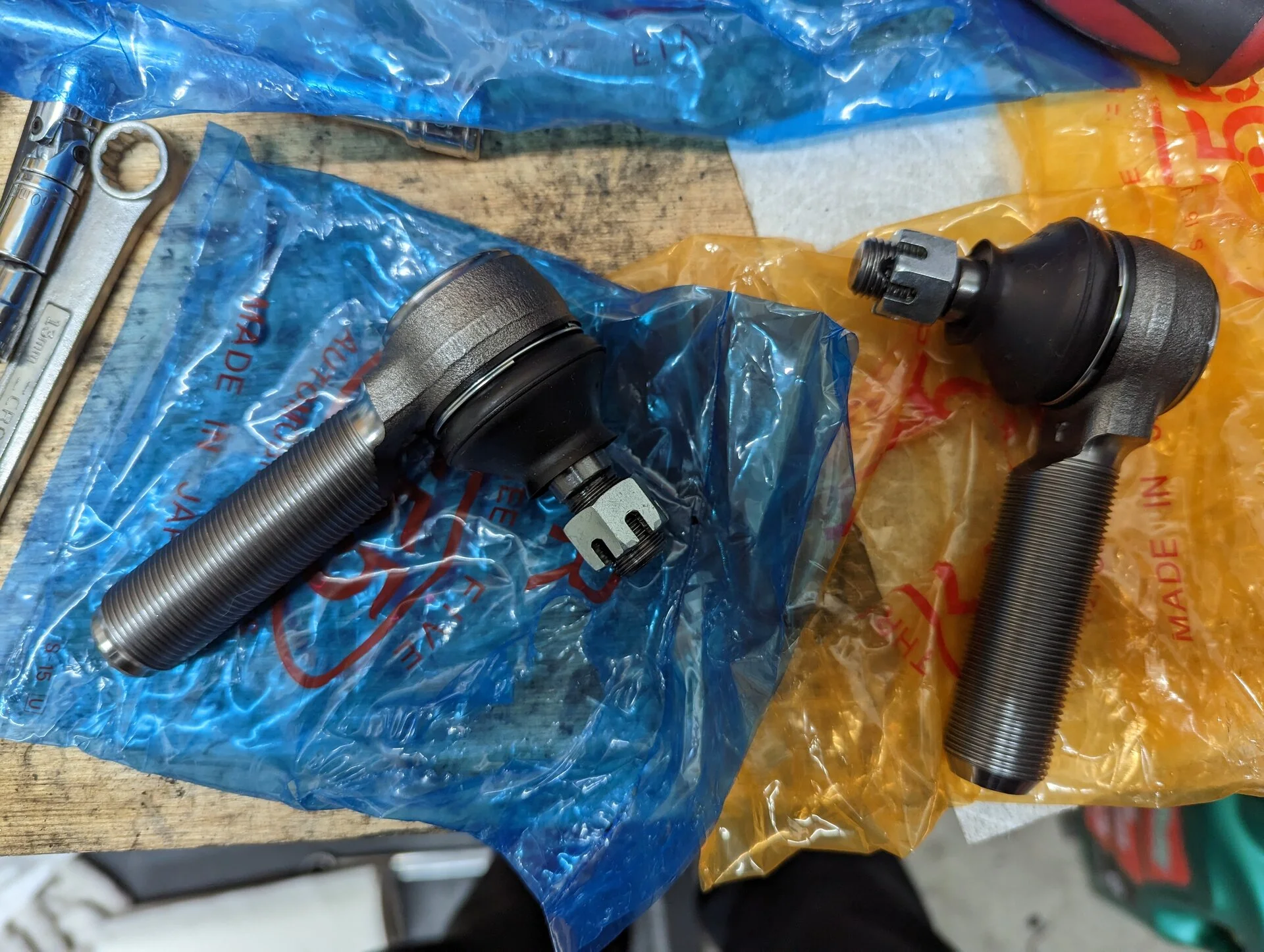

New tie rods and steering stabilizer today. Pretty straight forward and easy job. Tons of YouTube videos if you've never done it. Only one tie rod was stuck and required some torch to get moving.
