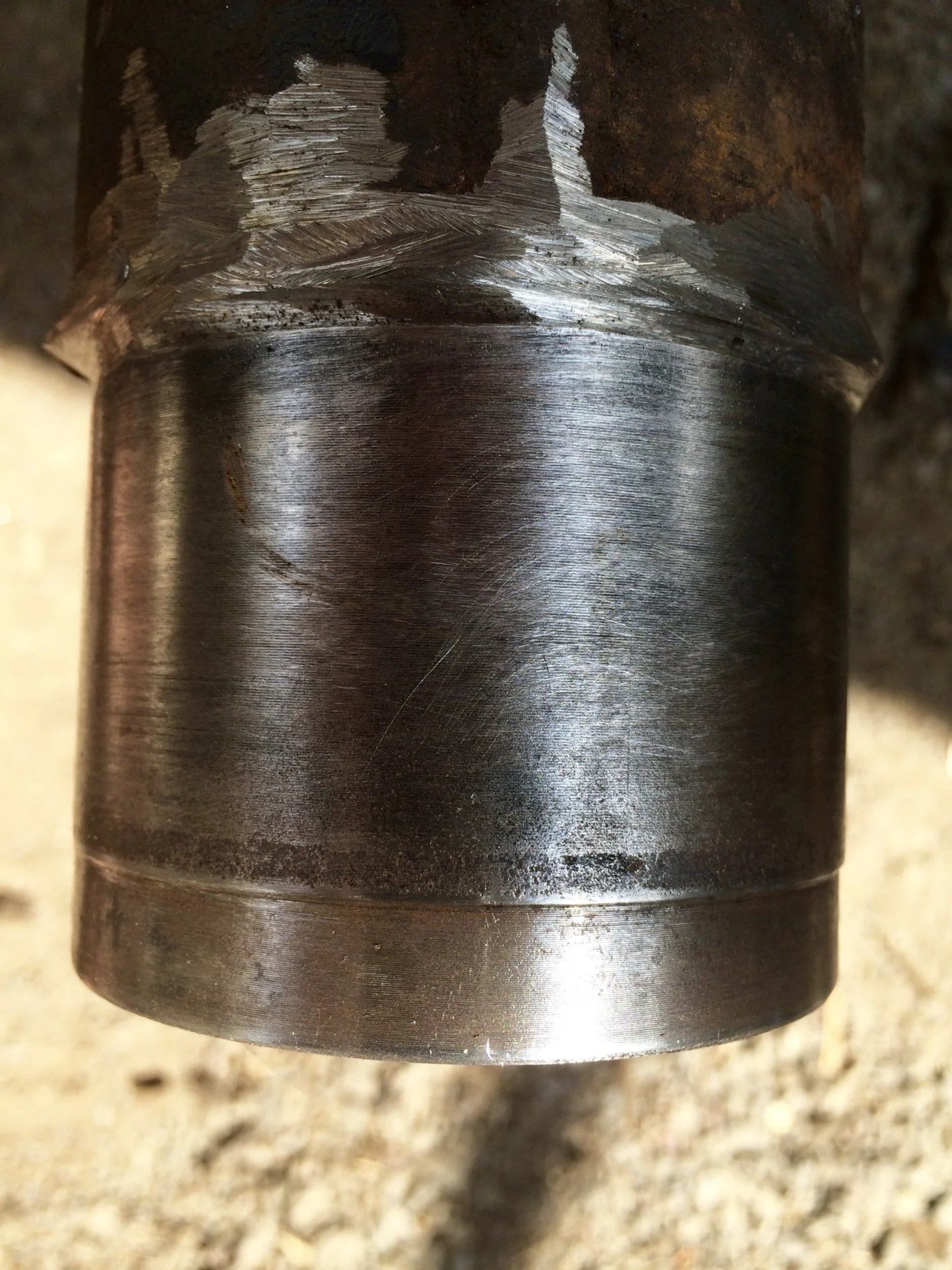

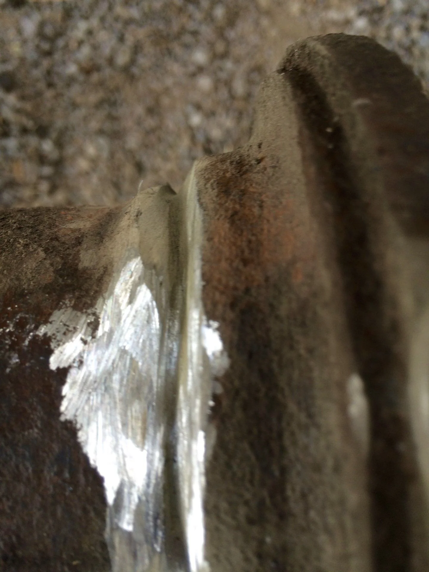

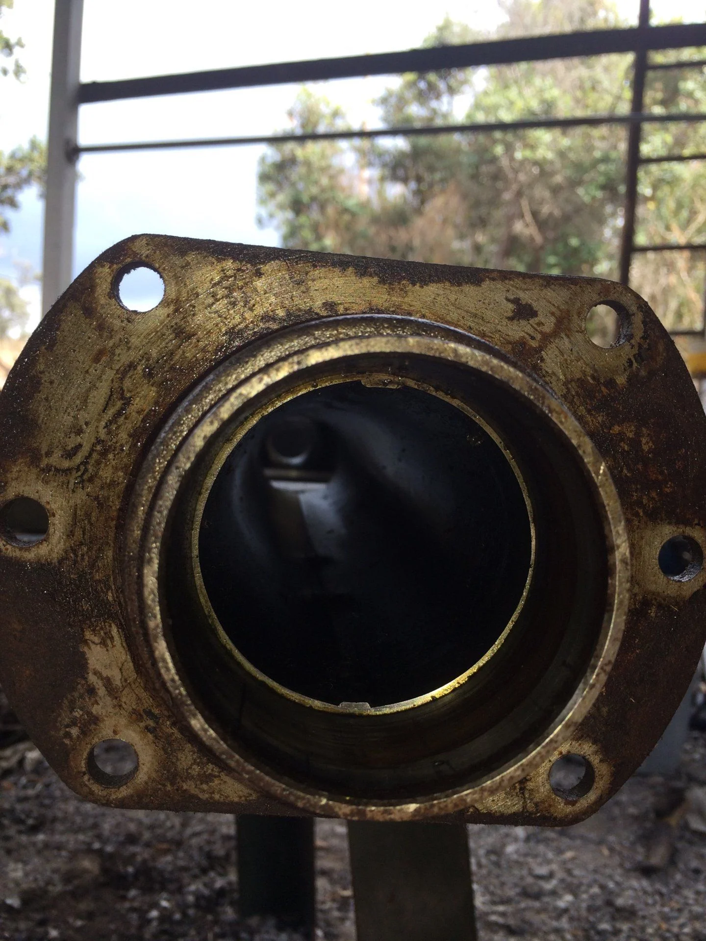

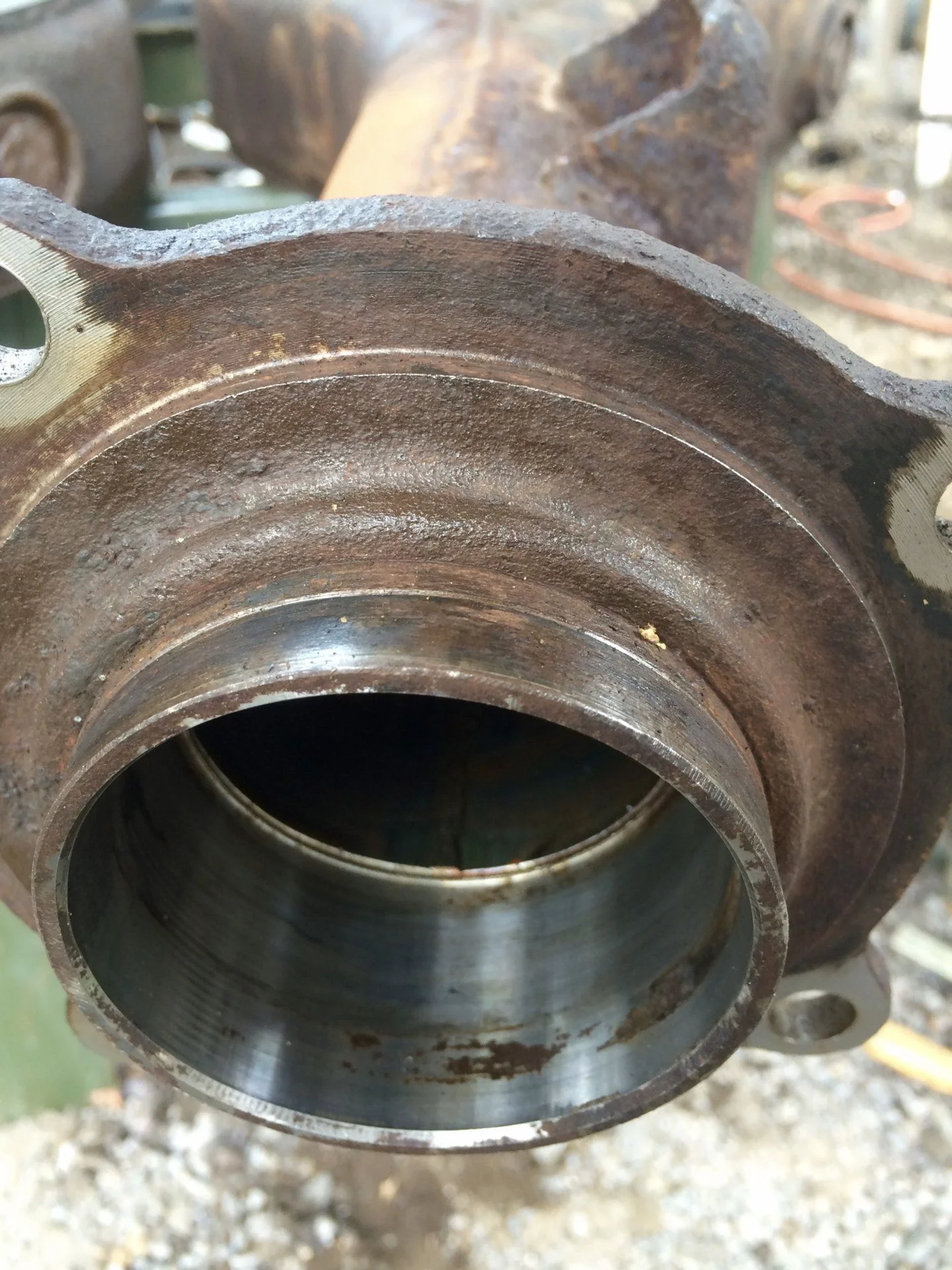

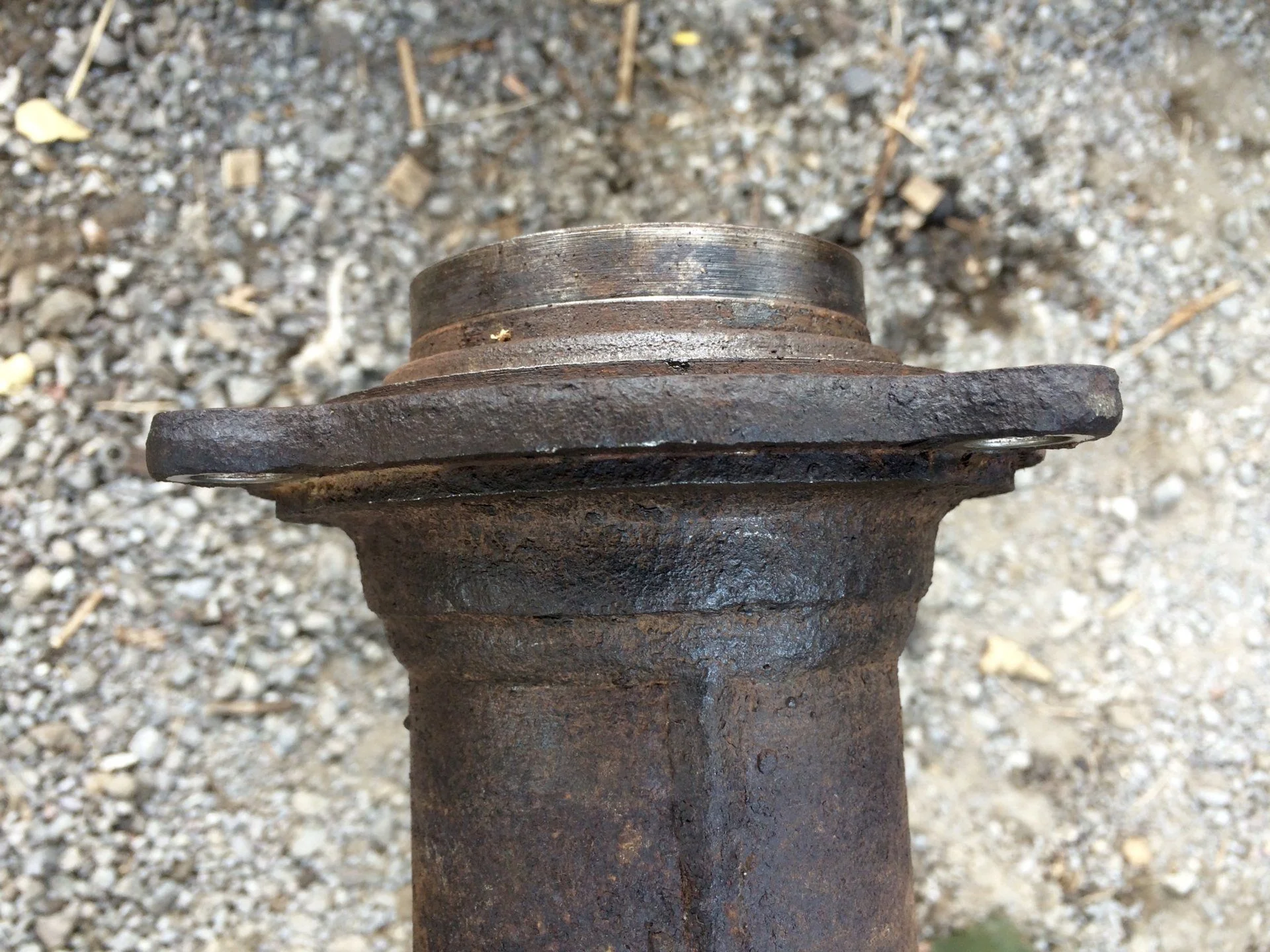

Well the flange ends of zan FJ60 rear axle. The FJ40 is basically the same but shaped a little differently, but you remove them the same & they end up the same after flange is removed.
To remove the flanges use an angle grinder & cutoff blade to cut through the welds on both sides of the flanges.
I found using a propane torch helped out. Just use a snog ol hammer & pound around the ears of flange & it will eventually slide off. May have to check & see that the weld is cut all the way through. If you go a bit to deep it’s wont be a problem, but better to avoid it as much as possible.
That gives a machined surface on each end of housing that is uniform and aligned with each other on both the outside and inside of tube to work from.

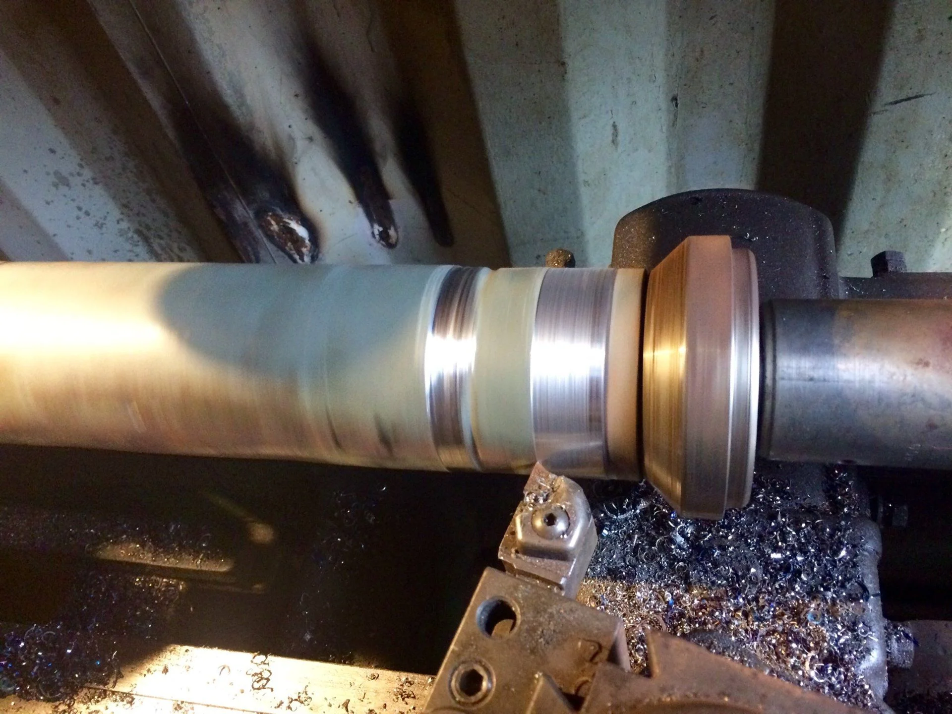

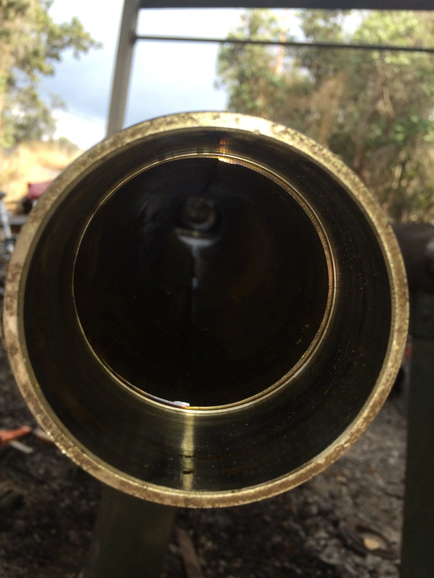

Then chucked it in an old 1920s lathe and indexed off the machined inside surfaces to extend the factory machined
Outer sections inboard as needed, so when trimming the housing to the length on each side a bit, there was enough machined length to fit the sleeves over.
Which results in this.
I didn’t bother to even the length of the machined section to match on each side.

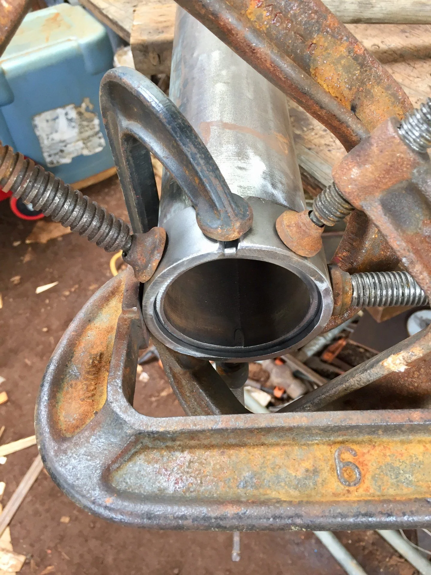

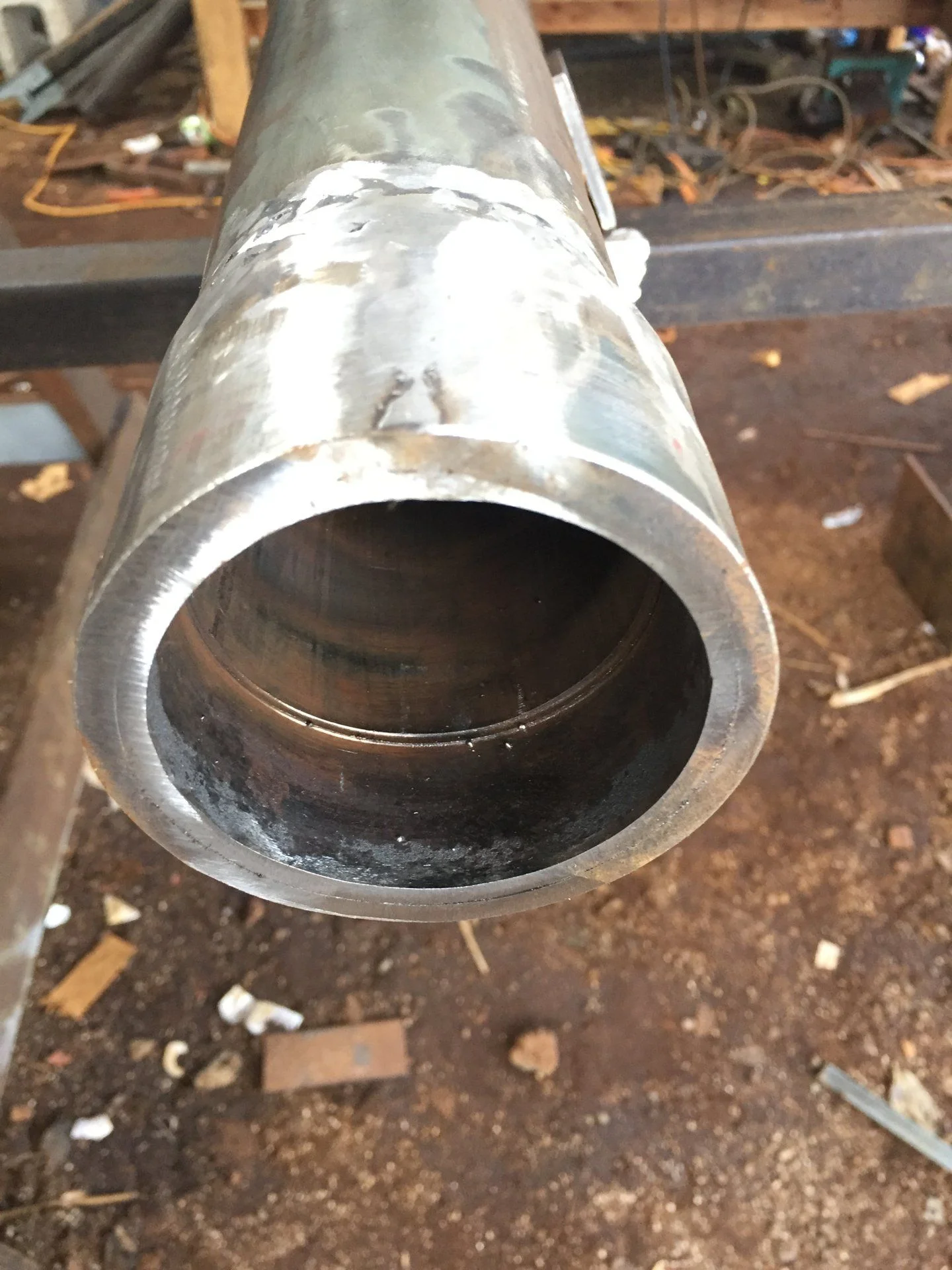

I started with a piece of 3” Schedule 40 pipe and cut it to length using my trusty angle grinder & cutoff blade.
It had a slightly loose fit over the finished ends, as anticipated.
I cut a small section, a bit less than ¼” wide to be able to fit them tight to the ends.
I did this using my high tech Island technology to press it down tight and evenly around the tube, and to hold it in place for welding.
I used heavy tacks all around it & in the seam.

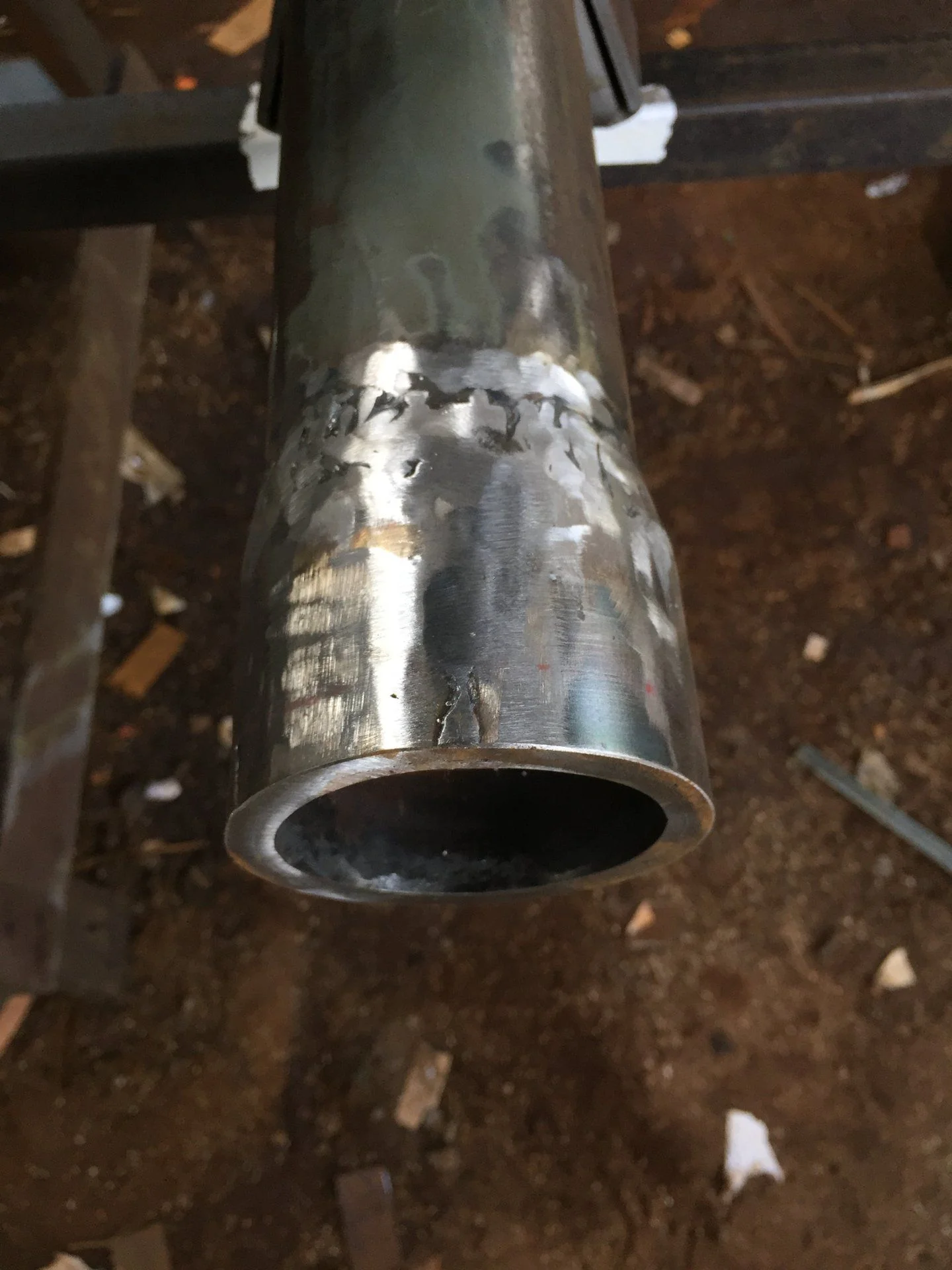

Then welded them up. I didn’t want to have a sharp step down from the thicker sleeves to the thinner tube.
So I welded them all around, came back and ground the welds a bit to clean and smooth them up and made multiple passes around it to build up a tapered fillet transition.

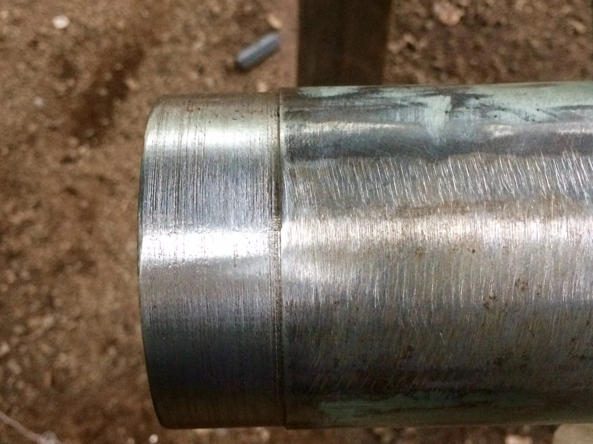

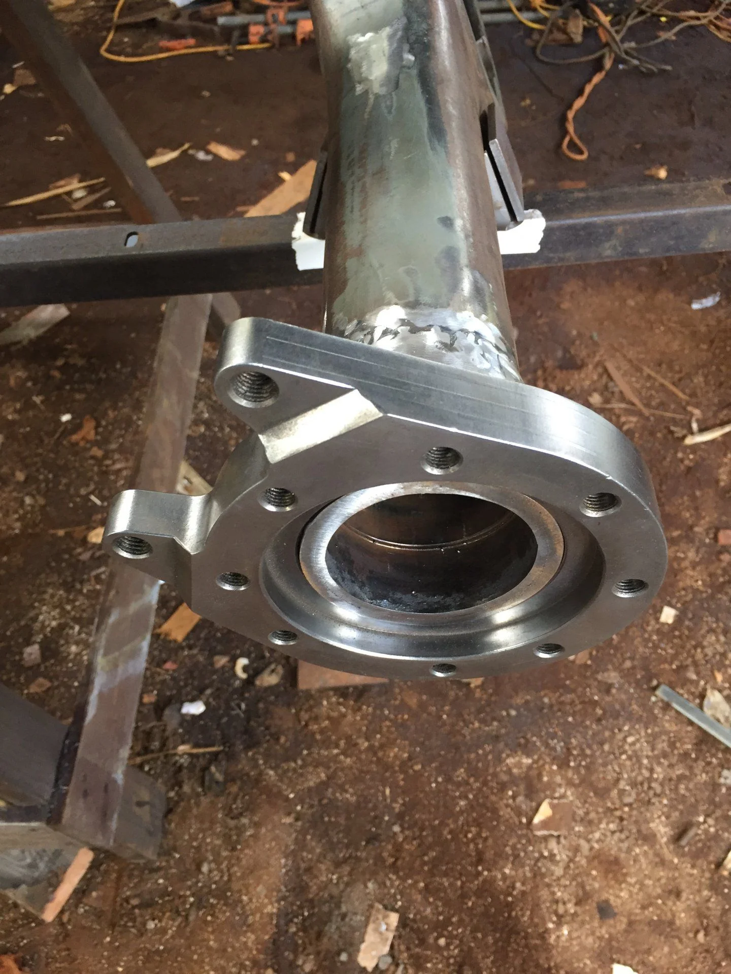

The sleeves add back material that was removed from the tubes on the inside the factory machined (I think it’s so s housing can be used for the front or rear possibly, I don’t see any use or need for it on a rear housing) it comes out right to 3.5” so a pair of Ruff Stuff Disc/FF flanges fit right on and are easy to line up.
More about lining up the flanges for final fitting to come. :-)
The little nun of weld bead is there on one side to tighten the fit slightly for initial alignment.
I left the ends slightly long and ground them to final length. But when doing so removed good bit of the weld of the ends of the tubes and sleeves.
Not a problem because when the flange is welded in place all three, the tube, the sleeve and the flange will be welded together on that face.
So the welds aren’t as boogery as the look. Lol

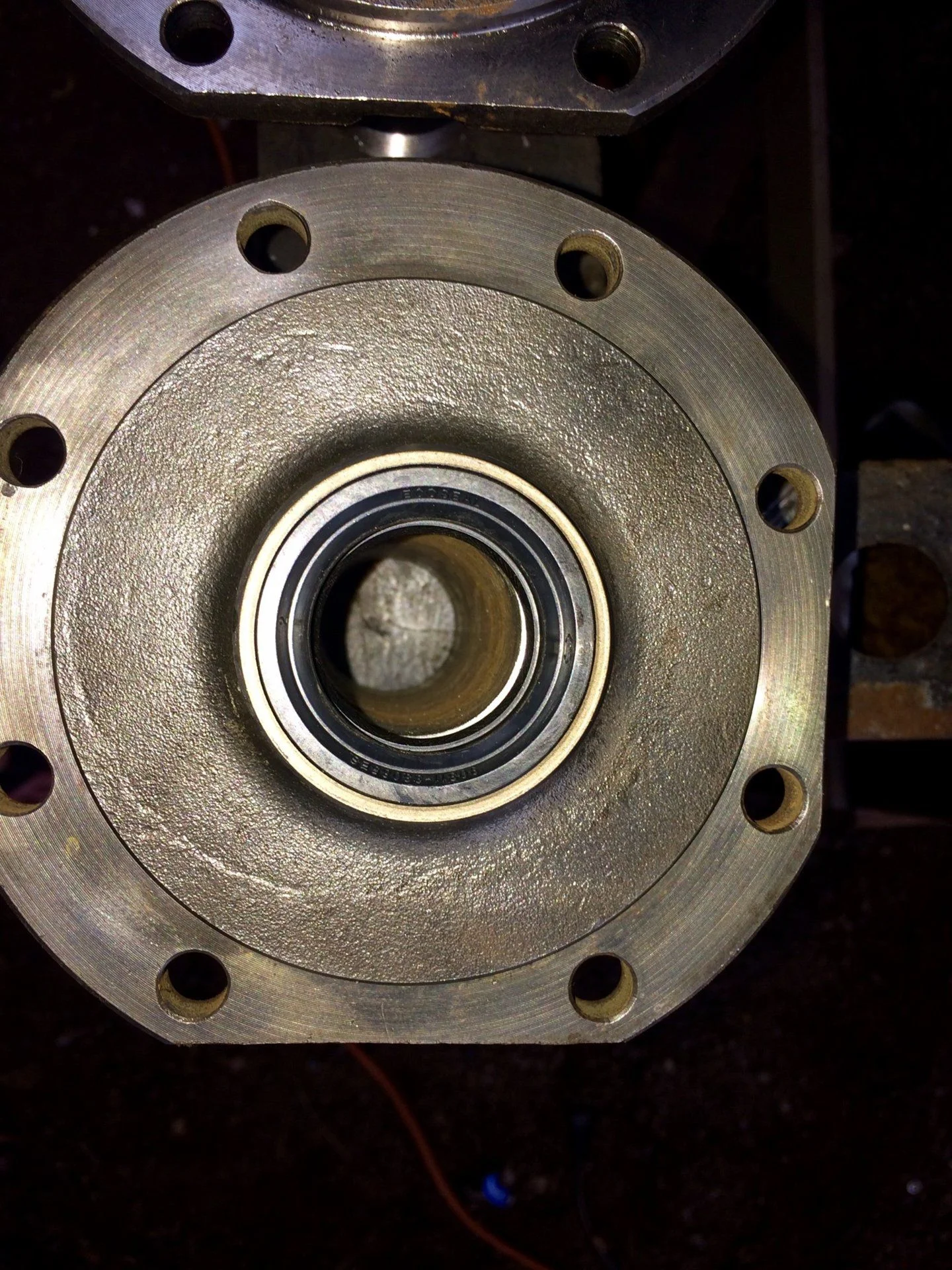

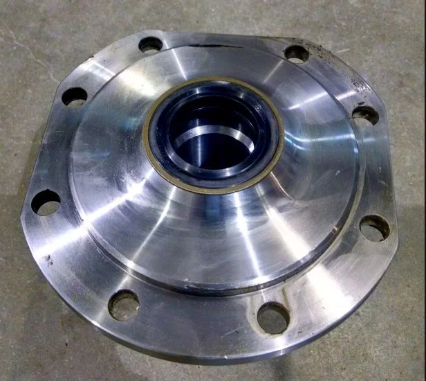

This is s picture of J Mack’s chromoly spindle with the eco seal in place.
A picture of one of my spindles with the pocket machined out,
And one of mine with the Eco Seal set in place.
Just a close up of spindle & Eco Seal.
