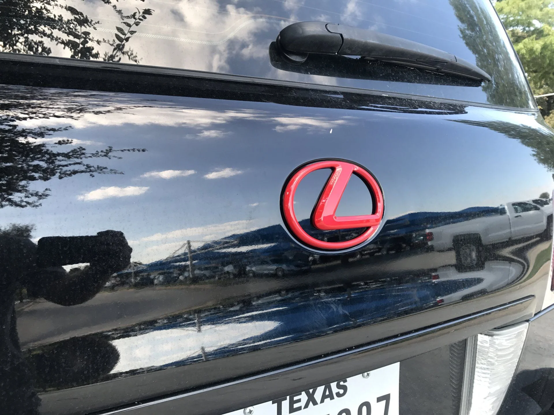

Painted the emblems tonight after work.
Anyone want to guess what color?

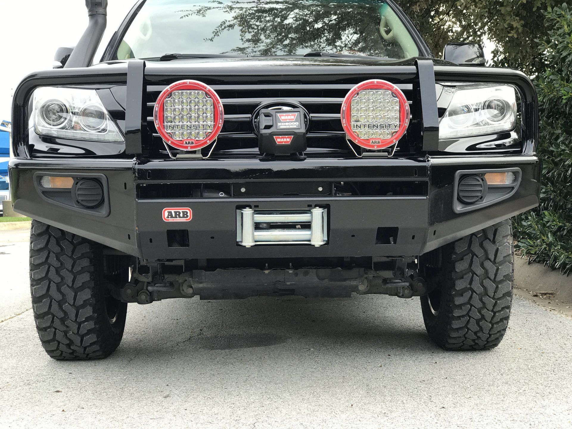

Up next is putting the rear bumper cover on, rhino line the lower face of the front and rear ARB bull bars, clear tail lights used on the supercharged LX, replace the anemic Levinson sub that broke in the collision with something more punchy and juvenile, finish installing the interior, replace the LX springs with LC springs, evaluate ride height and decide how much lift to go with, Magnuson TVS, led undercarriage lighting,... I think I'm forgetting stuff
Simply awesome build! I had been wanting to do the full bull bar on my LX570 and so far had only seen photos of people using the hoop-less Sahara bars. Really looks fantastic on the LX! I am very curious to hear your results with the LC springs and how it all behaves with the AHC system. My excitement is far from contained :bounce:

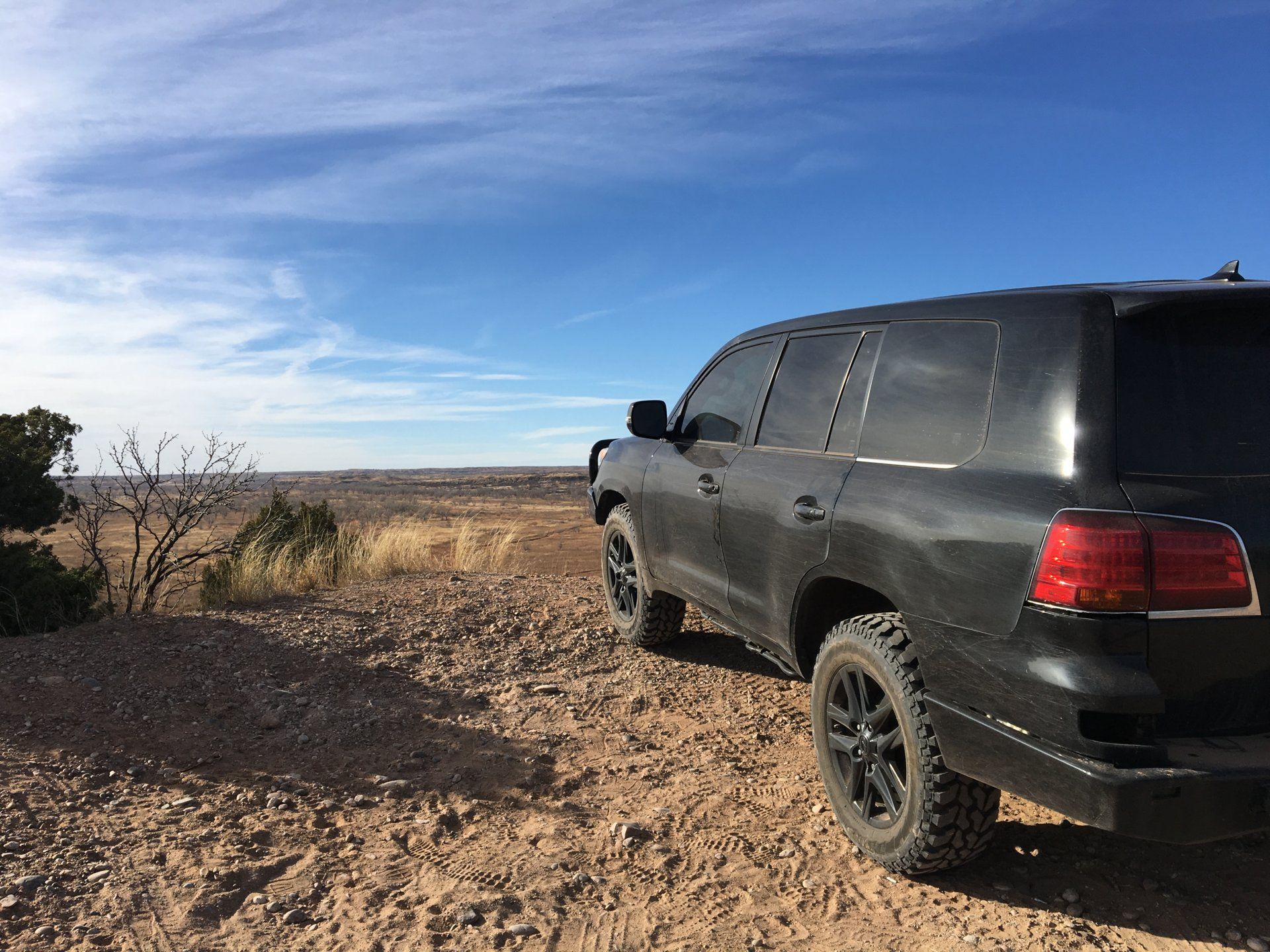

We stretched her legs a couple times since my last update. When the trails get nasty, the 200 definitely has some quirks that the 100 didn’t.
You can feel the weight more. The 100 always felt agile and the 200 feels more like it’s weight. Maybe it’s the overshadowing thought of cost and how much newer it is verses the old beater 100. Could be the stiffer LC springs too.
I don’t like it automatically going to height mode when shifted to low range, that pisses me off, especially if it’s in a technical area.
The throttle mapping in low range is frustrating, especially if need more aggressive mapping. It becomes very non linear.
Atrac is more responsive in the 200, you don’t feel like your approaching differential grenadine levels of wheel spin before it works. Which is really good with heavy knobby tires.
We’ve had the LX570 off road before, but it’s a completely different truck post modifications. The more I drive it, the more it’s growing on me.

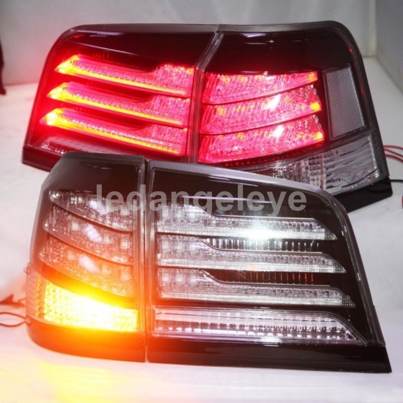

That’s the same set manufactured for the Supercharged LX570 from Middle Eastern countries. They were contracted through China and supposedly are from a Toyota vendor, but are unlicensed products, even though they were on new trucks modified through dealer networks.
Getting information from the techs on the Supercharged project was almost impossible.
But that’s the set I’ve got saved on my eBay cart. Lol
Same. ~500 to be the only LX with them in the country... lol

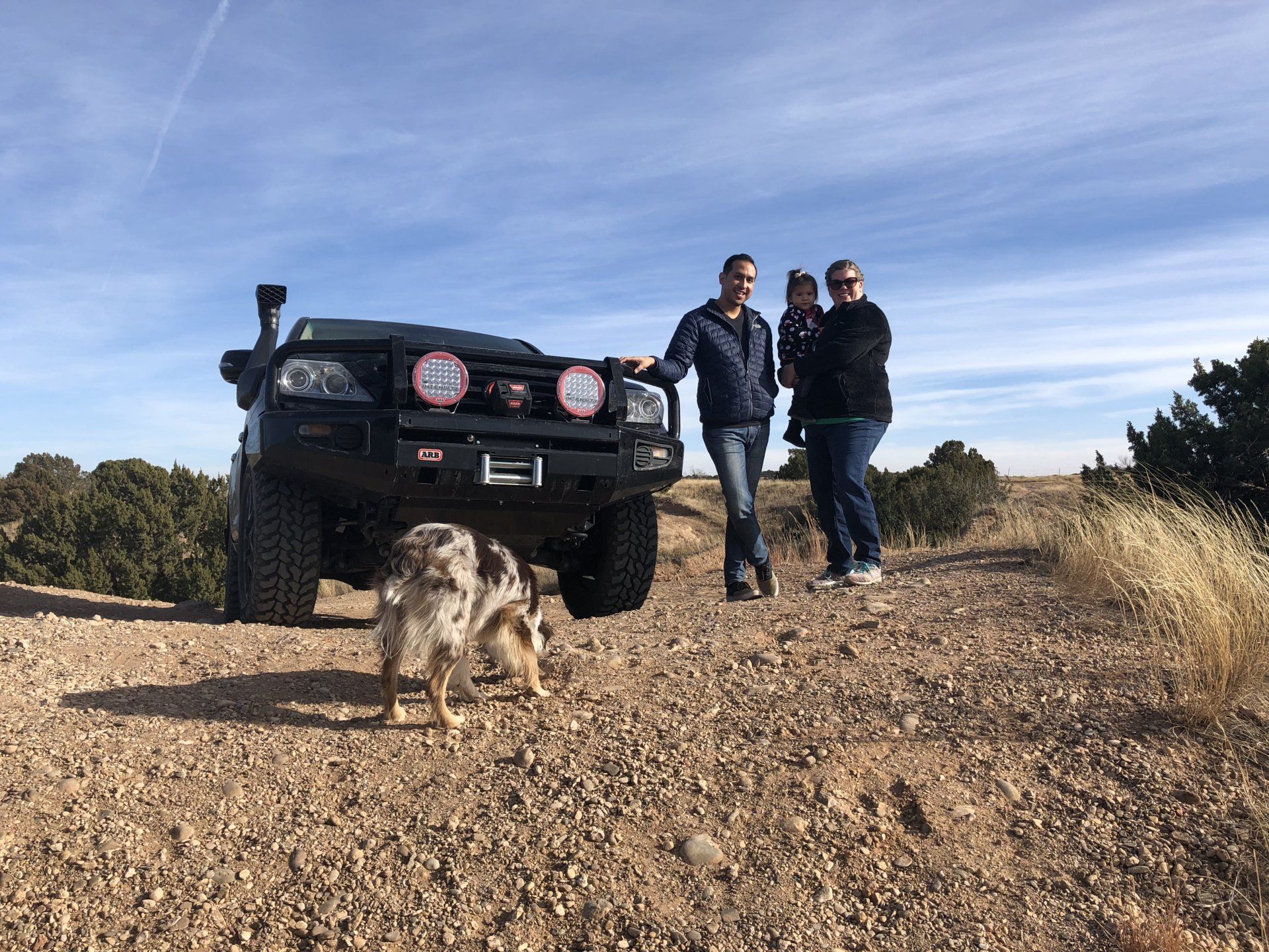

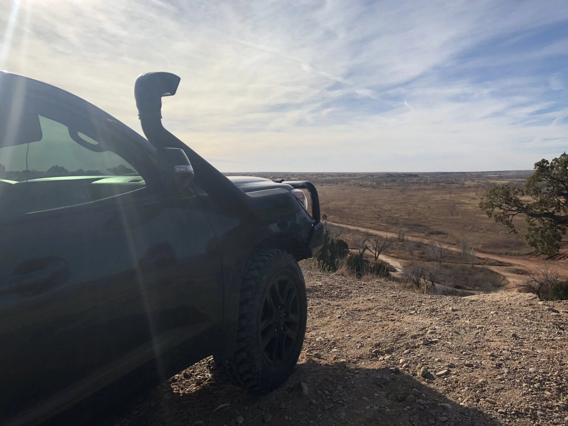

What's up with your snorkel?
905ba9a5-cb15-497a-b031-63c19a840fa2-jpeg.1622256
Isn't it supposed to be attached to the A pillar instead of free floating out in space? Was this intentional, or ... ?
