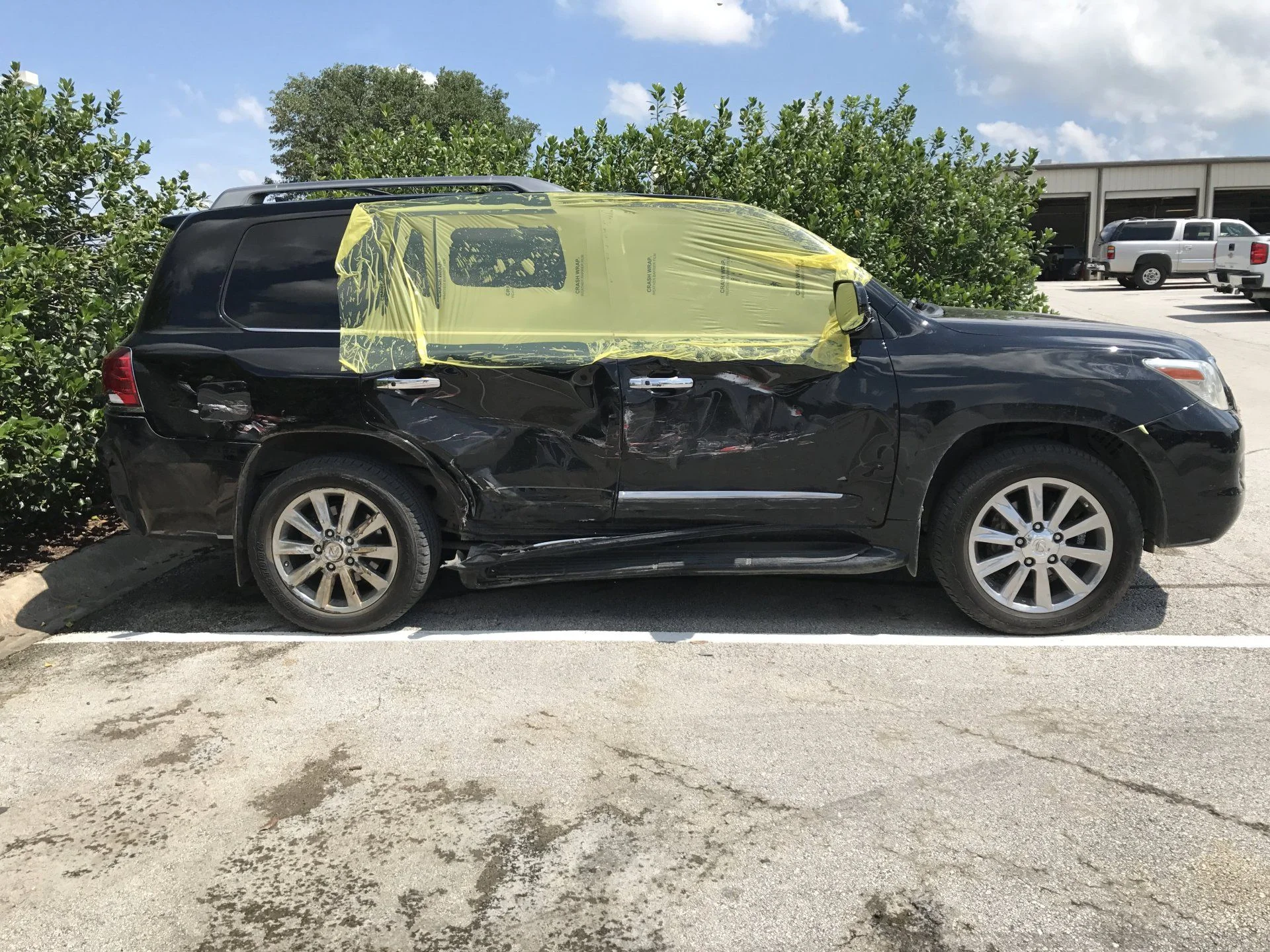

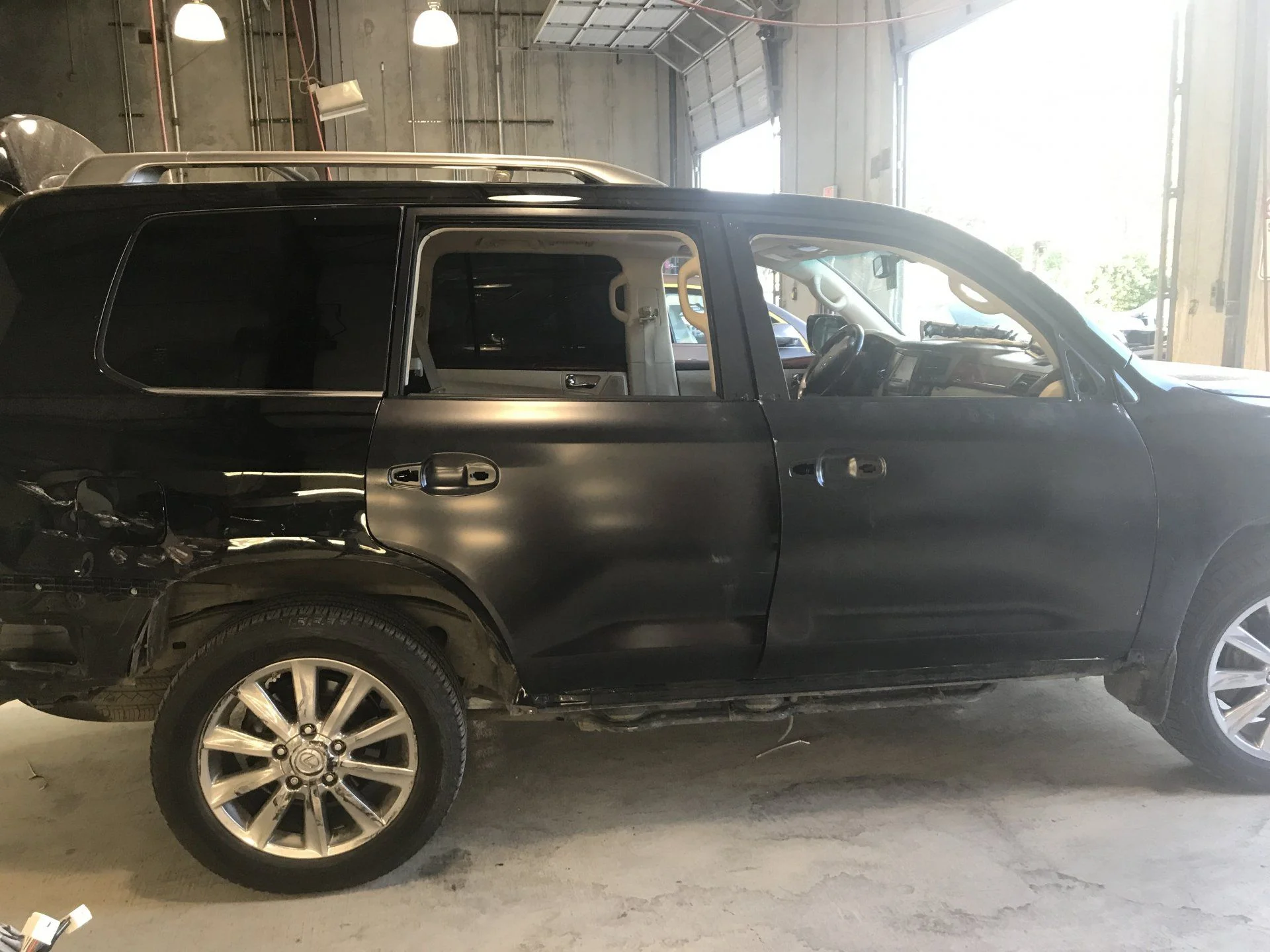

An unexpected rear-end side swipe from a fellow in a semi truck opened an opportunity to get the project rolling.

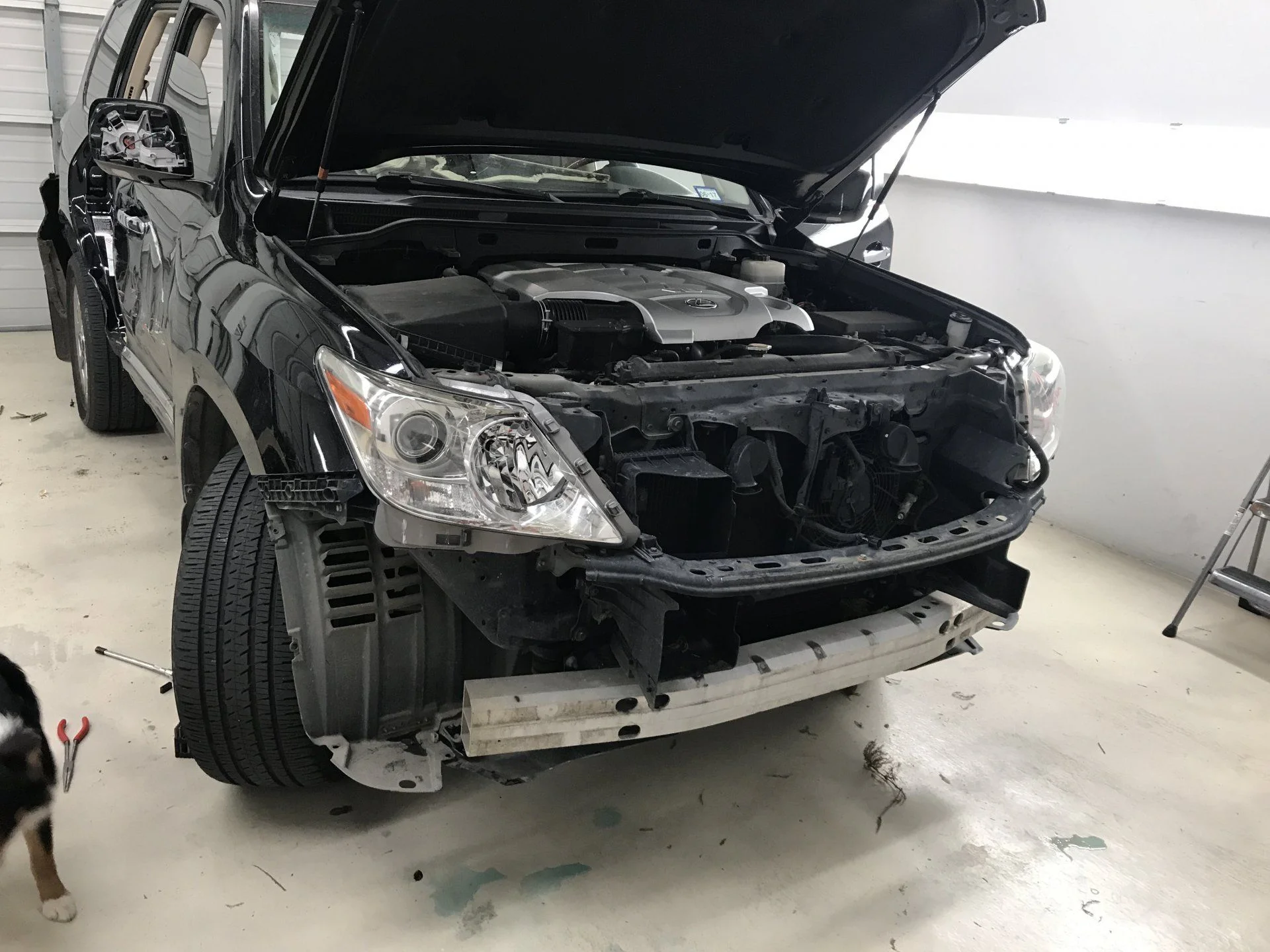

I sold the 100 and began tearing down the 200 to determine what needed to be done.

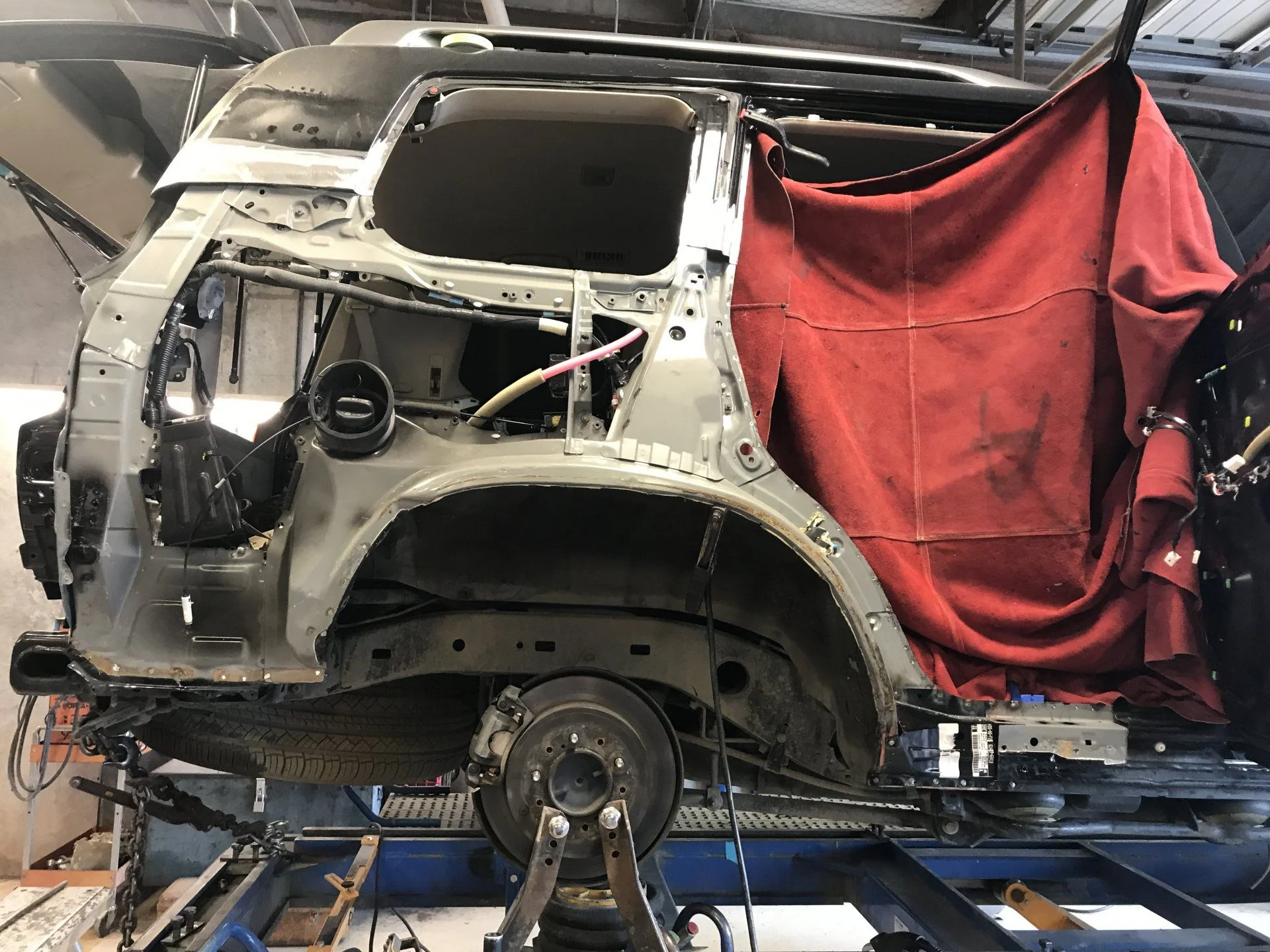

A little later I had some parts and began cutting.
New doors hung to check alignment. They even latched with ease. These trucks are tough.
Cut out the old quarter and started pulling the wheel well and door jamb support out. Holy shi*, this body is tough.

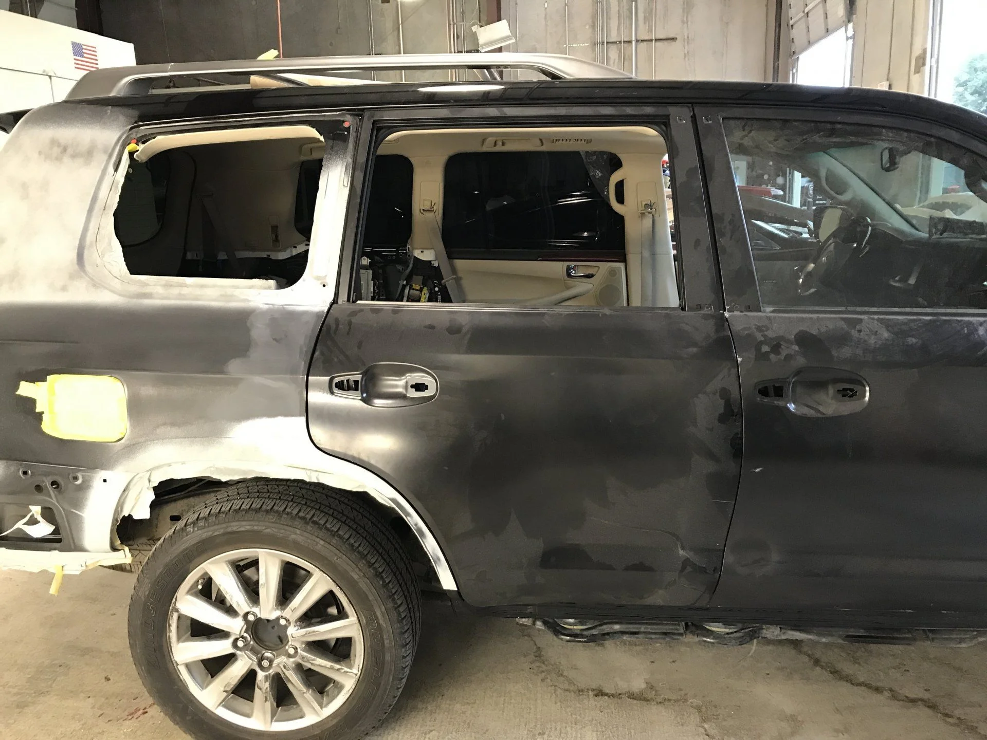

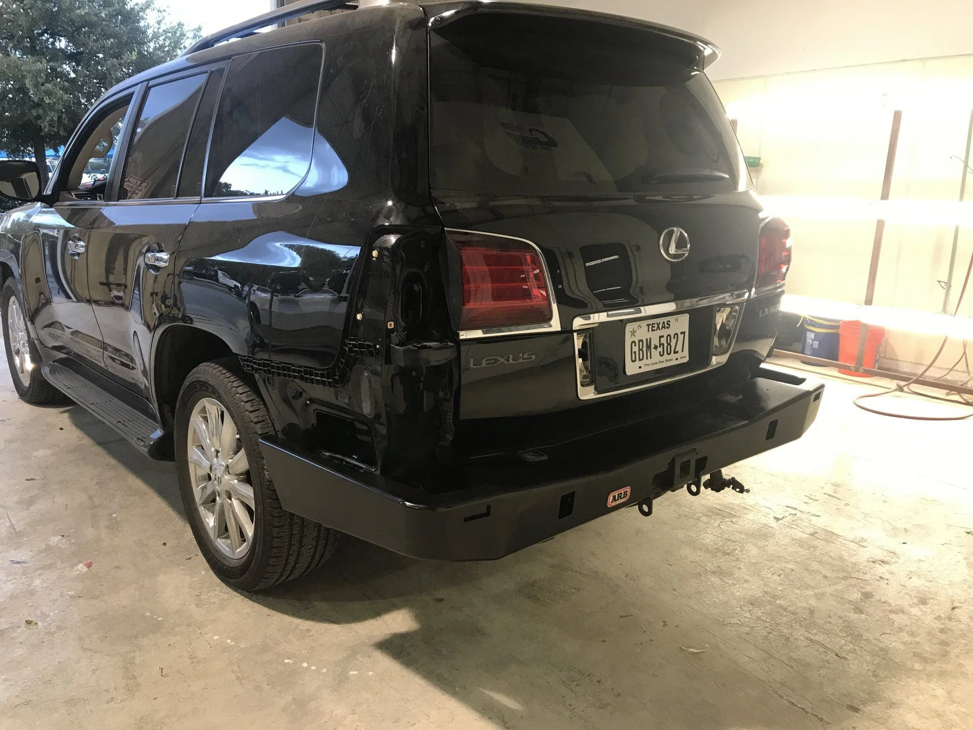

New quarter welded in and mudded up
Got the front and rear ARBs on

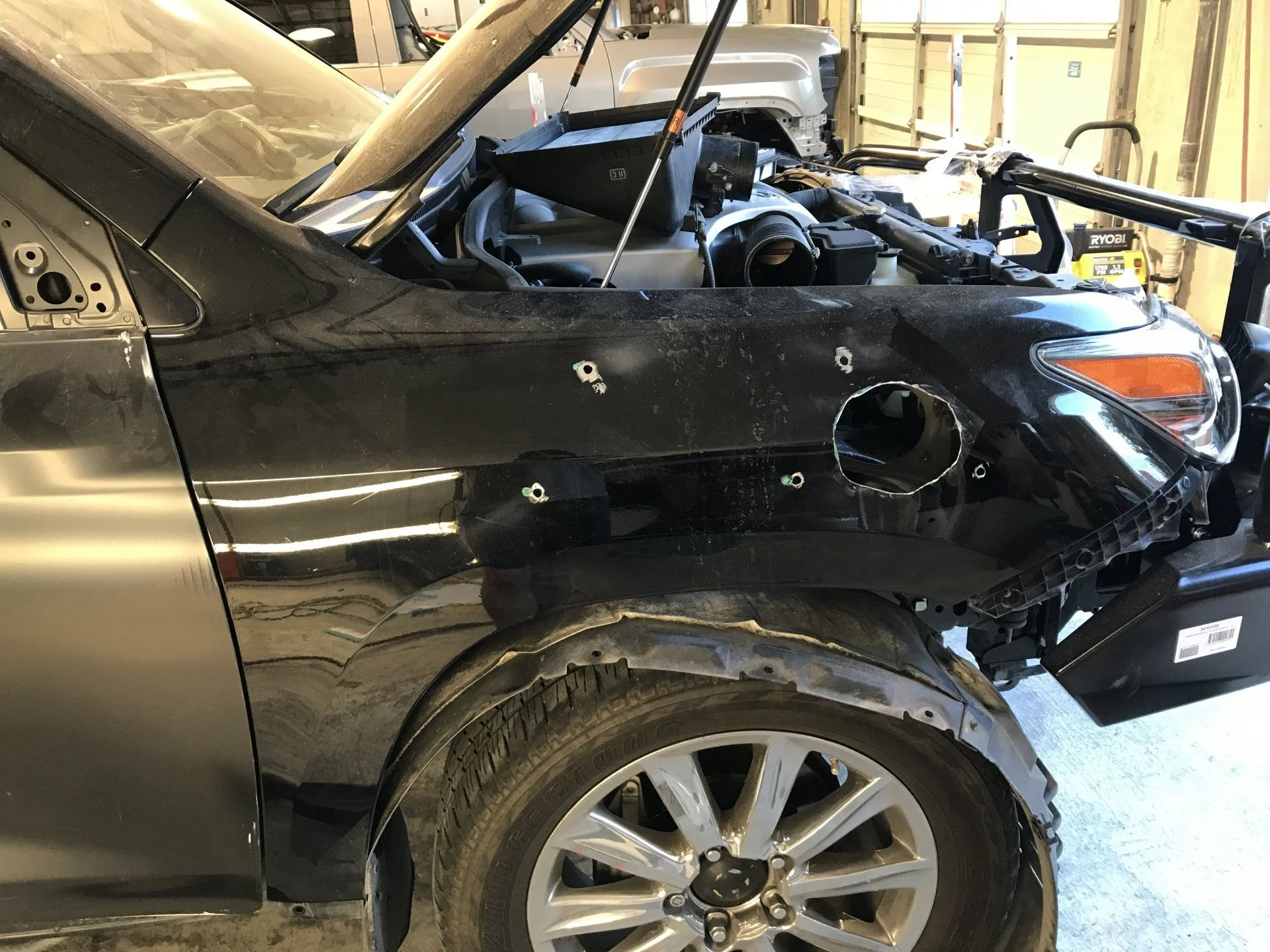

Oops, I cut a hole in the fender

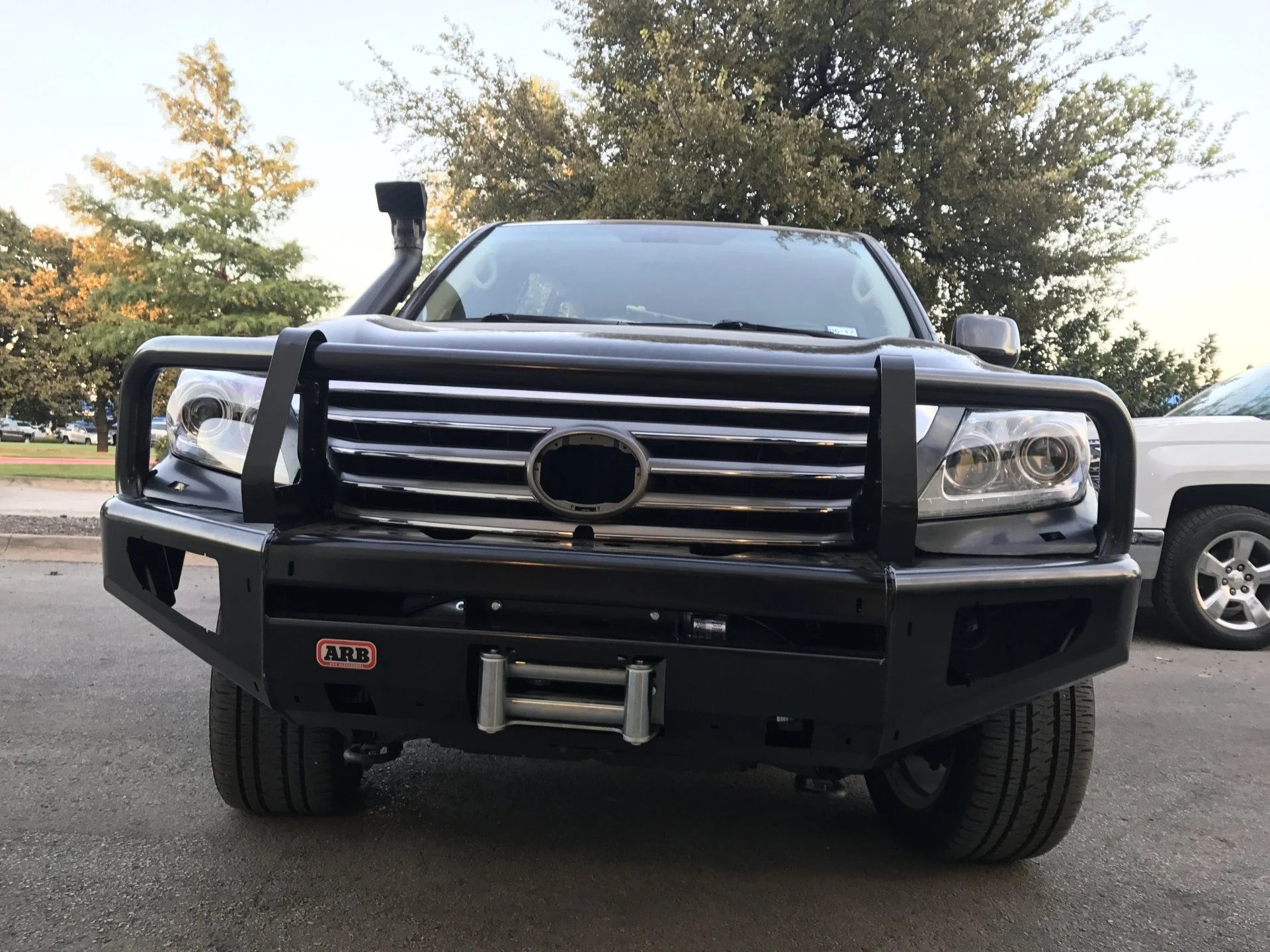

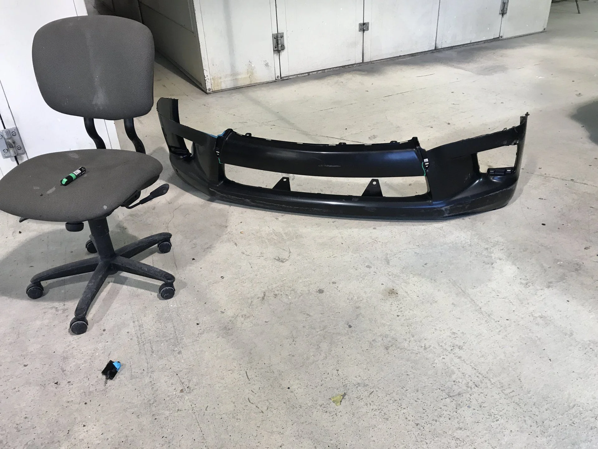

Got the hole in the fender plugged and cut a fitted the new grille and plastic bumper fascia

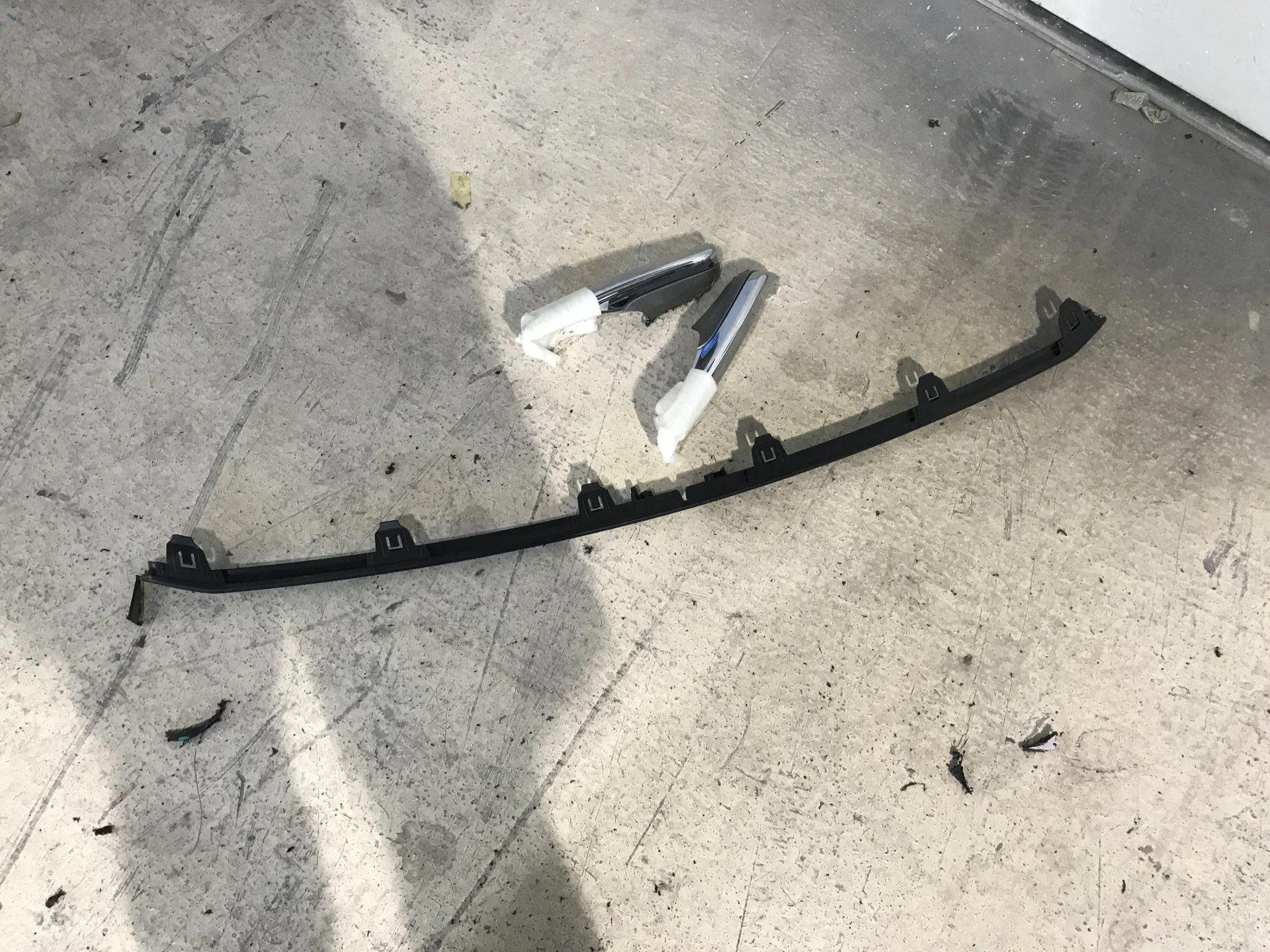

Had to buy a new bumper just to get the top two small pieces to fill a gap lol

Next up is to chrome delete, luggage rack removal, front camera relocation, paint, LC rocker covers, ARB lights, lift, black powder coated OE wheels and 35" tires, 4.88 gears, magnuson supercharger

Did the 2013 headlights bolt up to your 2011 without modifications? Or are new fenders/front bumper required?
Just bumper and grille. The supports under the headlamps going across new to be replaced if your maintaining the stock bumper. I removed all that to make way for the ARB. Everything bolts up

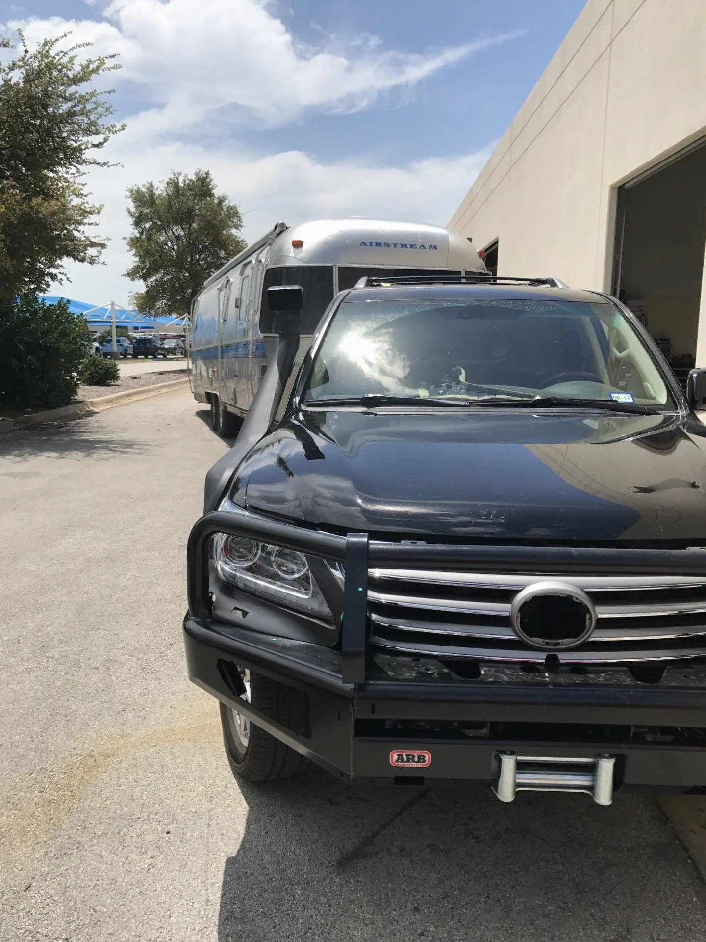

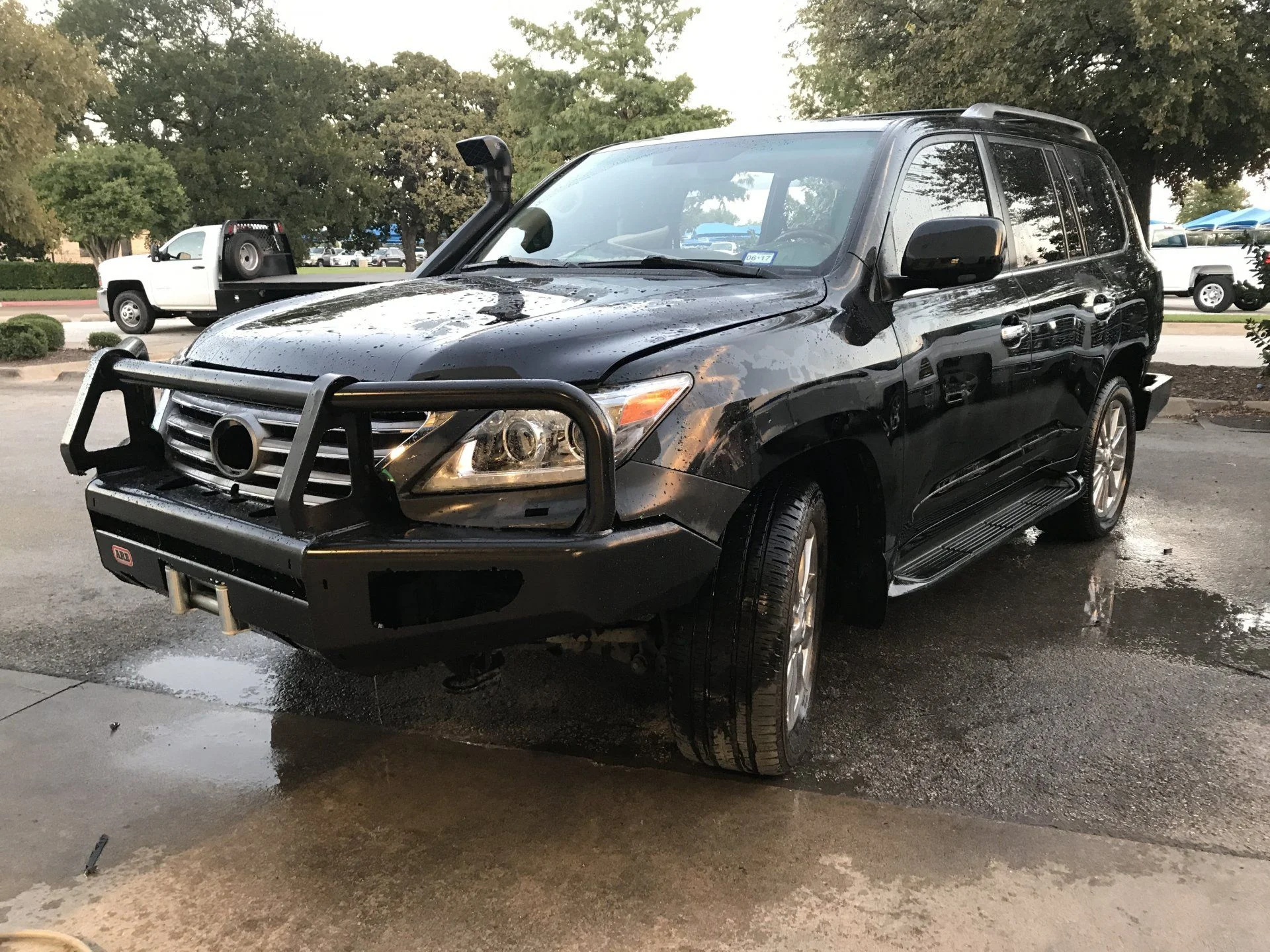

Is your snorkel not attached at the top, from the pic above with the Airstream?
That is impressive, coming from someone that can do a lick of body work. Impressed none the less.
Not yet, I need to heat the plastic and mold it a little better to the contours of the LX fender before I mount it to the A pillar.
Not much to report today, had a lot of work on my hooks today, but I did get some fresh rubber rolling under Molly.
I thought they were 35", but they are about 34.25". They are 275/65r20
At stock height they run the sway bar at full lock and the back of the front fender well liners at mid turns.
