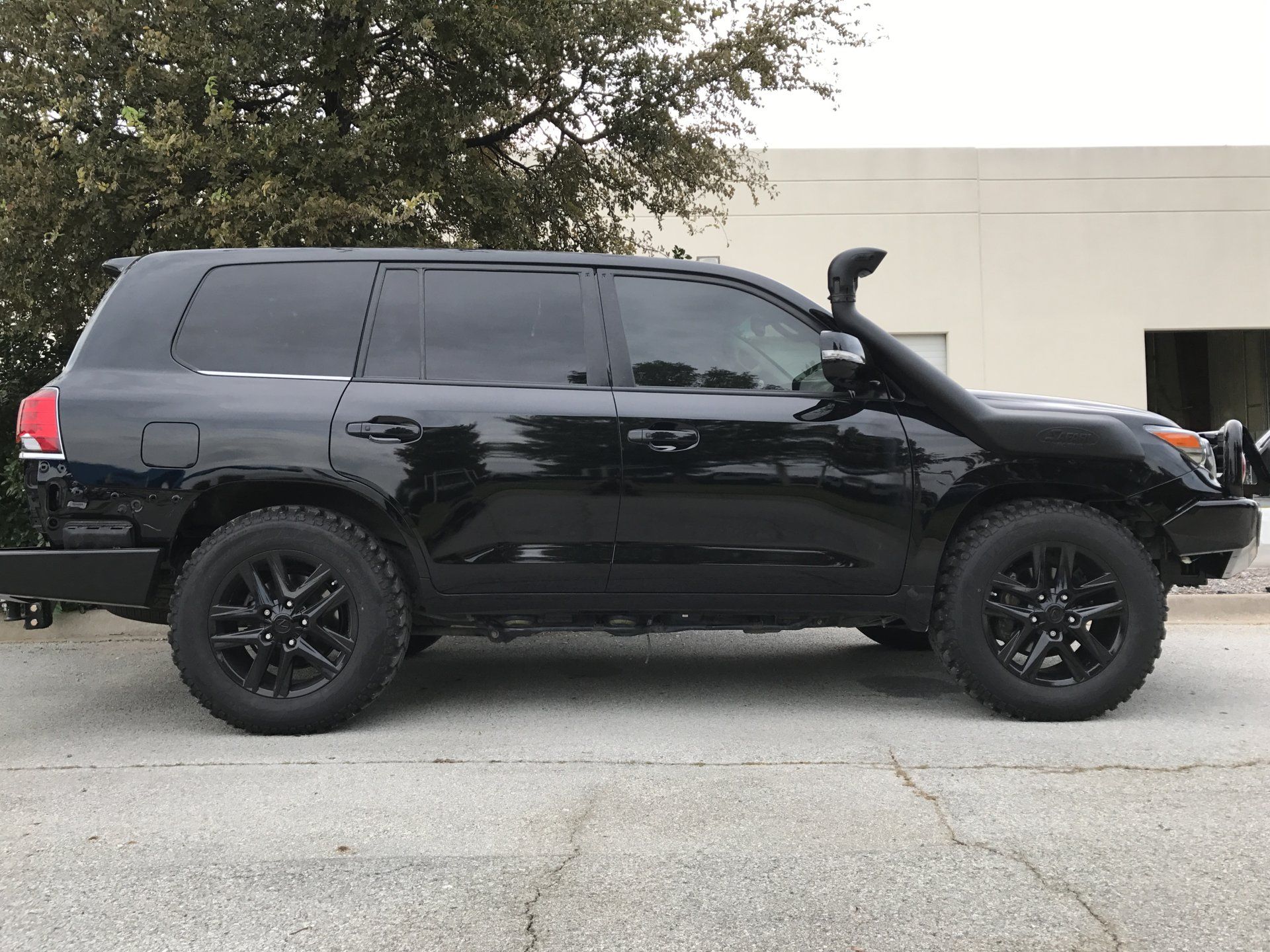

Could just be the photo or the way the wheels are turned but your front tires look like they have some serious positive camber in that photo.
Really diggin' your build.
I keep thinking the same thing, but I think it's an illusion. I'm going to check it this weekend.
Thanks

Wheels straight.

One shot of side.

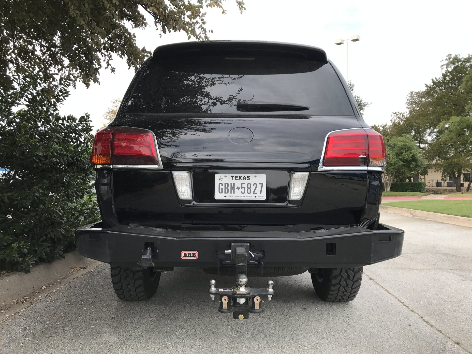

One shot of real

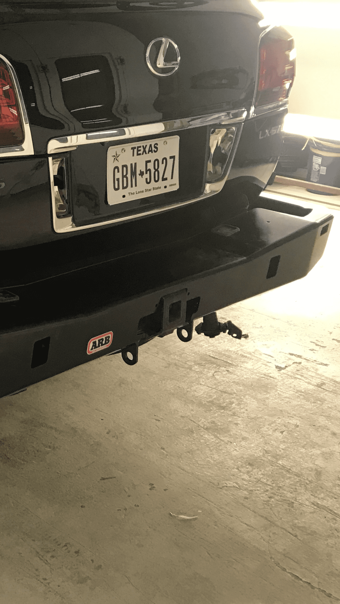

Last question
How many inches is the the most far point of rear bumper from the tail gate?

Last question
Like how far does the bumper extend rearward from the vehicle? If that is what you are asking, it is shorter than the factory cover. The rear plate of the bumper sits slightly inboard of the receiver hitch.
