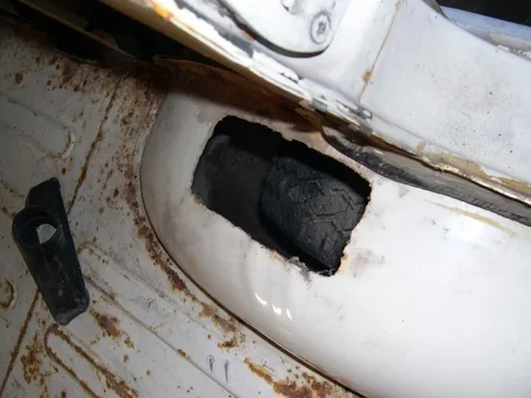

Did you use thicker gauge steel here compared the the surrounding steel?
My mounting area was completely rusted out (those aren't cuts!) and I've been contemplating the gauge I should weld in.
Thanks in advance...

The original fender sheet metal is about 18 gauge. I used 18 gauge on both the fender and the backing plate. You could use 16 gauge to add a bit more strength but it will take a bit more muscle to get it to move into shape... Considering the backing plate is only ment to stengthen the rear seat back mounting bracket and isn't used for seat belt restraint anchors IMO 18 is plenty thick / strong enough for the job. The biggest issue is really just insuring you treat the new sheet metal panels with a good heavy duty rust prevention material. Weld primer isn't a bad idea to use between new panels either....
I kinda like the hole in your fender.. It might be fun to watch the tire as someone else drives LOL...
Hope this helps and thanks again for the compliment :cheers:
