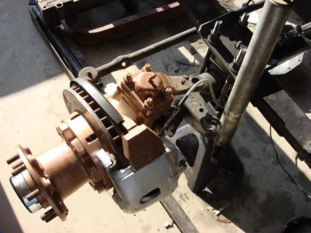

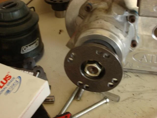

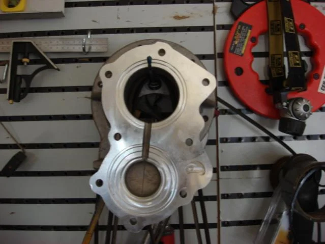

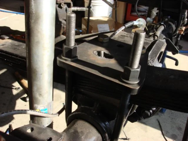

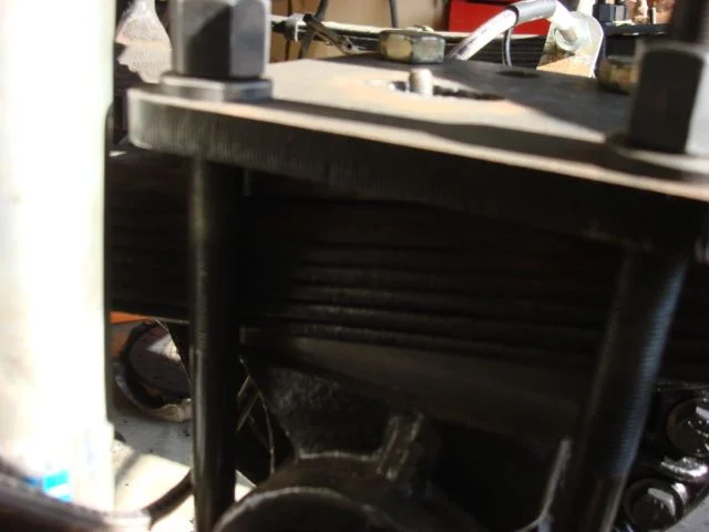

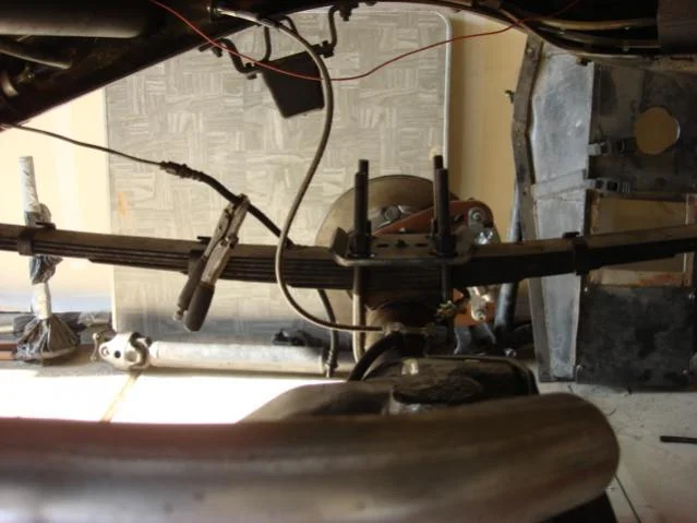

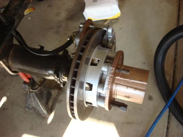

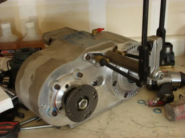

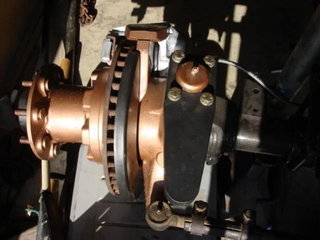

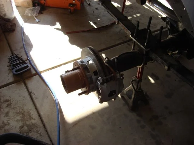

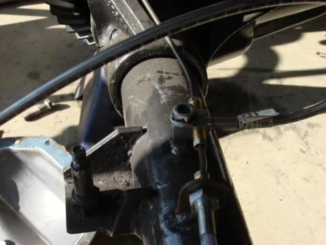

More pics tomorrow, got the adaptor for the sm465 to atlas, changes the atlas input, front brake lines done, front u bolts figured out, tranny pulled. Hopefully I will be done by the beginning of feb.
76" in the fron. The wheels are 7" backspacing so it will suck it in some. Its wide but that is what I want.

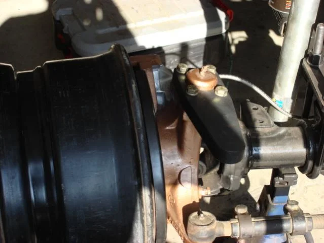

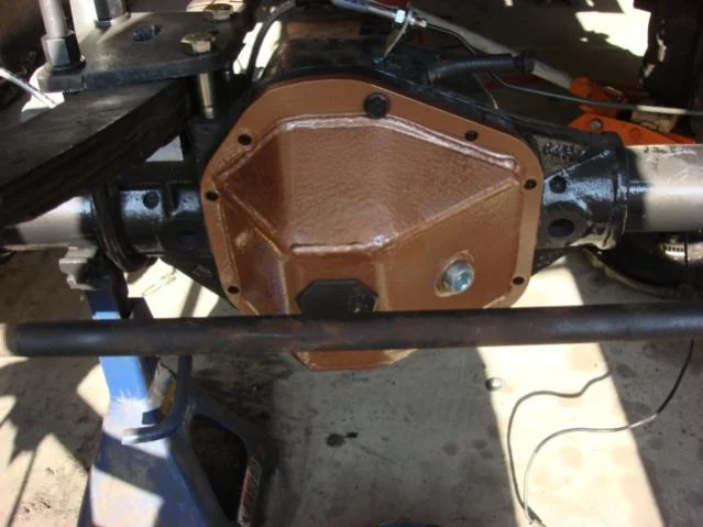

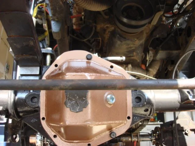

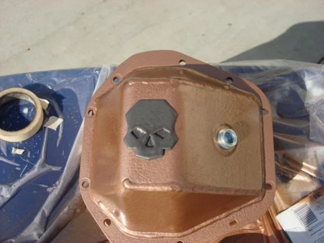

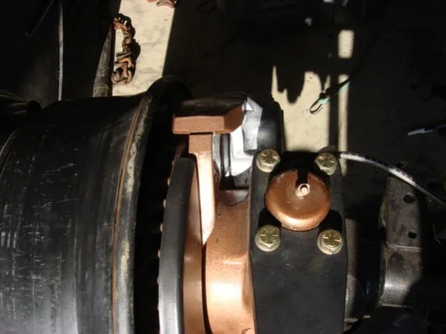

Will that hysteer arm clear the H1 rims? Any thoughts on rock rings or just run bolts instead of the protruding threads on the inner wheels? Beef up those diff cover too. Lovin the gold :hillbilly: Lookin good playa :grinpimp:
Got covers from calistic, actually taking a break from painting them up. The Hy steer will clear aqnd I am going to put rock rings on the h1 wheels just have not deceided which ones. Hopefully have pics in a while

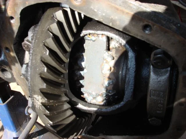

nice work but the welds in the diff look questionable
They are really burned in, that is just the plate over the spiders, the actual spiders are really welded and I welded the spiders to the carrier. The plate on the outside is just additional.
