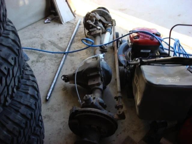

Front Axle
What's the rest of the drivetrain consist of? I'd pick up another hy steer arm too. Those axles geared at 4.56? I'd go farther than a 6" stretch for sure. You'll *want to be around 105" WB. Winch size? May as well buy 8 link ends & some DOM tube & link out the rear before you start breaking leafs. I'd source a pair of used Detroits if your gonna go thru the axles anyway instead of welding it up. Is this truck stockish? You're gonna need some tubing for a cage, shock hoops, bumpers ,etc.

I am running A sbc, sm465, Toybox to splitcase. I am already at 100" wheel base. The axles are good and tight and I am going to have the rotors machined (have a source with a machine that can do it on the vehicle) and weld it up and run it. The cruiser is no way stock antmore. When I start breaking leafs I will look into linking it. I am running fj60 leafs and I have another set on the side of the house.

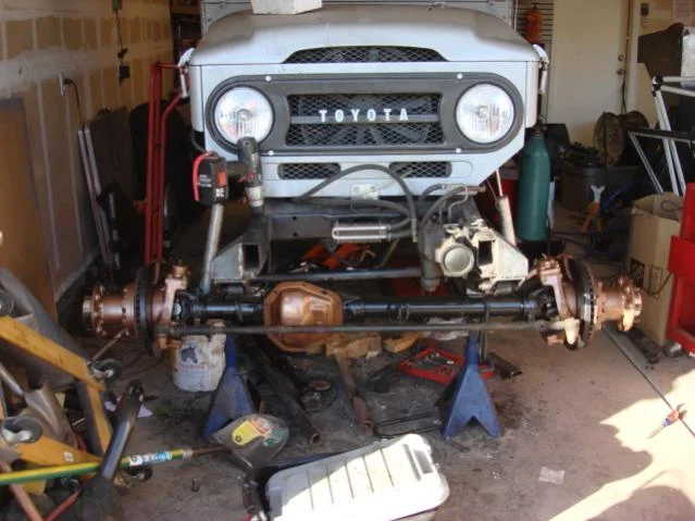

Hopefully dusty, I will have the front mounted next weekend. Just waiting for parts now.

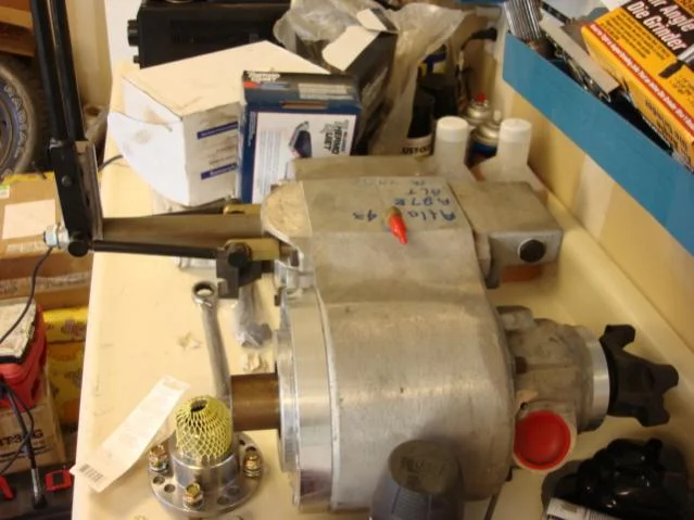

Went ahead and bought a 4:3 Atlas to stuff in this. They toybox and splitcase was going to cause driveline issues. Got the front mounted and cleaned up. Need to still get the adaptor for the atlas.
