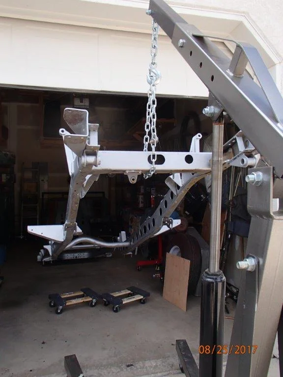

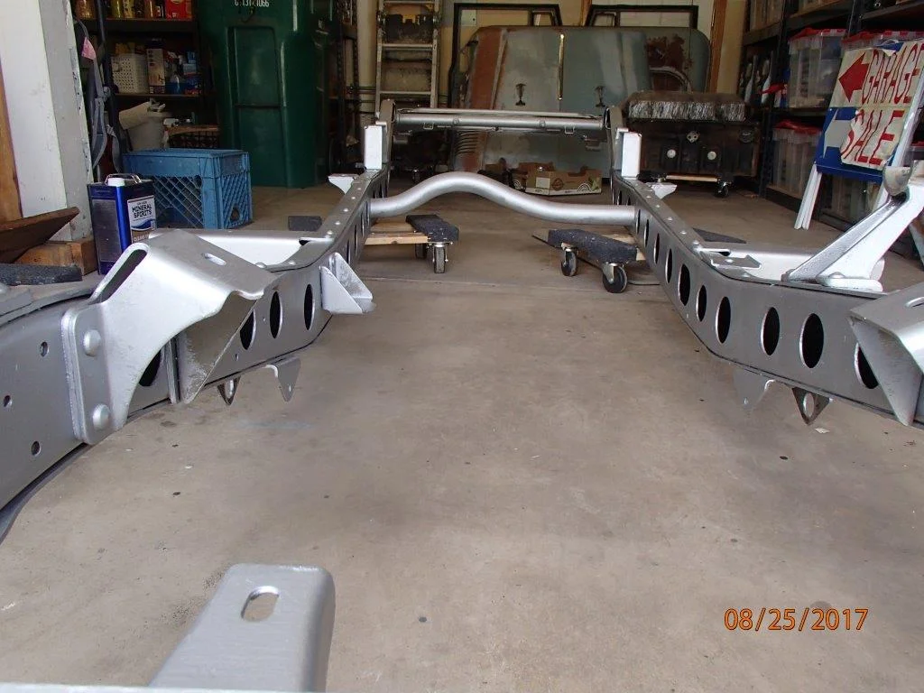

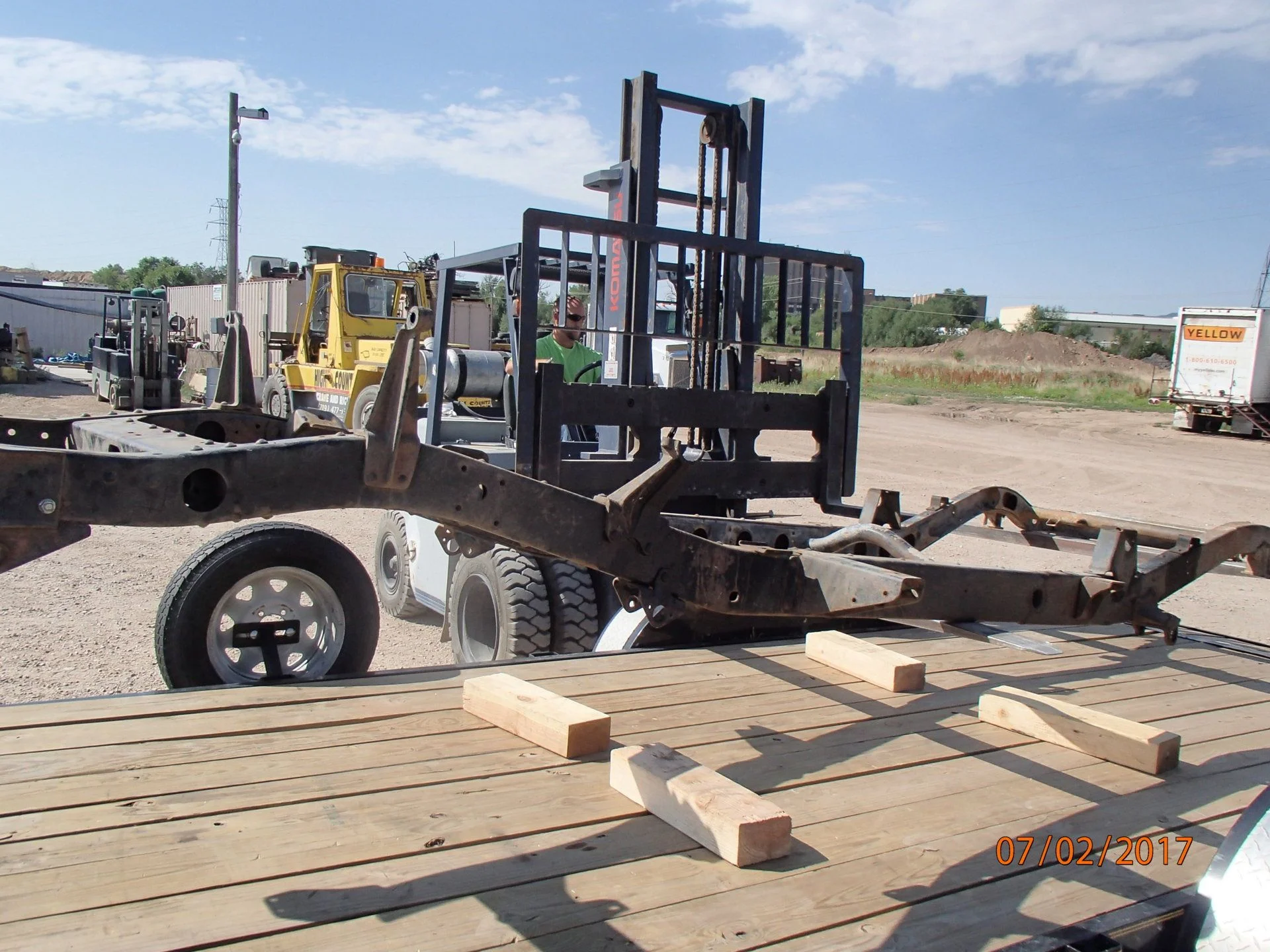

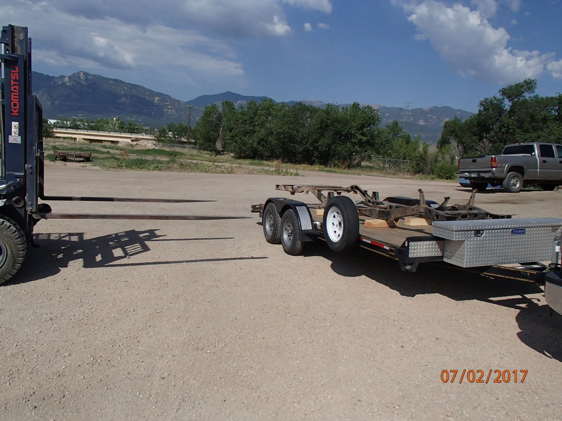

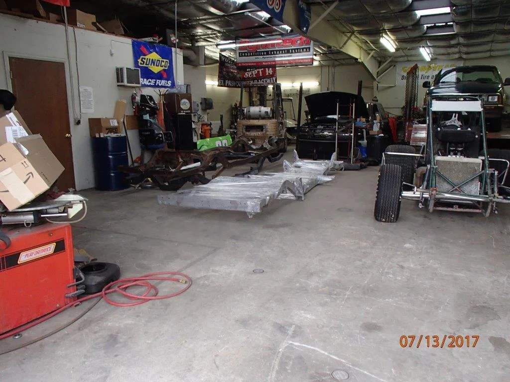

From last Summer. Frame to the sand blaster ...
Next, to the frame shop, to verify and, if not, straighten the frame (was slightly bent). Frame straight and GTG.

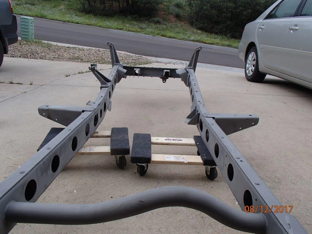

Home again ... Harbor Freight's $11 dollys have been immensely useful

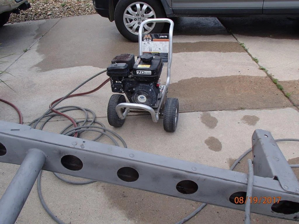

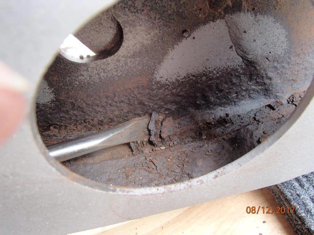

Overall, the frame is in great shape, save for some corrosion inside the frame rail. Scraped and used pressurized water to get at what the sand blaster did not. Water and a sand blasted frame? Just a little a** backwards. No matter - Rust Bullet and Eastwood paint adore flash rust.

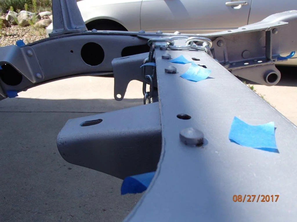

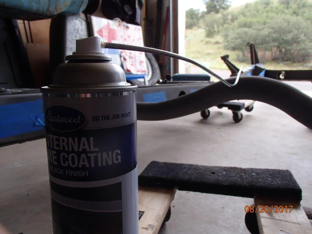

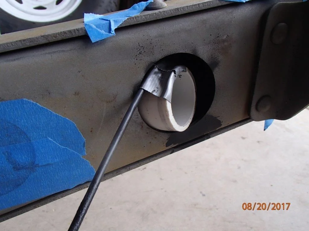

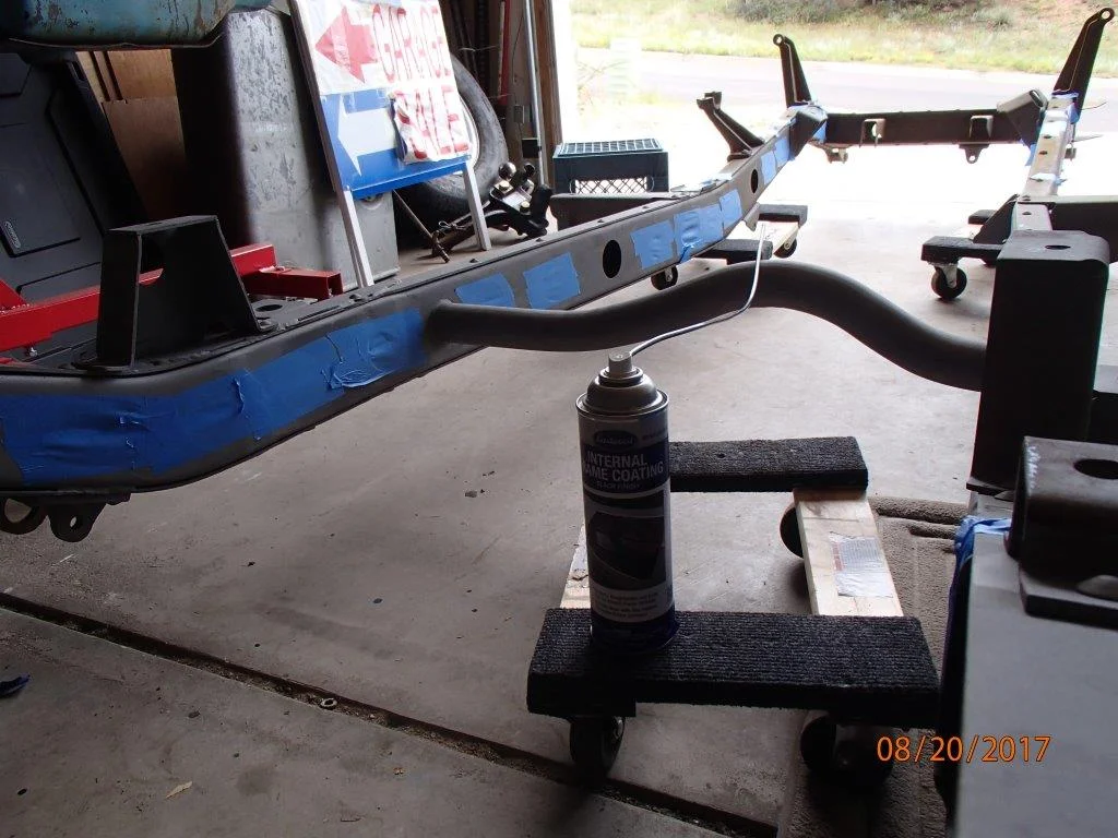

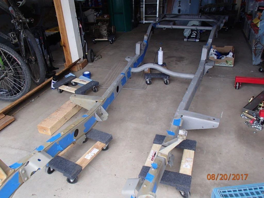

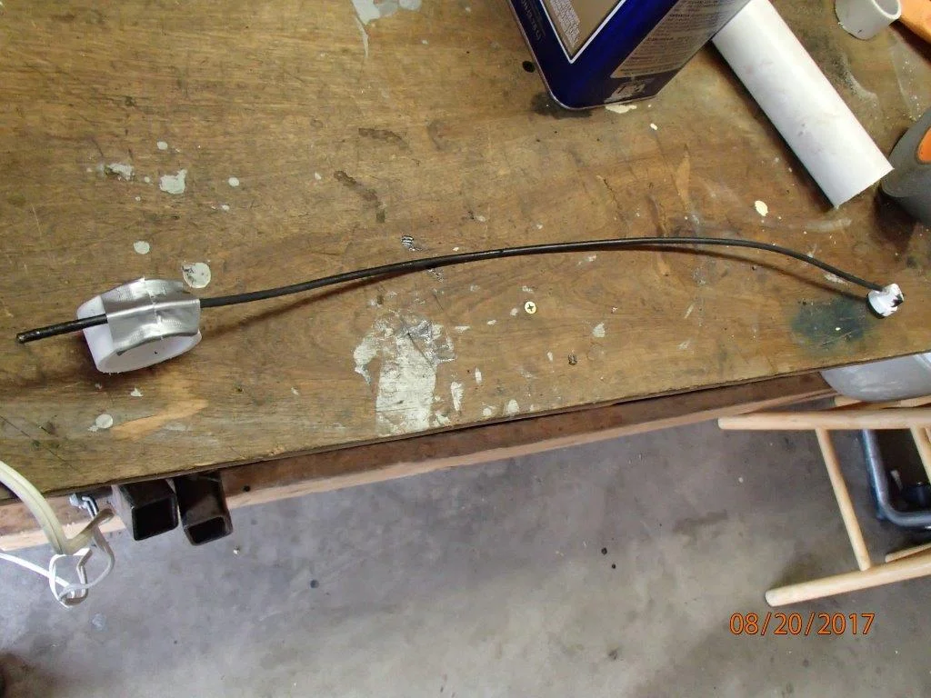

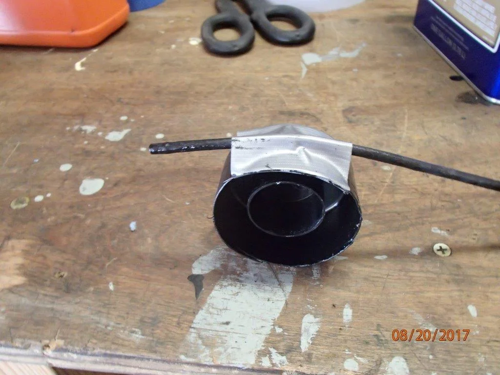

Started with applying paint to the inside of the frame rails. To do this I used Eastwood's Internal Frame Coating rattle can with a 24" extension spray tip. My first attempts made it clear that I needed to suspend the end of the spay tip or I would continue to bathe the bottom of the inside of the frame rail. A rattle can top was about the right height, although I had to reduce the width a bit. Still better was some PVC pipe.
Prep first. Cover holes, paint escape routes.
Cheap and effective
PVC pipe worked better.

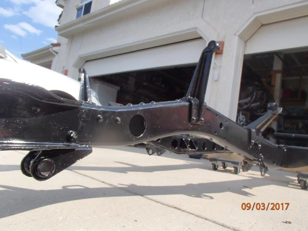

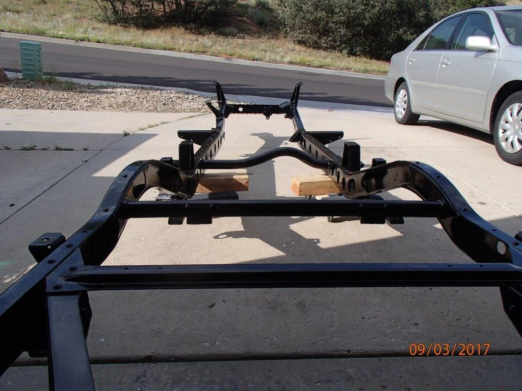

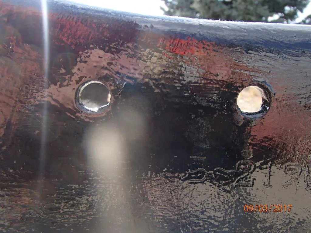

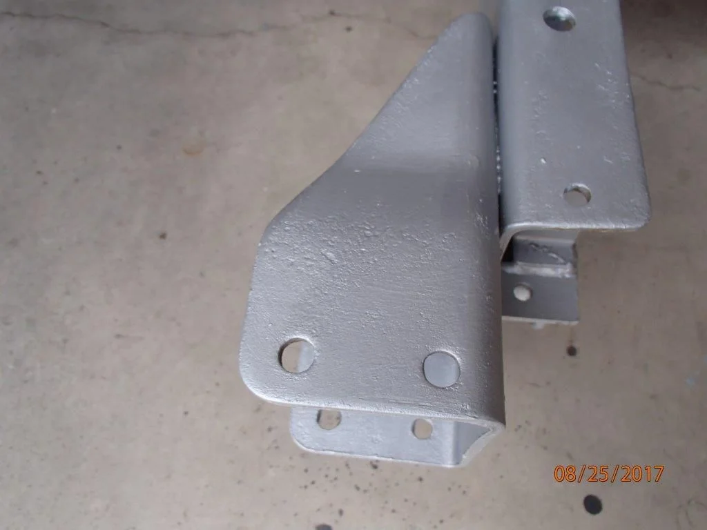

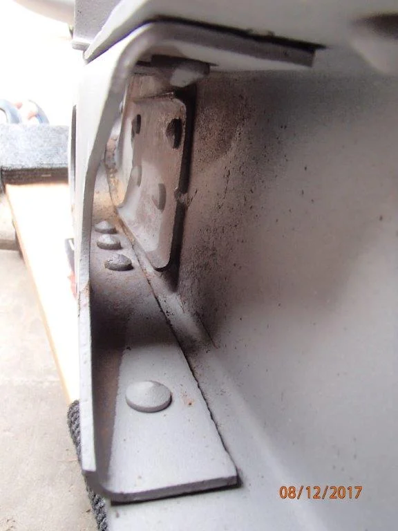

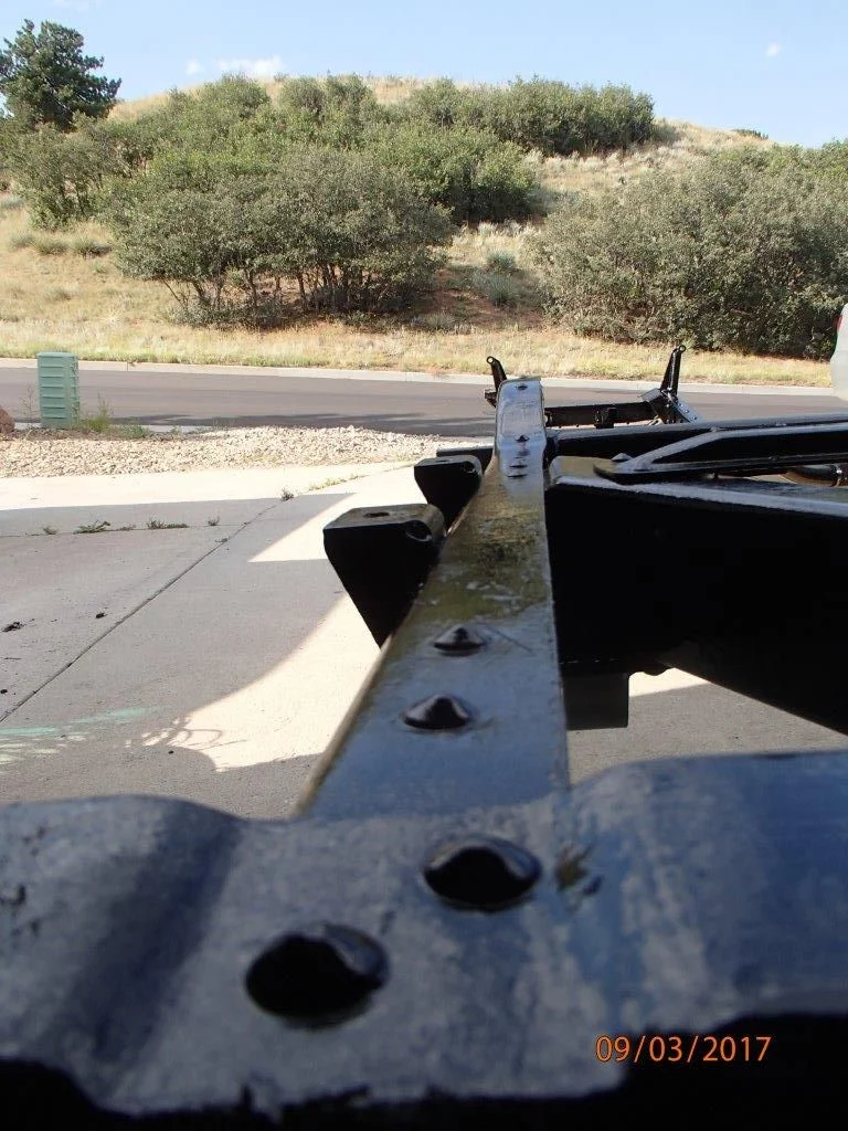

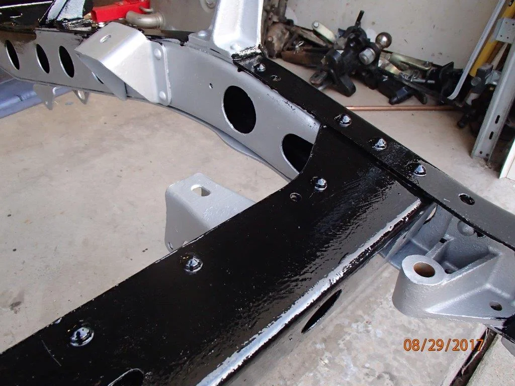

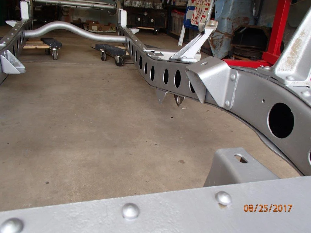

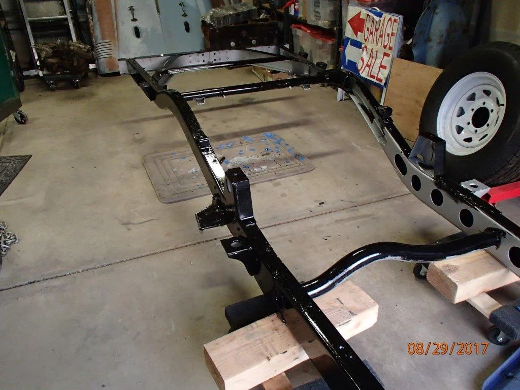

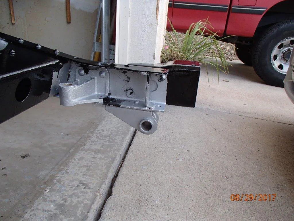

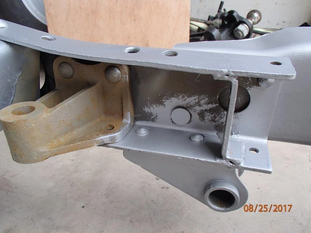

Next up ... applying paint to the external frame. Looked at a few options, settled on Rust Bullet, using a silver base coat and black top (shell) coat. Silver base coat is designed to work on rust, for which I had a bit of flash rust, as the first pic below readily shows. If you like silver, you can stop there. Needs no topcoat. I tell ya, this base coat strongly bonded to the frame. Pics show about done.
Had to come back and paint some areas I didn't quite complete the first time around.
Another spot I missed (shock mount). This would occur more than I cared to remember.

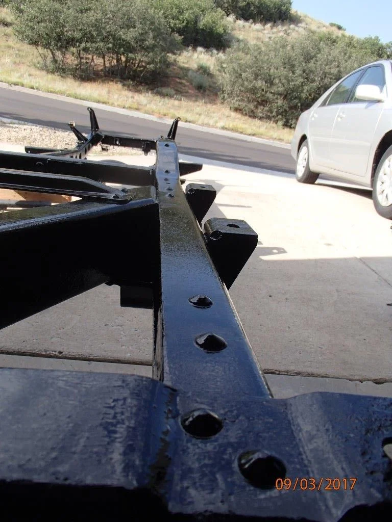

Top coat complete, after I addressed the many places I missed. :bang: Won't be quitting my day job.
So ... would I do it this way again? No way. I would powder coat it. Rust Bullet isn't the cheapest paint and I spent hours with a paint brush for a result I give myself a grade of C, maybe B-. All part of the journey, I guess. Nice to have this step of the rebuild process checked off and future rust no longer a concern.

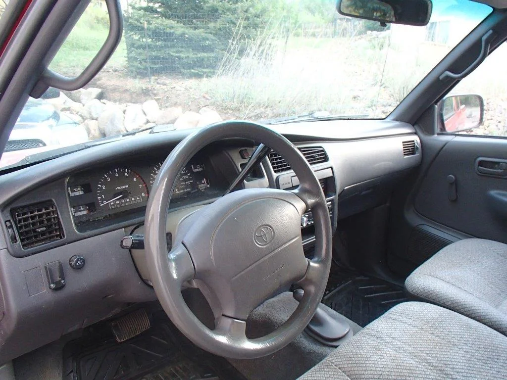

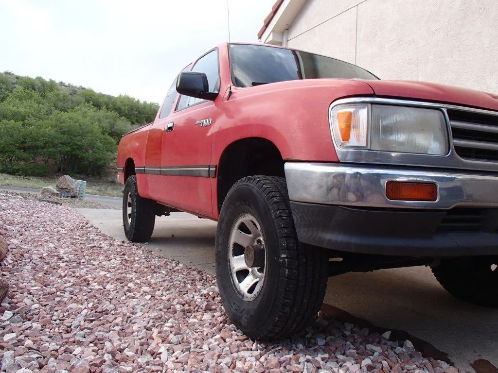

A post of silence for a divorce of sorts ... my purchased new 1996 T100 that I sold a few months ago (June 2018) with 250K on the odo and still running like a top. Toyota replaced the head gaskets at 16K as part of a recall, even though I had no issues (yet) with the heads. Otherwise, it was primarily change the filters and fluids, and, occasionally, the timing belt.
I beat the h**l out of that machine, driving all over the Colorado Rockies and beyond on some nasty 4x4 forest trails. Never, ever, let me down. Took less than 24 hours to sell it. I miss that truck but it was time for a new chapter with a new owner.
Walked out of John Elway Toyota less $24,100 Nov 1996. I call that a bargain for the trouble free memories that truck gave me the next 22 years.
Pics just before it was sold. My kids called it "Big Red."
