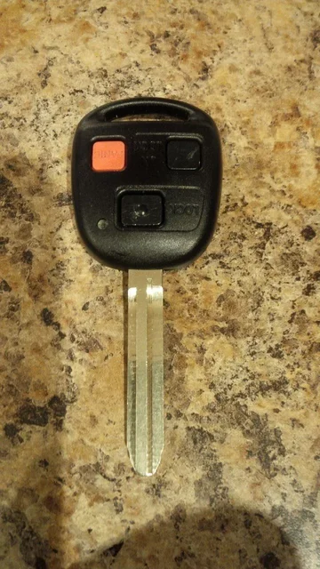

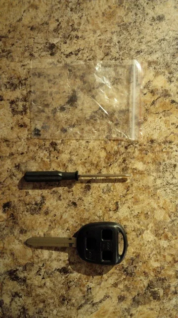

Got the new key today. Need to get it cut.
New Key:
http://www.amazon.com/gp/product/B007IZX3IG?tag=ihco-20

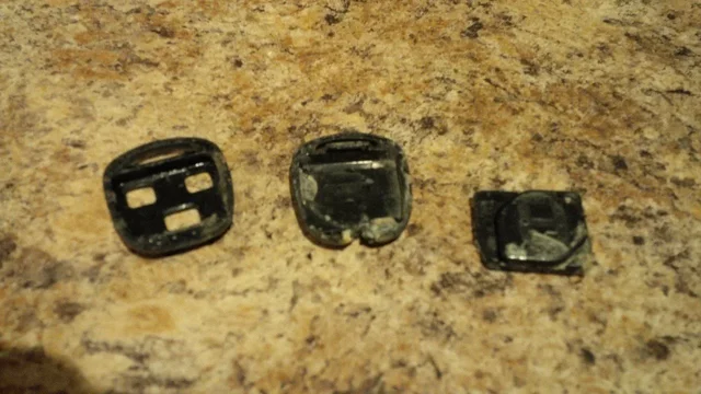

Previous owner glued it to hell... lol. I had to melt the glue in hot water and clean the parts.
New key nice and clean..

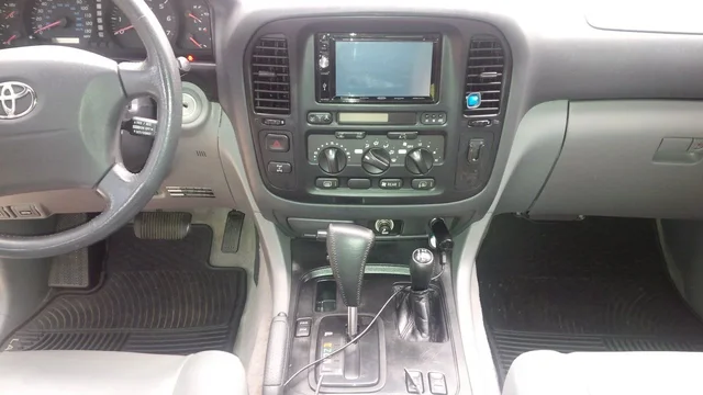

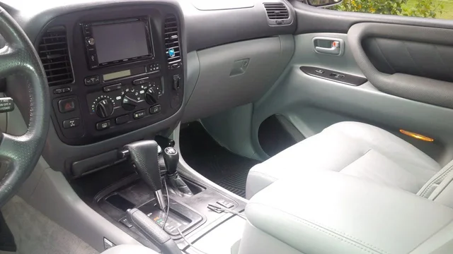

Finally finished installing my speakers. I have the factory sub i want to swap also if anyone can suggest a speaker.
Hardware used:
Speakers:
I cant say enough about this set. It is absolutely amazing. They are clear and sound great with an amp. If you have any doubts or are on the fence, do it.
http://www.amazon.com/gp/product/B002BZFSYA?tag=ihco-20
http://www.amazon.com/gp/product/B002BS5YAA?tag=ihco-20
Back up camera:
I wanted something small and unobtrusive. Unfortunately I will be returning this as there is no where to mount without drilling into metal and im not doing that.
If someone has a better camera, Im up for ideas.
http://www.amazon.com/gp/product/B00GSFIJS6?tag=ihco-20
HU:
This unit simply cant be beat for the price. It has SO many features for the price point that it makes it a no brainer. Really happy with this purchase. You can upgrade the maps and software online when you purchase it. You get 90 days to do that.
GPS works great. Love Pandora Link, it will turn on Pandora on your phone for you. Also, you wont need screws or Kit for the dash. Its a perfect fit and the srews on the factory unit work fine.
http://www.amazon.com/gp/product/B00KRLICIE?tag=ihco-20
Integration Harness:
Make sure to pick this up if you still have the factory amp. It mates the amp and HU cleanly. This also leaves the AMP RCA of the HU available for a second amd. I can also use the factory sub with this.
http://www.amazon.com/gp/product/B0007WRQQ2?tag=ihco-20
HU Screws:
In case you need them. But the factory HU screws will fit.
http://www.amazon.com/gp/product/B00FMSBDYC?tag=ihco-20
Wire connectors:
These little guys are awesome. It was so easy to connect the wires. And if you make a mistake you can just unscrew them. Great find!
http://www.amazon.com/gp/product/B00I1PFD4Y?tag=ihco-20
Mini antenna adapter:
This is for the mini antenna if you have one. I just used this because i dont like the power antenna. This will allow you to use the rear antenna and gets reception just fine for me.
http://www.amazon.com/gp/product/B00009UHRI?tag=ihco-20
Dual Antenna adapter:
If you want to use both antennas use this.
http://www.amazon.com/gp/product/B0002EXF10?tag=ihco-20
Install instructions:
I did not do a complete write up as there is already a very nice thread you can follow with great detail and enough info to complete this task.

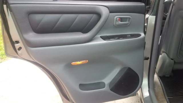

Replaced the speakers in our '03 100. Write-up including sub replacement
Removed wood trim, painted speaker grills, and power button plastic [dont know those part names]. :)
I find your 100 Series very interesting! I like your decision on removing the wood trim. I also find it pretty interesting that your model had the (standard) GPS taken out and the Climate Control put on the center console (Instead of being digitized and integrated into the GPS system like most US Spec 2003 and above 100 and 105 series models.)

This morning I replace the rear sub:
Pyle PLPW6D
I also removed the cloth cover and painted it. I will not provide a how to as there is already a great guide if you search.
The speaker does not make a noticeable difference to me but the original was cracked and sounded terrible. For $20 for a new speaker it was worth it.
The speaker did not fit properly so I drilled pilot holes and used 1" screws. Hand tighten not to strip. I used the foam surrounding the old speaker to stuff it between the openings.
I used the green/black speaker wire in the enclosure. Cut the other and left it in the box.
