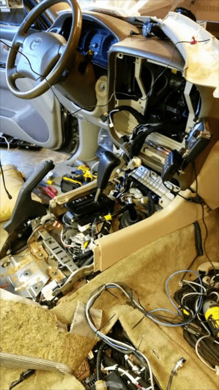

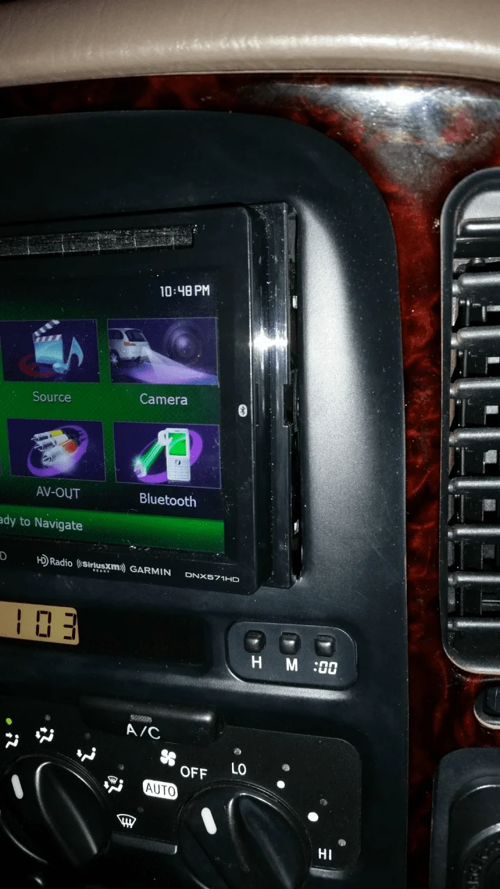

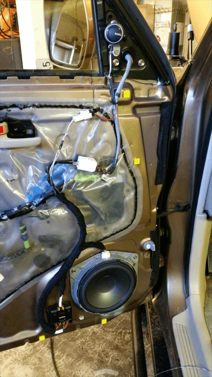

DNX571HD added along with speaks and about 100 miles of cleaned up electrical.
Did this back in Jan just now taking the time to add to thread. The DNX571HD is great. HD radio is a real treat and the simplicity at which it integrates with BT, iHeart, Pandora, etc is awesome. It is directly driving the speaks and power is plenty for me. And with the front MicroSD card you can use Garmin Topo maps (verified and it works). I'll still use MX as primary but a hard card offline map with passive breadcrumbs is a nice backup.

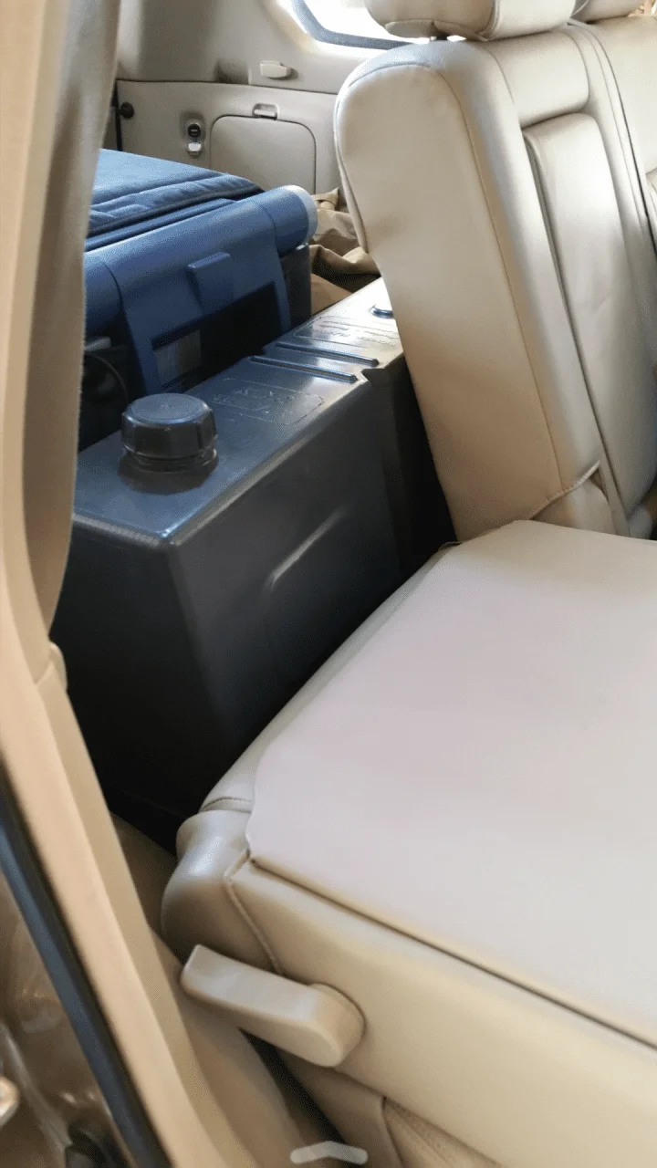

23.8 gallons of fresh in what was otherwise underutilized space
Very nice - which canister is it are they?
Both from Frontrunner. The footwell tank sits, well, in the footwell. It loses a bit of volume due to the accommodation for a trans tunnel which we don't have. Small sacrifice for having a walkable tank (think small kids). The slanted tank takes advantage of the awkward area right in front of the 63qt ARB fridge. Maybe 1/2" of space to spare, perfect fit.
I plant to link both sides of the footwell tank together and then join those with the slanted tank to a common pump.
http://www.frontrunneroutfitters.co...ner-40l-water-tank-footwell.html#.VUevJPlViko
http://www.frontrunneroutfitters.co...nner-50l-water-tank-tapered.html#.VUevlPlViko

Thanks Dennis - how is the fitting on the slanted water tank? Is it very secure?
That would be my only hesitation. But if it is good to go, then that's one thing I can add to my list.
Both the footwell and the slanted have poly MIP x Hose Barb adapters threaded into a reinforced FIP bulkhead fitting on the side of the tank. On one side of my footwell tank the barb was broken in shipment. No big deal, it's a cheap fitting. I'm debating between replacing it with brass or with poly. The brass is more durable, but it will also transmit the force to the tank. I'd rather replace a fitting than a tank, but I'd also rather not have 24 gallons of water flooding into my truck should a kid step on a plastic barb.
It's going to take a little R&D to sort it out, but I'm not too concerned about finding a good solution. We go through about 6 gallons a day (if no showers) and our typical deployment is 3-4 days so 24 gallons is a perfect addition.

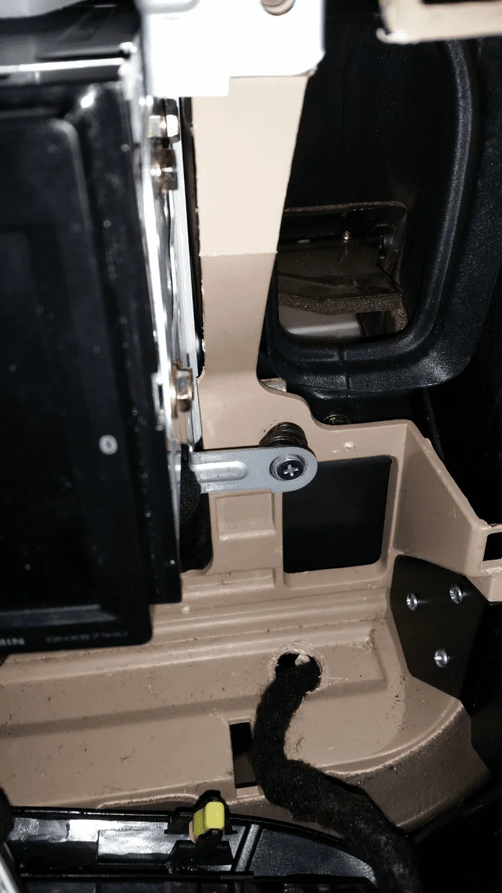

Been having a bit of readability issues with the DNX571HD. At certain sun angles it picks up some glare. About 5/8" of washers shimmed it about 5° toward the driver. Some minor Dremel work was required but nothing you'd notice if I revert back.

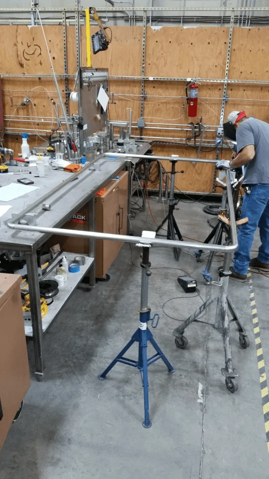

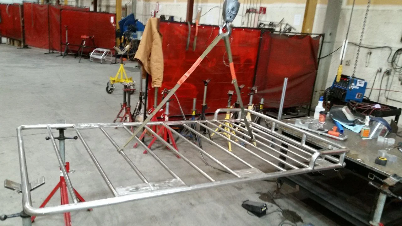

Rack fabrication has begun...
Boom!
