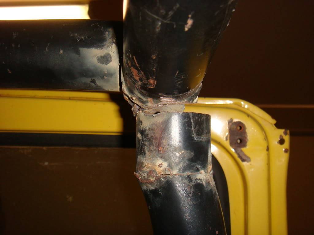

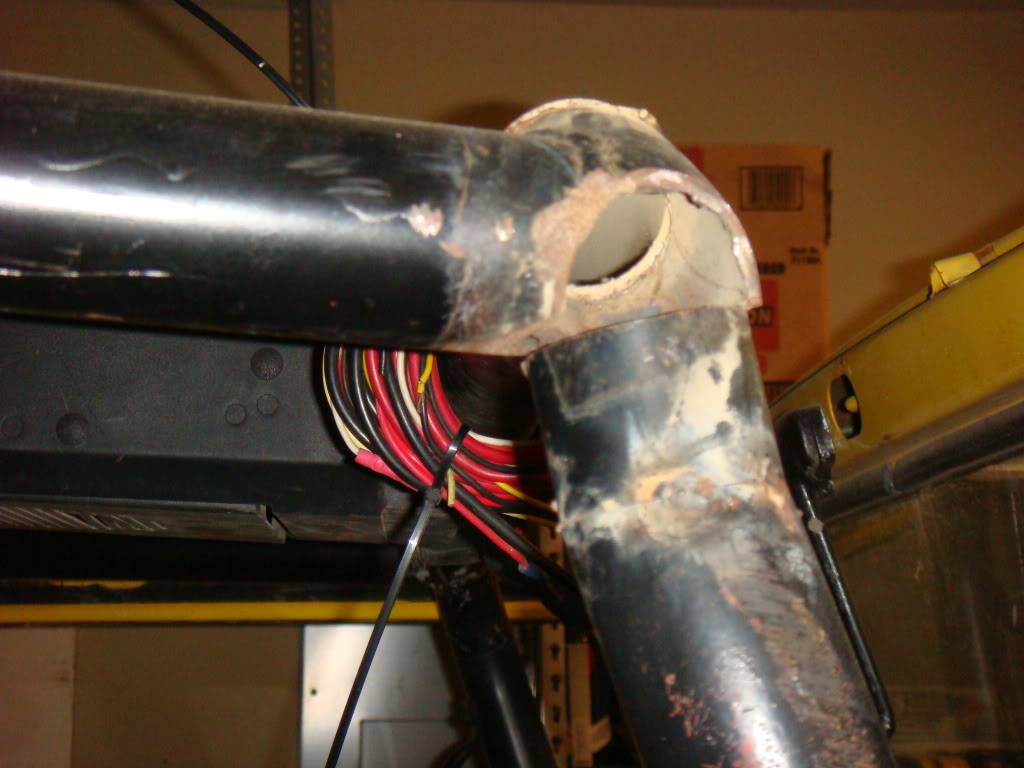

Anyone know where I can get a piece of 2" tubing about 18" long with a 90° bend in it, in Lafayette? I need to fix the cage or pull it out and put the stock one back in.
edit: I don't have calipers here, so I don't know the I.D. or thickness yet, but I'll get those if there is a place to get tubing in Lafayette.
I need to fix this....
My BNL has built race cars and stuff, he says to properly fix that, I could get some tubing with an OD that matches the cage ID, then weld in some short sleeves using rosette welds, with the new 90 in between. It sounded legit to me. Time is not on my side, as usual, so I may try to sell the cage and tuffy box and just put the stock rollbar back in.
edit: I can't take credit for this, but I should have talked it over with the guy a little more before the cutting started. The cage was too wide, if you recall, so it could have been easily fixed by cutting an inch or two from the two tubes that cross the front of the 40, sucking the cage together, and making two welds. Hindsight is 20/20
Percy Guidry should have all your metal needs Brian I'm not sure on the bending but they make all kinds of stuff in the shop so they may.
