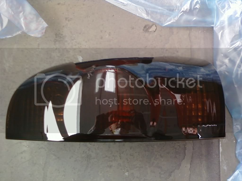

I like how the clear ones look. But I also really like how tinted looks also. VHT works ok, but by far the best is to use tinted clear coat. You can make them as dark as you want and the light shines thru really well. Altho with everything else murdered out it might be a bit much.
tinted cc tail light-
