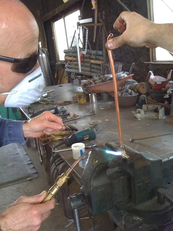

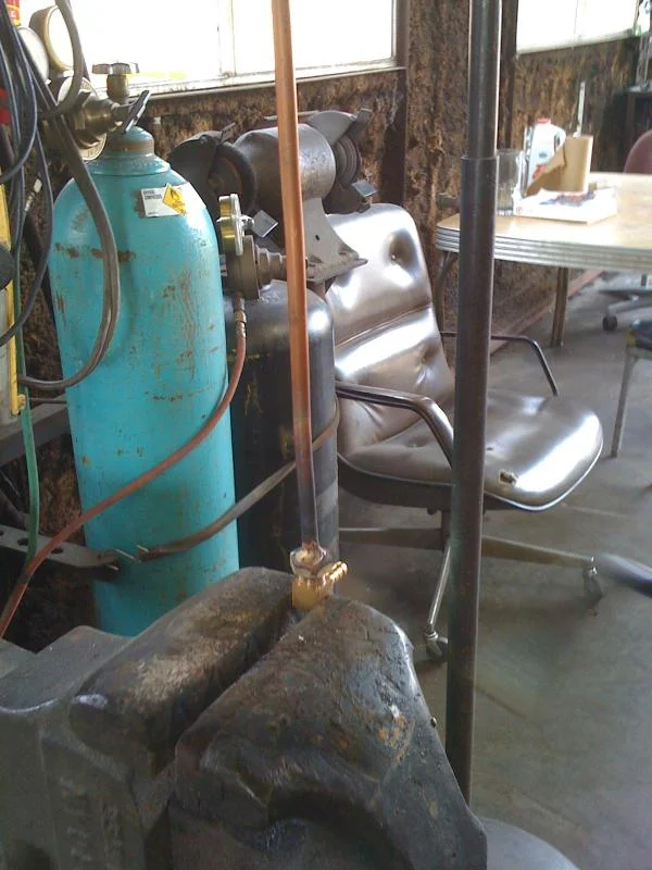

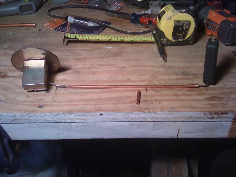

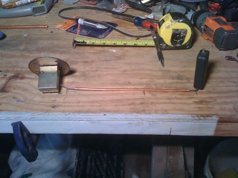

I used a piece of copper refrigerator tubing for the extension of my sending unit arm. After discussing it here I took the advice of Gary Coberly and used copper because it is easy to find and easy to work with.
My local Ace had refrigerator tubing that fit snugly over the rod of the sending unit arm. I cut the arm, cut the tubing to length (175 MM), coated the arm ends in solder then stuck the arm ends into the tubing 25 MM on each end, extending the arm by 150 MM. The Brown Davis instructions have a diagram. I drew it out on my work table to help out.
I crimped the tubing down onto the arms in several places, and then soldered it up. The pictures show the length, not the correct orientation of the float to the sending unit.
I tested it in a bucket of gas, floats great.
