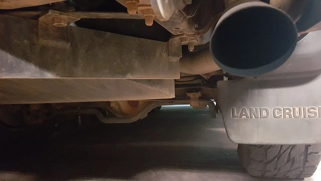

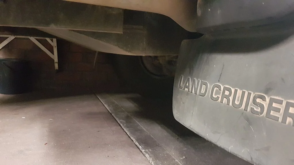

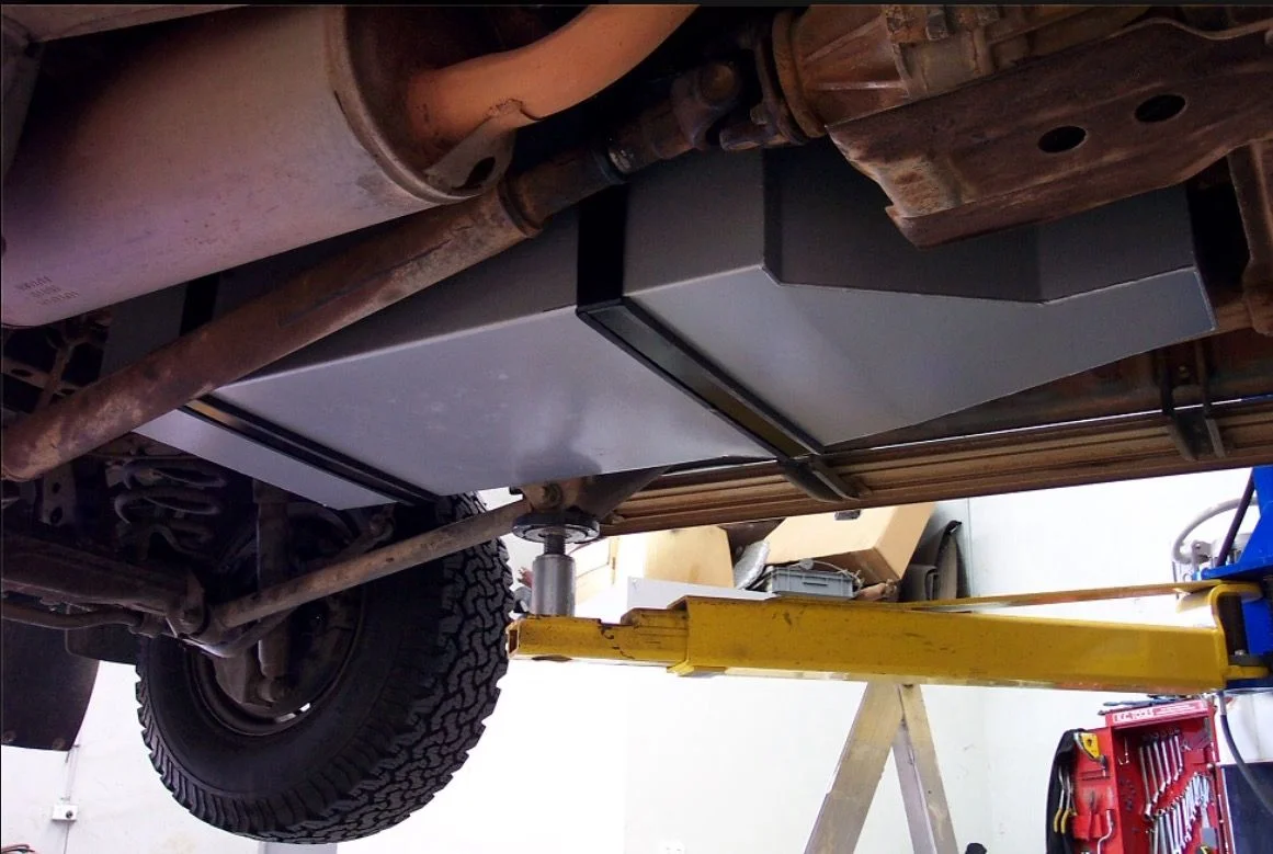

I believe OP is talking about a long range single tank that goes where stock tank is, not the subtank. The single bigger tanks do hang down a bit lower than stock. Iirc about 4" but it definitely more exposed to rocks and now without a skid. Here is one pic but on a lift so the driveshaft is drooped. Seems like @Koffer had a good side shot maybe? I cant find at the moment.
I Looked at the long ranger tanks before they quit importing when I was replacing the tank but didnt seem worth the cost and loss of clearance to me. They may have only been 35g too

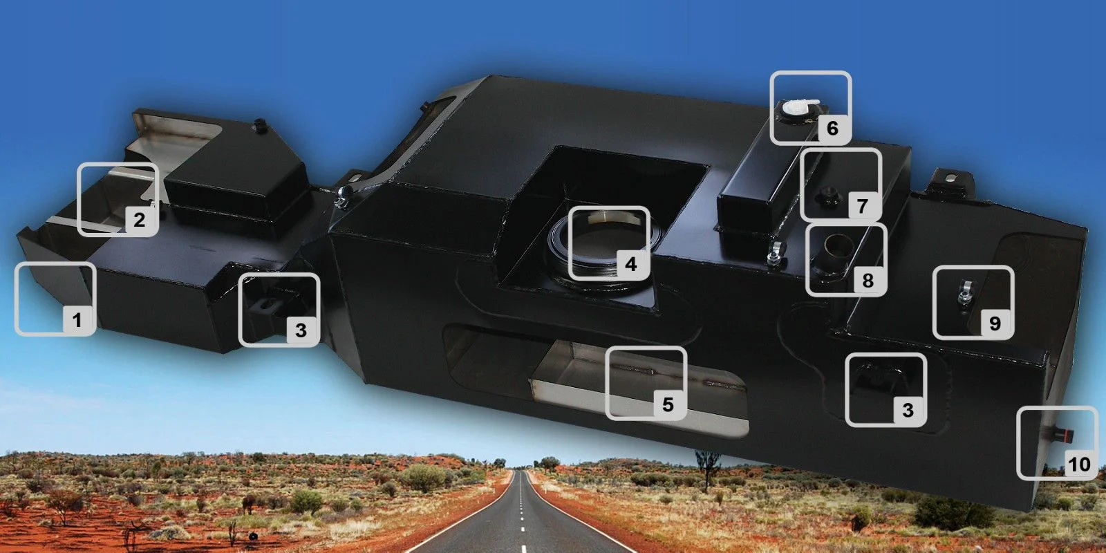

Their site is a bit confusing on mobile..... it only seems to show the replacement sub tanks 168 L (44g) that specify they require removal of spare. Pics arent clear but sounds like this maybe goes behind the axle after all?!? Maybe the OP can provide a pic or link to help before you spend your money.
Toyota landcruiser 80 Series 168lt replacement long range fuel tank – Brown Davis- Long Range Fuel Tanks, Underbody Protection, Roll Cages and Motorsport
Looks like LongRanger tanks no longer offer the increased capacity main tank either.
166L Replacement Fuel Tank | The Long Ranger
It definitely looks like 44 gallons in the subtank position. It also says it "utilises the vehicles standard pump and fuel system with no modifications" so I wonder what exactly is going on.

the tanks take the place of the factory fitted fuel tank, and as such are a direct bolt in solution for increasing fuel capacity. On average, increased capacity is 40% or more, with some tanks in excess of 100% increased capacity.
Can we get an actual picture of this? Because the link is for a sub tank.
44ga in place of the factory subtank? That's got to hang down super low? Any physical measurements on it?
he sending me all the particulars but it in place of standard tank, almost doubles capacity and is made of thicker steel

I’ve managed to touch the factory tank skid on rocks, I can only imagine what I would do to this one.
I sold my 4Runner and bought a Land Cruiser to get away from low hanging gas tanks.
