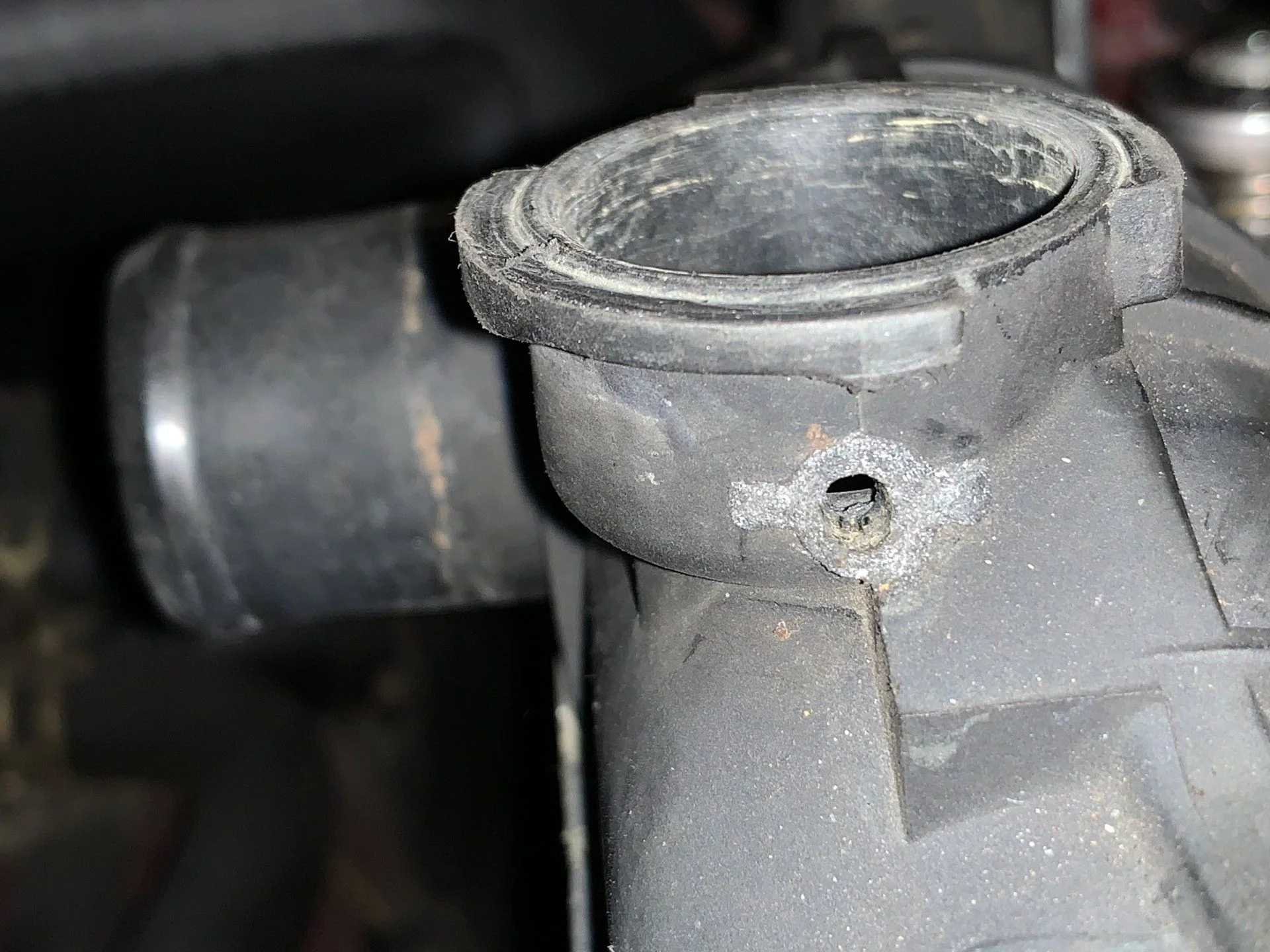

Has anyone had luck fixing a broken overflow nipple on an early 80 (pic attached)? If so, what'd you use?

If you're bound and determined to try a fix, I'd look for a bulkhead connector the approximate size. I'd try it. You'll need to use a Dremel or the like to put flats on the inside and outside of the neck. No idea of your chances, but maybe??? Or epoxy? What the hell. It's not worth much this way. Good luck.
If the radiator is in otherwise good shape, you can just get some brass tubing of the appropriate size to fit in the hole and JB Weld it in place (*or drill a new hole that fits the brass tubing).
The overflow isn't a pressurized connection, and is only open when the radiator cap vents low pressure on expansion, and as long as it's sealed, low pressure on radiator contraction. In other words, it doesn't have to hold up to even 14.7psi atmospheric, but it does need to be air tight to function.
Importantly, your fix should not impinge on the seal of the radiator cap,
Been there, done that. We did a quick fix that lasted years, until my upper tank cracked.
Clean up the hole and tap some threads into it, get a brass fitting that is male threads on one side, barbed on the other. Use some teflon tape, screw that brass nipple in and you're good to go. It's a $4 fix.

Good idea with the brass tubing. I’ve found a diameter I think would fit that hole. But I don’t know if the tube would hold up well over time if just secured with epoxy - working under the hood, remove the overflow hose, and general vibration might weaken the bond.
And that's why you tap some threads into it and use a threaded brass barbed nipple. It's solid that way.

Glad to hear yours lasted years. Was yours the 3FE? The hole is in a very tight spot. Would be difficult to tap. But I could seal the hole and tap a new hole facing the engine.
i also bought the Dorman tube. Seems less likely to crack the plastic over time than a metal fitting.

Mine is a 95, so the nipple faces the firewall, was easy access.

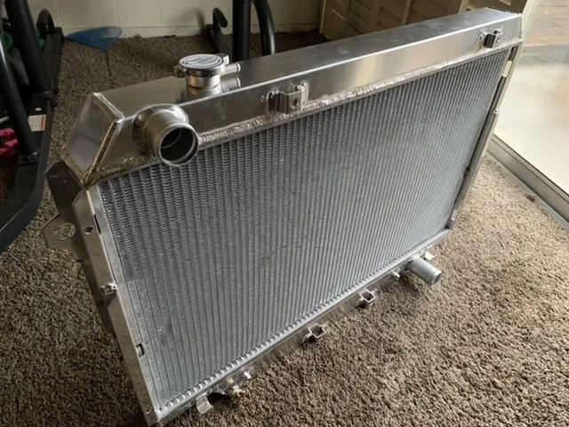

Update. I just ordered the Liland Global 13AA aluminum radiator from Rock Auto. The 30 year old radiator (I think it's the original) is probably near retirement, and I didn't want to mess around with a rigged, possibly temporary fix. Thanks for the help.

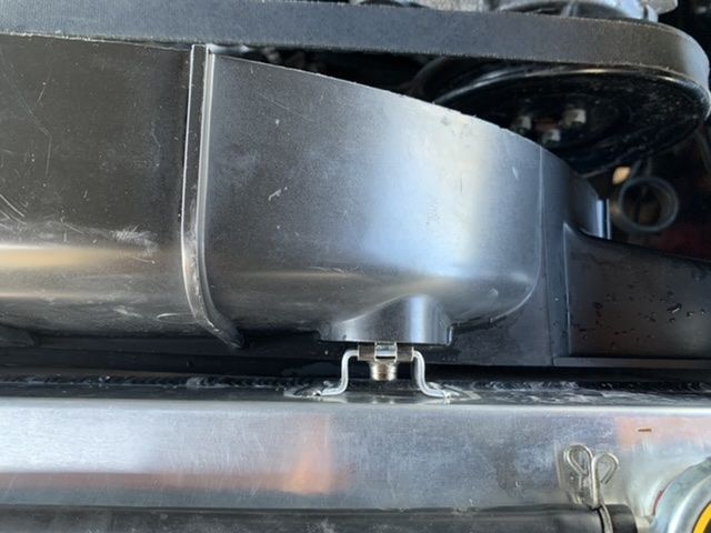

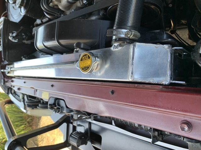

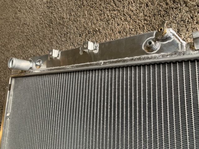

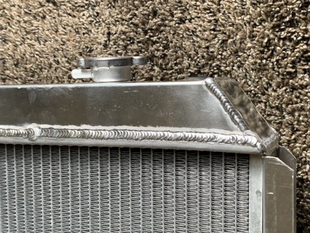

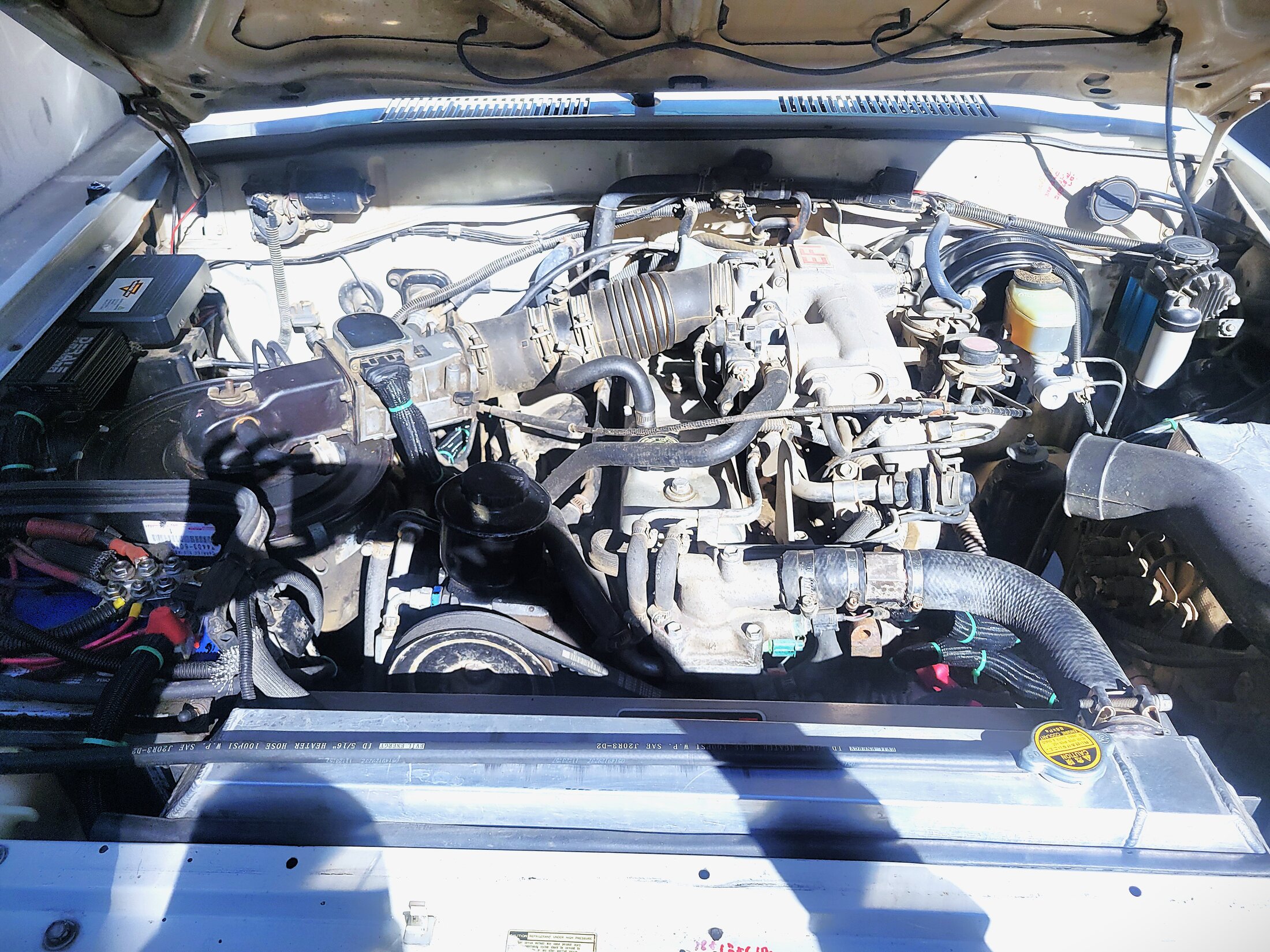

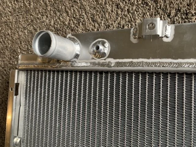

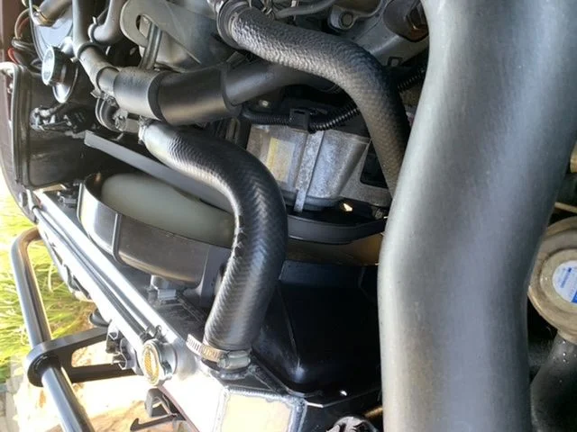

Here are some pics of the Liland Global 13AA radiator for the 3FE. I needed to bend the two lower brackets up a bit to line up the fan shroud. Otherwise, it bolts right in. Be gentle because the fins bend very easily. It does leave gaps between the shroud and radiator. I have open cell foam tape on order to fill the gaps before summer comes. So far, it keeps the engine cool.
