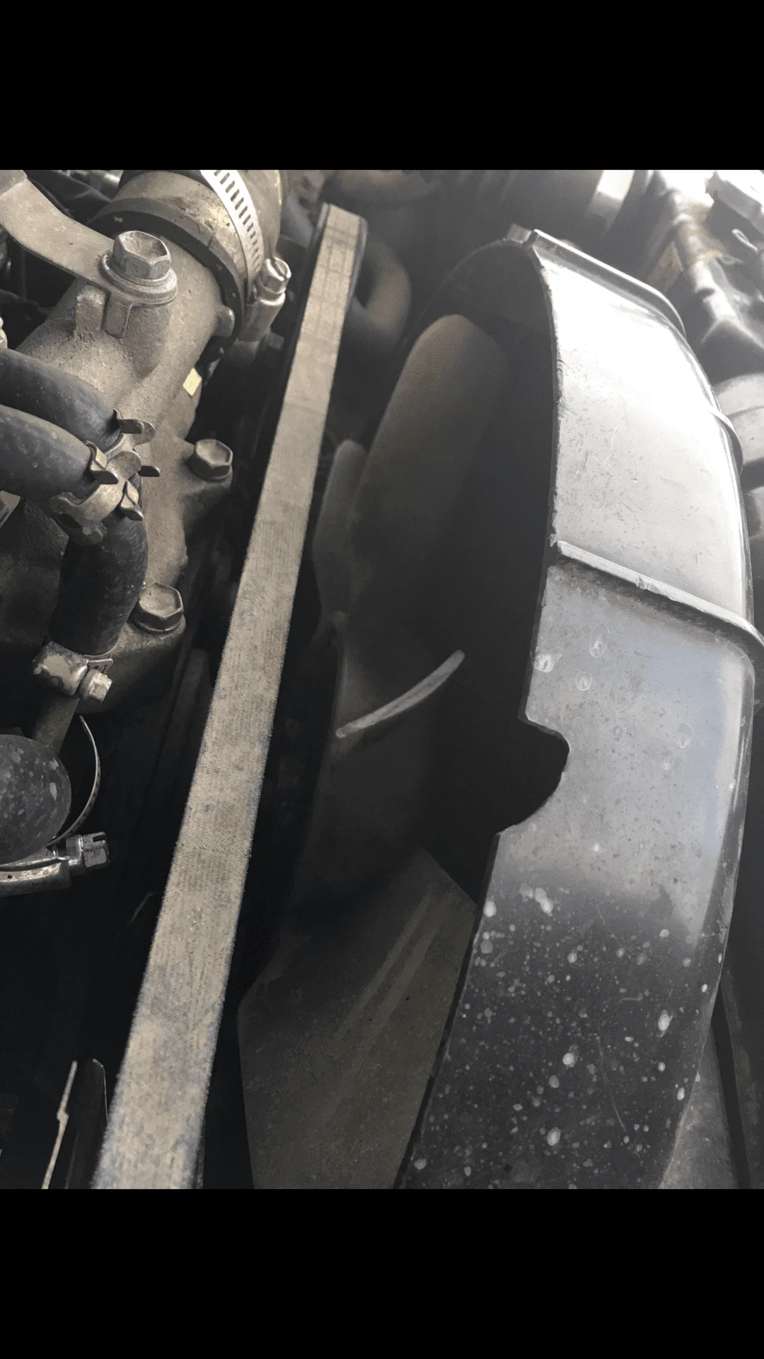

I noticed today that one of the fins on my radiator cooling fan were gone. Don't know how long its been broken, is this something that should be replaced ASAP or should it be fine with 7 of the 8 fins. Any cheaper fans work? All the replacments are ridiculously overpriced ‍♂️
Thanks ahead of time!

I checked it out and the only damage I could spot was a chip in the top of the shroud. May just be super brittle old fan. Just had a rebuilt engine put in so i would hope the mechanic was smart enough to make shure the mounts were solid. Im still trying to become more mechanically inclined by fixing the little stuff. I figure replacing the engine and radiator mounts would require a good amount of work?
Here is a picture, havent posted on here much so trying to learn

Don't run it with a blade missing or it will most likely grenade due to out of balance.

The fan may have cracks radiating from the centre outwards, the blades can fly off and hit the rad, the VC can rarely seize resulting in high fan speeds and perhaps aggravating the problem or, done any water wading, that can damage the fan?

Plastic fans don't last forever, after a couple of decades should be occasionally inspected and replaced when needed.
