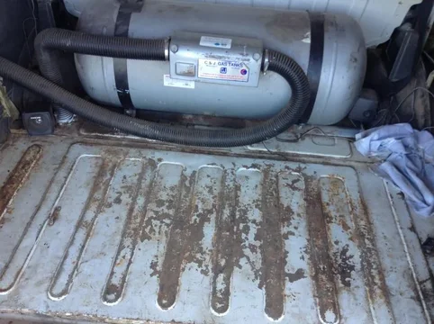

I thought the tailgate was an upgrade option in the world market, and the amby door came standard EXCEPT in the US where it was only an electric tailgate. I Talked to Specter years ago and he told me it was an entirely different rear clip. at least, that's why I never pursued trading my electric tailgate for a set of amby doors...prolly do-able, but like you said, a real pain in fab work...got any more pics of your LPG set-up? the mixer and adapter that is...

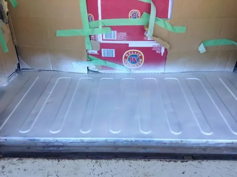

I started tackling the surface rust/pitting in the trunk floor last weekend. Feels good to slowly start rust prevention.
To get in the trunk I've had to enter/exit by putting all my weight on the tailgate.
Is there a load limit for the tailgate? Has anyone broken their hinges/ struts?
Before
After

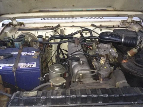

If/when you have time, would appreciate a detailed pic of the air cleaner assembly and mount.
