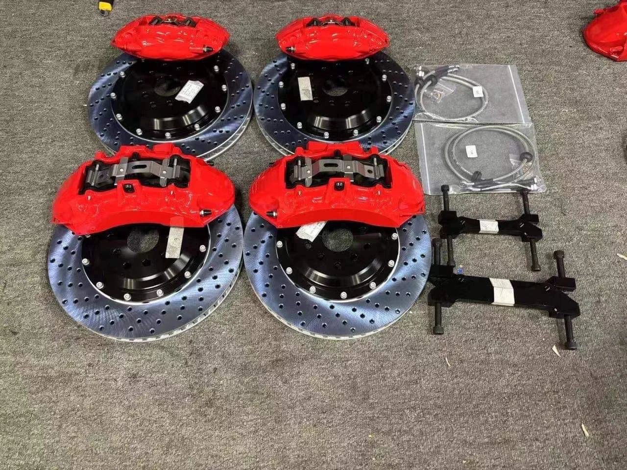

Brembo Front GT BBK Brake 6pot Red 405x34 Drill Rotor LX570 Land Crusier 08-15​
Gentleman, seeking guidance for a BIG BRAKE set up looking to purchase.
I own a 2002 LX470, I have swapped 2017 LX570 OEM WHEELS. These are 20" OEM.
I am looking to buy the above referenced kit. The wheels I had for over 9 years no issues, if those fit no issues and bolt pattern, the brakes should hook up as well?
Reason for going with the kit, truck has 300k, I get the shakes and brakes feel weak, has me second guessing going faster then 50mph.
In addition I will also, be replacing the OEM main brake booster at the time of install, to have the whole system NEW.
It's about 7k total, I am OK with that.
Thoughts on working?
Thanks for input
These trucks stop great with all factory Toyota parts. You clearly have an issue if you are scared of going above 50. Some rando Brembo kit would likely lead to headaches if you already have pre-existing “bad brakes” going on.
Not a direct bolt-on application for the 100 series. The tundra/570 rotors have a different offset/hub depth.
You'd have to have custom caliper brackets fab'ed, and still not sure how the rotor hats will integrate with
the 100's hub design.
