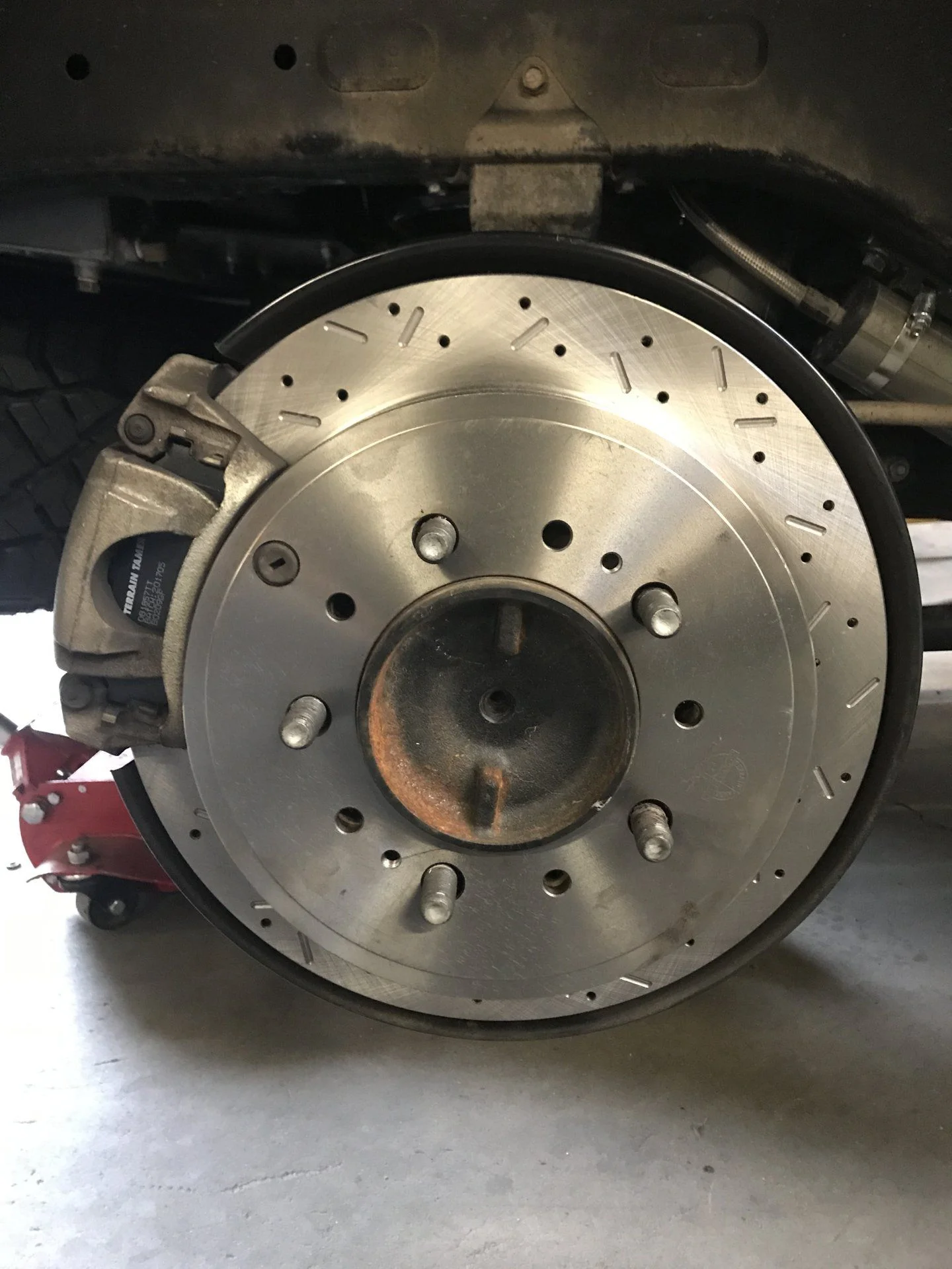

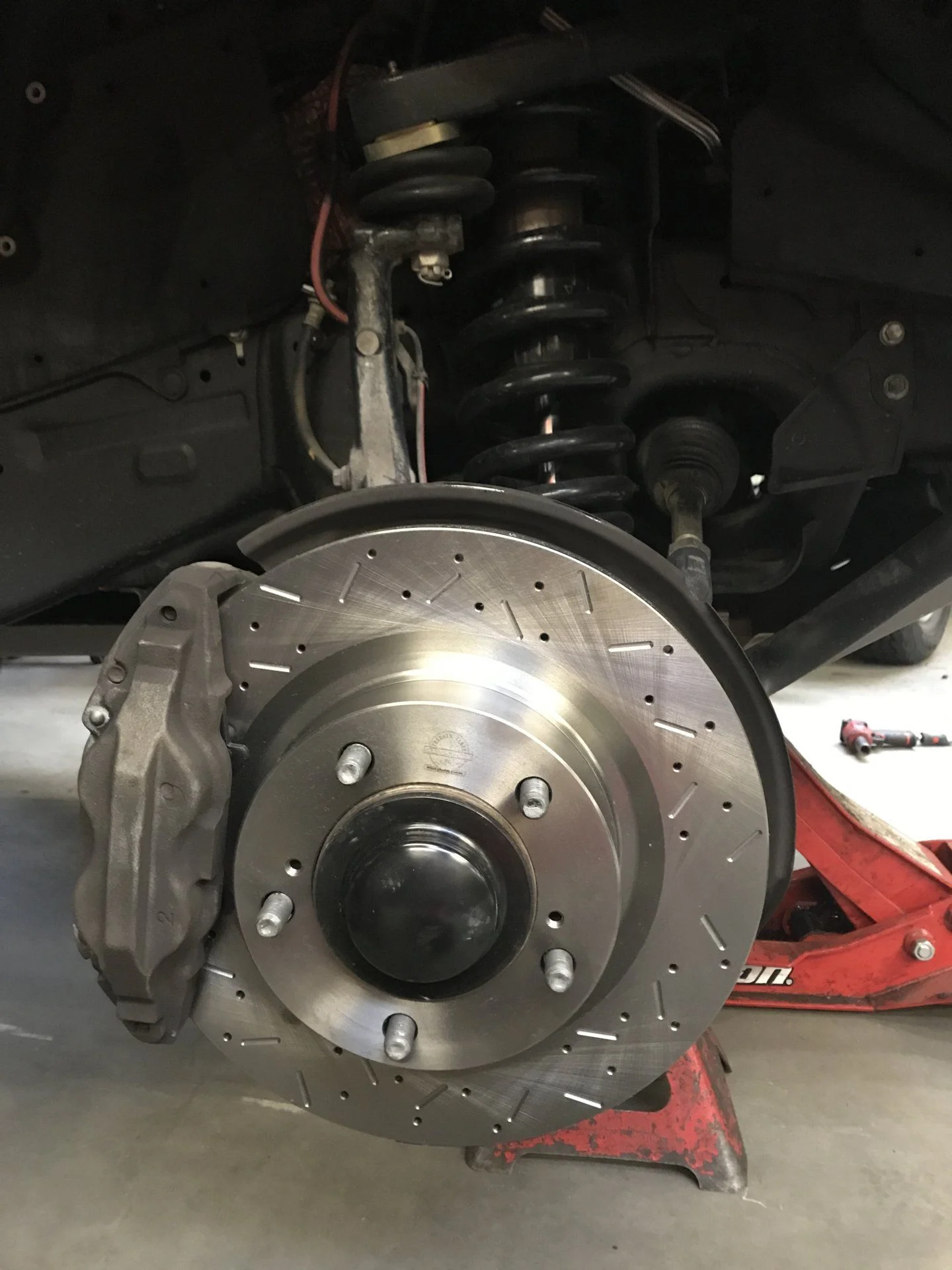

As mentioned above, we just installed a complete set of Terrain Tamer HD drilled and slotted rotors and matching pads on this 2016 belonging to Cole.
We have I stalle numerous sets of the Terrain Tamer HD brakes on customer vehicles as well as our own. My DD is a 100-series equipped similarly to Cole's 200. I installed the Terrain Tamer brakes on it well over a year ago and they've performed flawless. Couldn't be happier.
