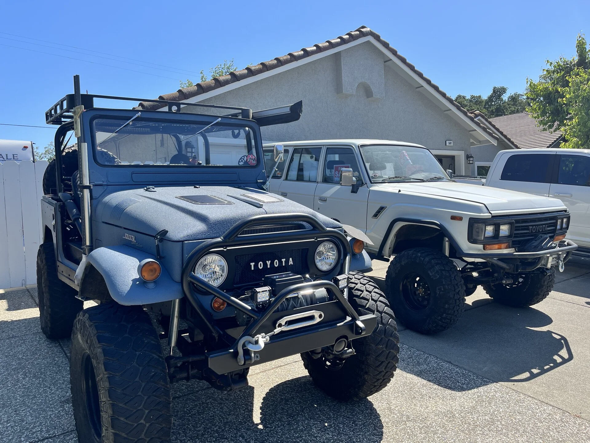

No build thread, sold my built ‘88 FJ62 and bought my neighbors 40, which already was SOA, on 37’s and has a Holly Sniper kit on a SBC 350.
I put in a 4.3:1 Atlas, which required a centered rear axle…. So I went full width factory disc axle from an ‘05 Chevy 2500. I also stretched the rear wheelbase back about 4.5” and used Waggy 44044 springs in the rear. Once I find a Chevy D60, I’ll swap the front axle and push it about 6” forward and 3-link it. Just need to find the axle first

Nice! I’ll be watching for updates wherever you put them. Looks like a fun Cruiser.
