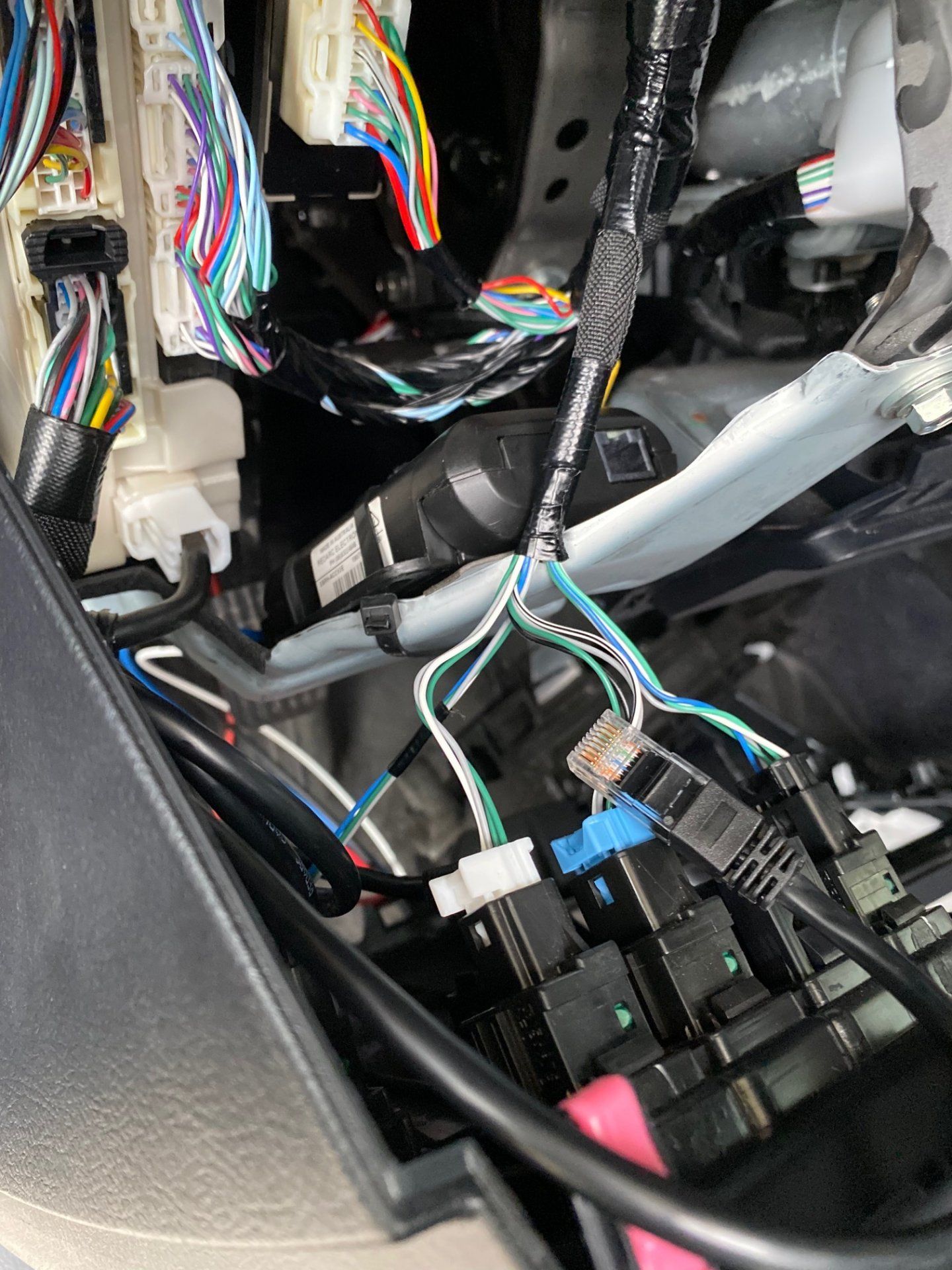

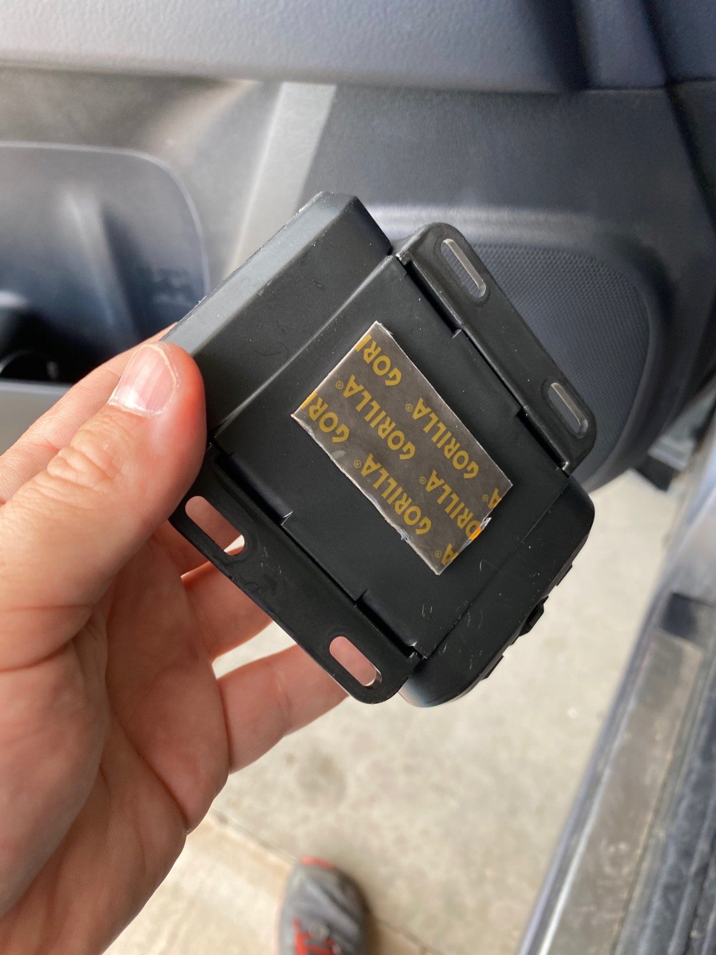

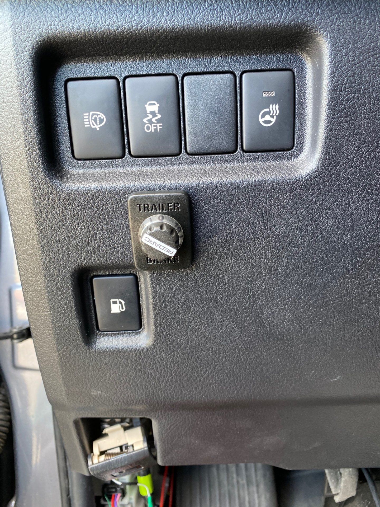

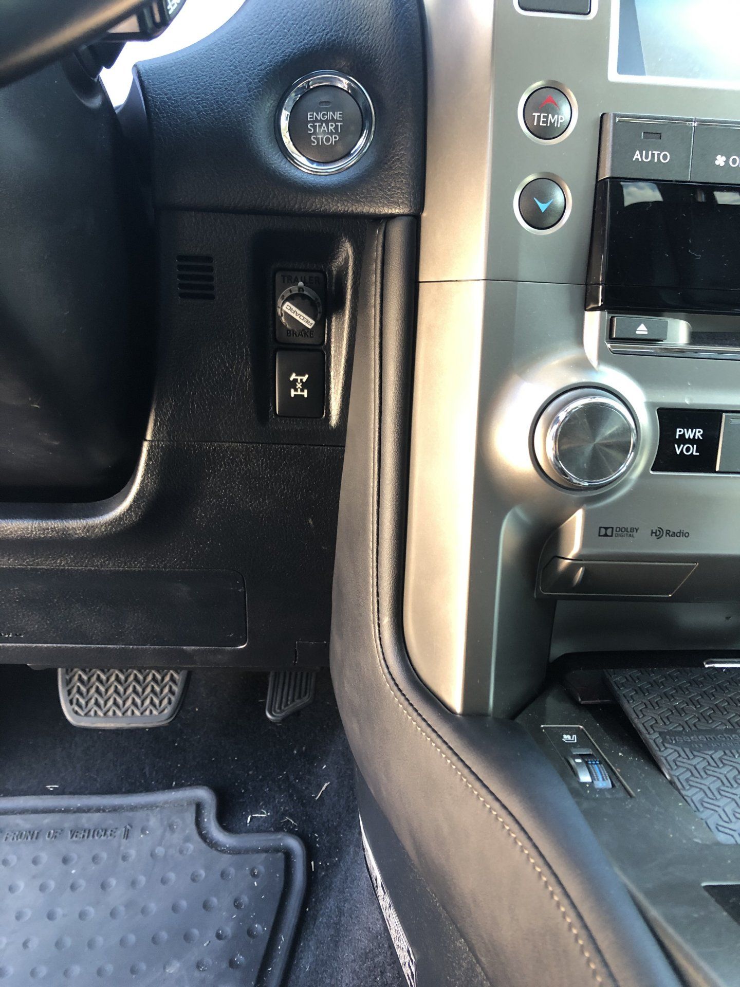

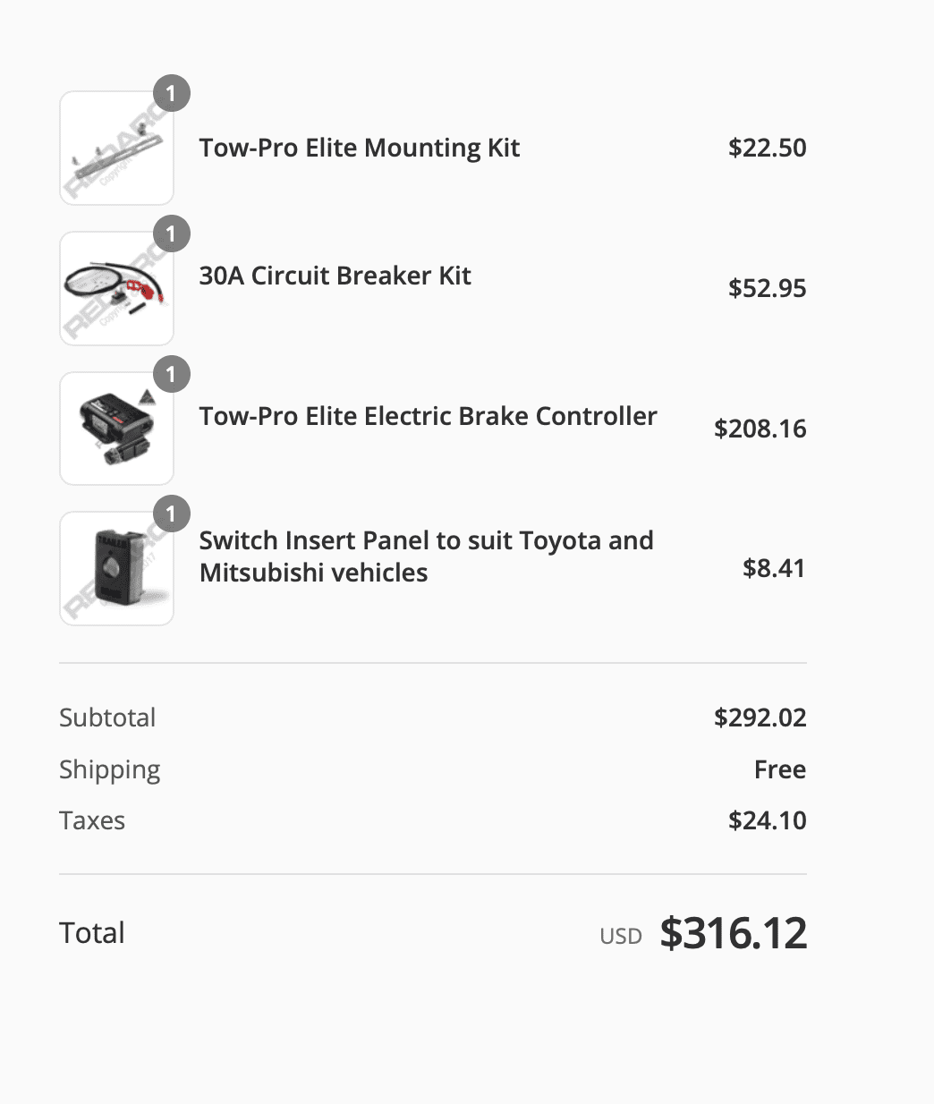

I ordered everything from Redarc - screenshot of my order confirmation attached. This is the only brake controller I've ever had so I have nothing to compare it to, but it is awesome. The proportional adjust feature lets you dial in how much braking you want in the trailer and you can dial it in however you want.

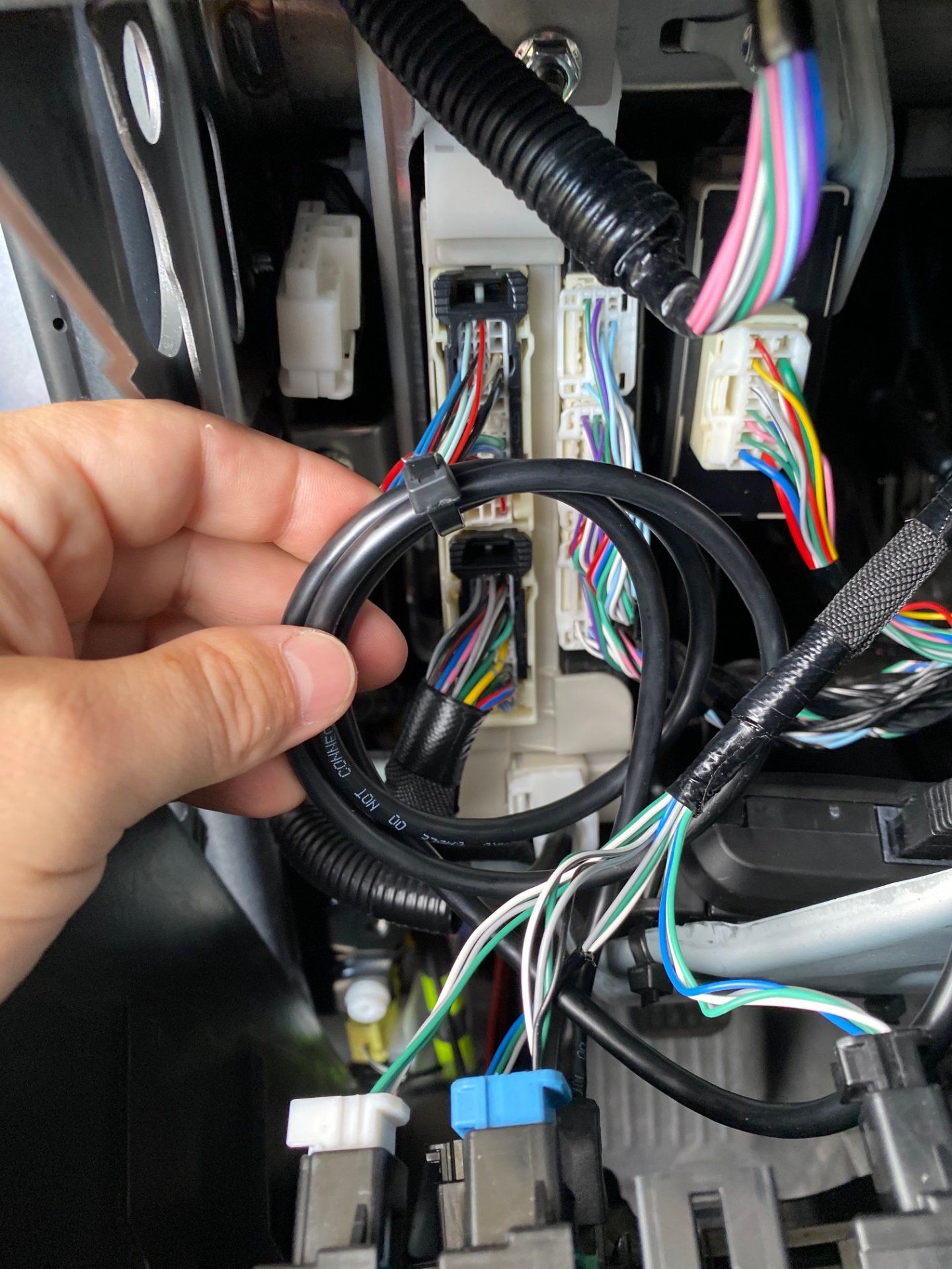

I already had the Lexus pig tail (was in a bag in my glove box).
Make sure you wire and out it exactly as Redarc install instructions state.

Sorry to revive an old topic. Did you need to install the 30A breaker kit? Redarc states it's for 3 axle setups, which is way above any weight these vehicles could tow... I'm finding myself in a bind and might need to accomplish this job quickly...like overnight all the parts quick
I did’t install any breaker kit with the Tow Pro Elite I installed. Just the Tow Pro Elite and the pigtail I got from them for a no cut install. Super easy to do. Unfortunately, the first one I got was defective and after one trip it wouldn’t stay calibrated which means it wouldn’t work. Emailed their customer service and they asked me a few questions. Based on those answers they determined it was defective and, not only sent me another one at no charge, but also a newer version that had come out since I had bought mine. It has worked flawlessly. I also have a Prodigy P3 in my wife’s Tundra. It works fine but I will likely never buy anything other than Redarc going forward if I need another brake controller.
