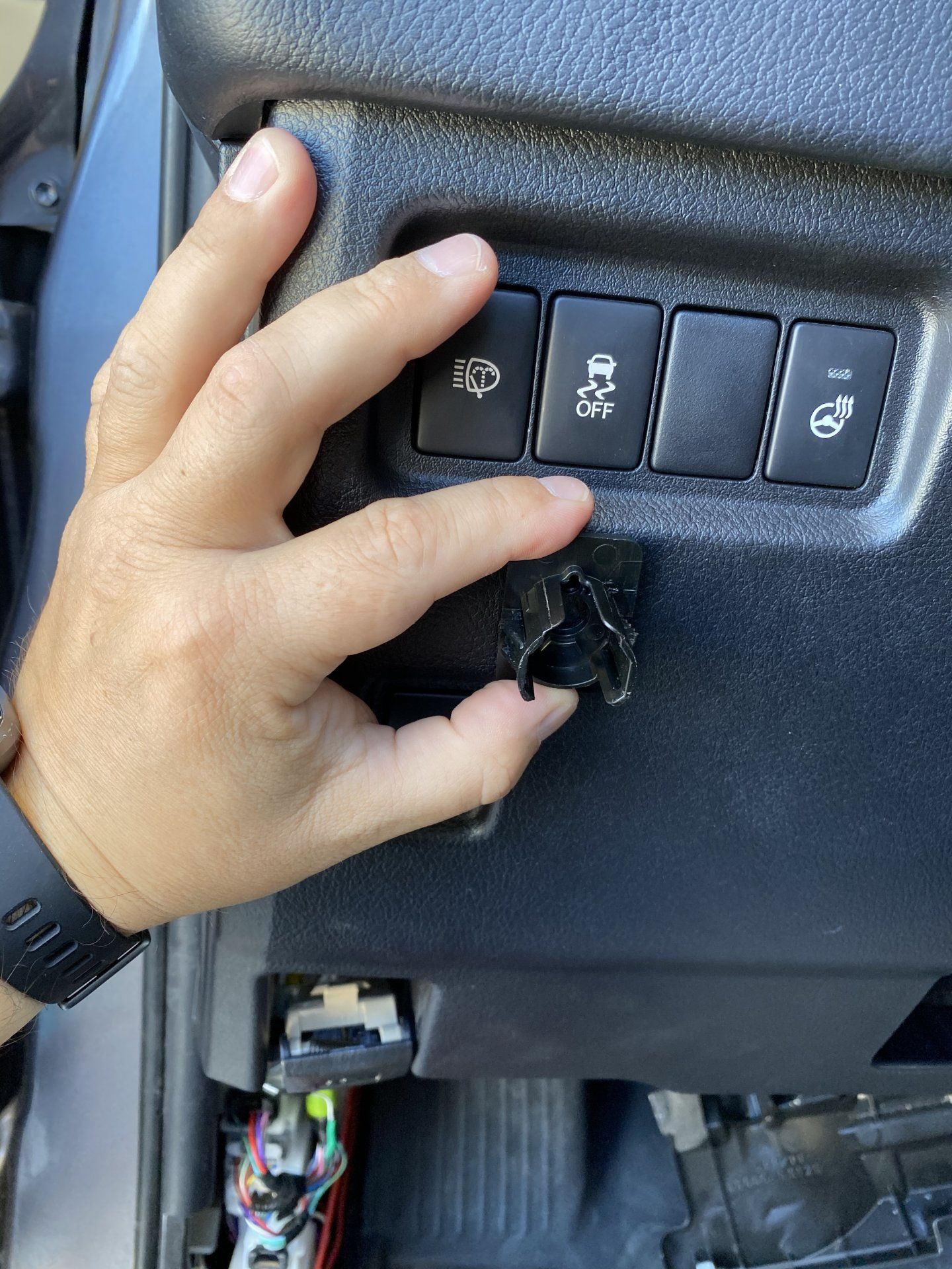

That wasn’t the kick board area. Just below the other switches.
Wow, that would have been nice! I ordered mine directly from redarc. Something must have changed in those couple years. Mine is a 2018 Luxury. The blank was wide enough interfere with the other two switches if I remember correctly.
Brake controller works great... Glad I spent the extra money. We use both modes a lot around there with the mountains.
I ordered everything from Redarc - screenshot of my order confirmation attached. This is the only brake controller I've ever had so I have nothing to compare it to, but it is awesome. The proportional adjust feature lets you dial in how much braking you want in the trailer and you can dial it in however you want.
I already had the Lexus pig tail (was in a bag in my glove box).
Make sure you wire and out it exactly as Redarc install instructions state.
