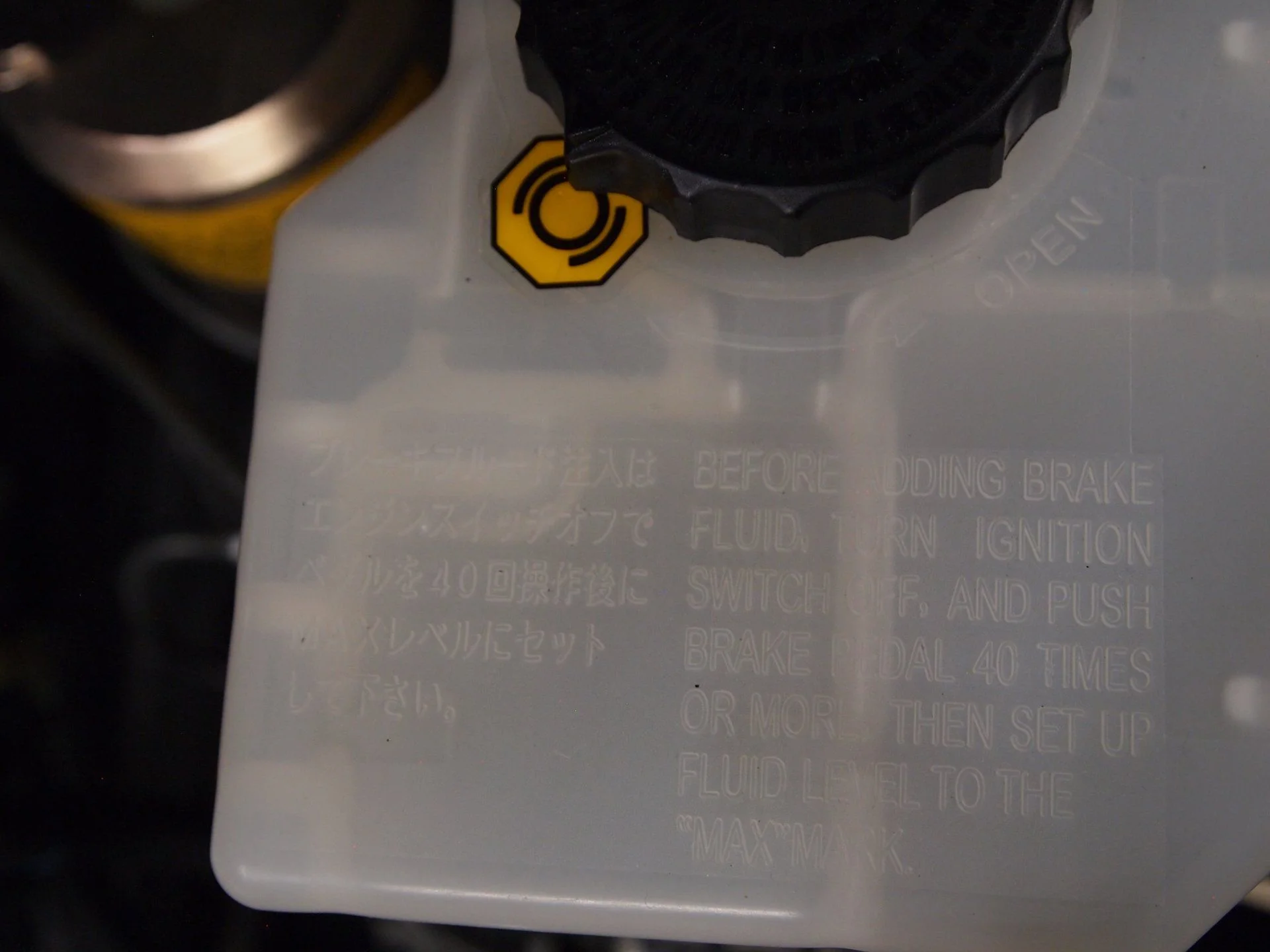

Make sure you read what is printed on top of the brake reservoir. It tells how to check fluid level.

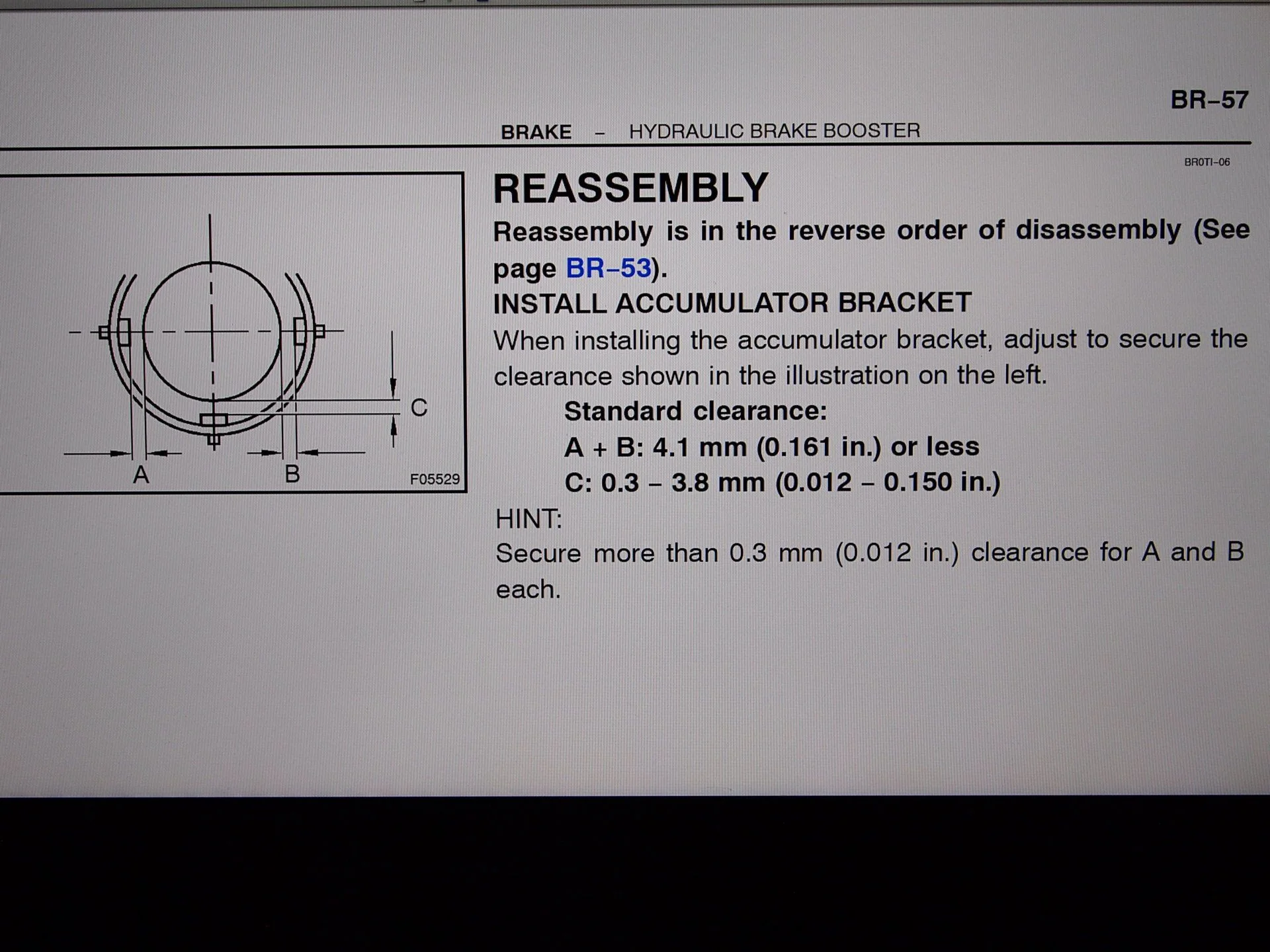

This out of adjustment will give loud and unusually sound.

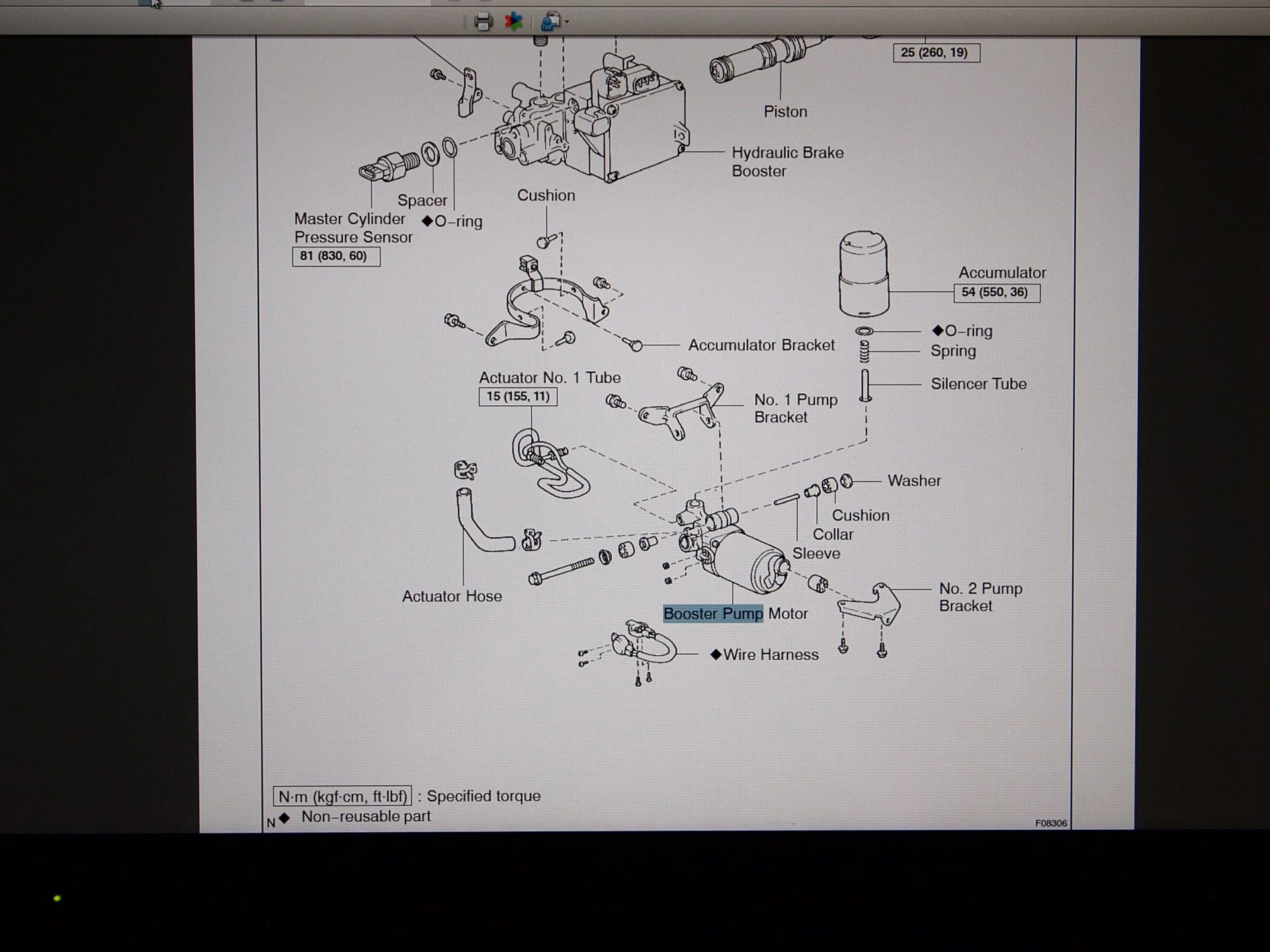

The booster pump comes on, pretty much anytime your foot hits the brake peddle. It and the pump makes sounds as any pump and motor will when it's on. If the accumulator bracket (cage) is out of adjustment, wherein one bumper of cage touches accumulator in will make unusual sound as motor runs.
There is a little piece (coupler) that goes between booster motor and pump, that must be seated properly during assemble if motor is separated from pump. I suppose there is a remote chance if not properly seated, motor may turn pump and make unusual sound. But this is highly unlikely.
Here you two couplers (one on lying on white towel one in motor), only one is actually used between motor and pump.

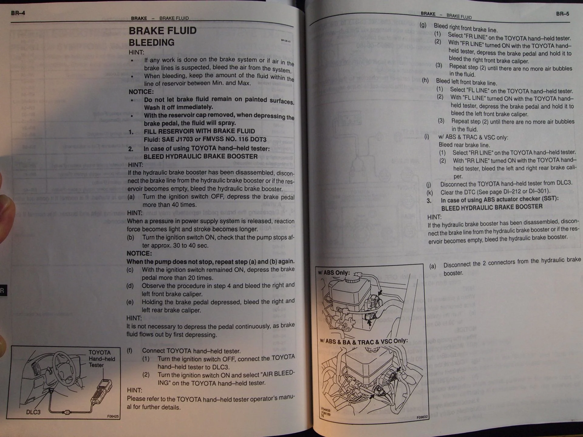

On reservoir print is embossed that tells how to properly fill (Before Adding Brake Fluid) the reservoir by pump peddle 40 times IG (key) off. Once topped to max turn on IG and time how long you hear booster run. Spec (as you can see in FSM) is 30 to 40 seconds.
