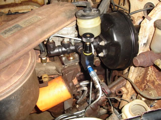

When I had my '66 FJ40 I did just this. used brake booster, master and front outer spindles and brake equipment from an '82 4x pick up. Worked great!
Used all the parts including the factory aluminium spacer. Does require a prop valve for the rear lines. Your brake pedal will be too close to the floor/firewall. Either use a later '40 pedal or I cut and shaped my original pedal.
You'll love the new stopping power.

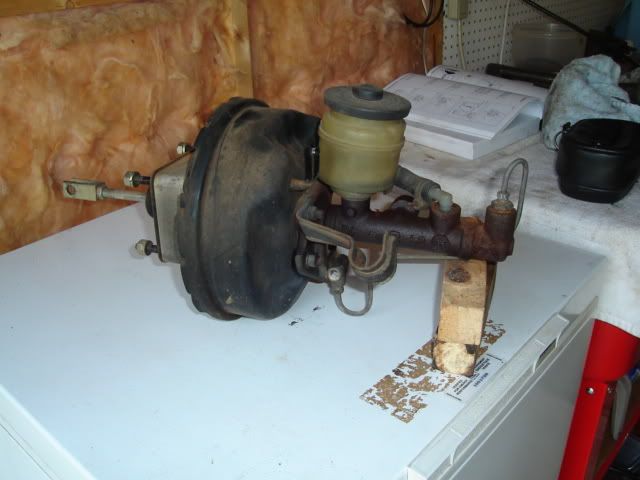

Okay so the best I can measure with a tape and the booster on the LC is about 8.25 +/- .... Best I can remember the first gen truck that I got it from was a round head light truck so 79 - 81 I think?

I did that same mod on my 40. You can use any toyota 8" booster get the spacer and check valve. You will need to cut about 1/4 " off the booster shaft maybe a bit less (measure twice cut once) and your good to go
