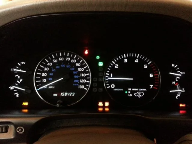

Drove to dinner with parents in the LX. When got out from dinner the truck started with the ABS, BRAKE, VSC, ATAC lights came on with the dreaded long beep. Tried to start it again after removing battery same thing. I tried to drive the truck out of the parking lot but I lost braking power COMPLETELY before I even got to the first stop sign. All stop!
So I pulled over and called for a AAA tow to the Lexus dealer I'm familiar with. The next morning I got a call from the service adviser saying the brake booster needs replacement and will cost about $3000+ tax. OMG! My heart sunk!
About 30 minutes later, I got another call from him telling me the truck is fine now and there wasn't any problem after the tech drove it and resetting all the codes. I picked up the truck and came out with a $0 balance.
So I am just wondering now... what is the chances it will happen again? Should I be concern now since this started happening? What can I do as a preventive maintenance if I want to keep the truck for another 5-10 years? :rolleyes:

Well it happened again. Luckily it happened very close to home and I was able to limp back to the garage.
Started a case with Lexus Cust Satisfaction. They are not going to offer me anything saying the car is old and has 150k miles on it. So I told them I feel this is a 6000 pounds ticking time bomb waiting to happen and she said I have to ask my service adviser about it as they have no idea about mechanical issue with the vehicle.
So the bottom line is, should I fix it? Dealer quoted $3300 + tax! One year warranty on the part... How many more miles can I get out of it?
Also I've looked at the 200 series too and it seems like they have the same integrated design also. Which is really scary as if there is a blown fuse for that part then the whole vehicle will lose the braking power completely. For such a large vehicle I think it is an unnecessarily integrated and expensive part.
