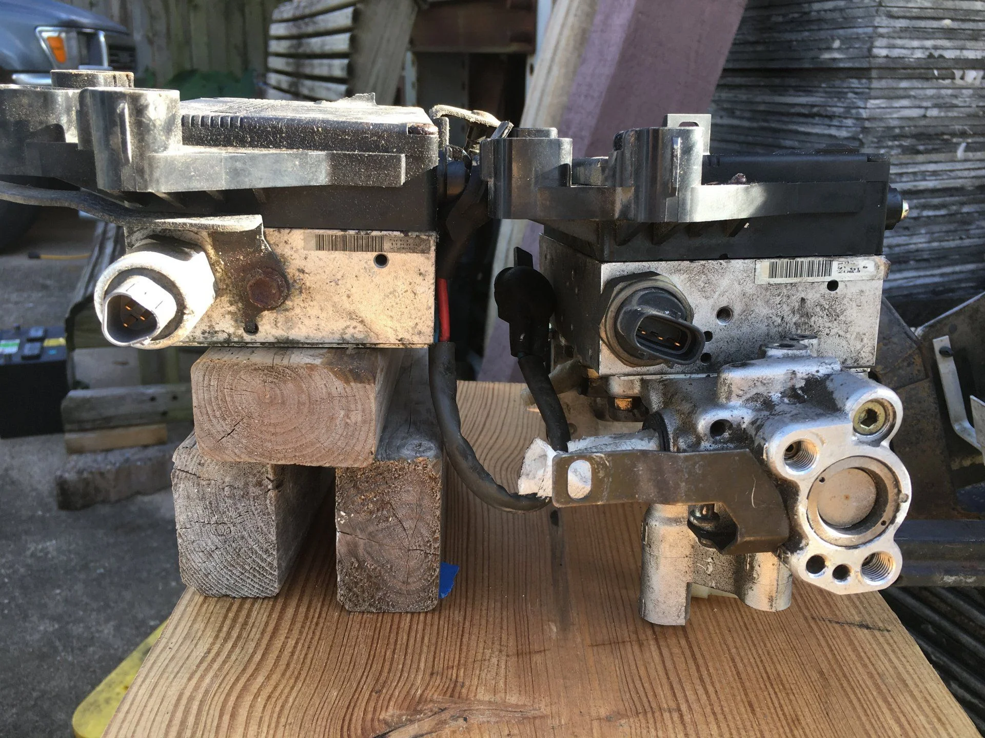

For the year 2000 you need to be very careful and have the proper brake MC assembly verified against your VIN. There were changes to the MC mid 2000 and if you get the wrong one it will NOT work in your application. Either consult with your dealership parts department about verifying the proper part number with your VIN or use on line services such as partsouq.com that can do VIN based part searches. The most obvious difference on the two MC versions is the shape of the connector on the front of ABS valve body. One version is triangular and the other is oval. See photo below that shows the to different styles of connector on the ABS valve body that came on year 2000 LC/LX master cylinders.
