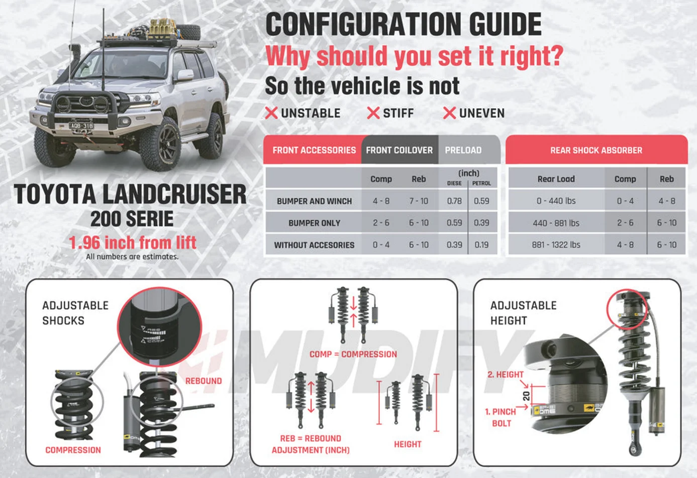

Found this today. Best all-in-one view I've seen yet.
(also, 290PSI nitrogen top-off for best and most consistent performance)

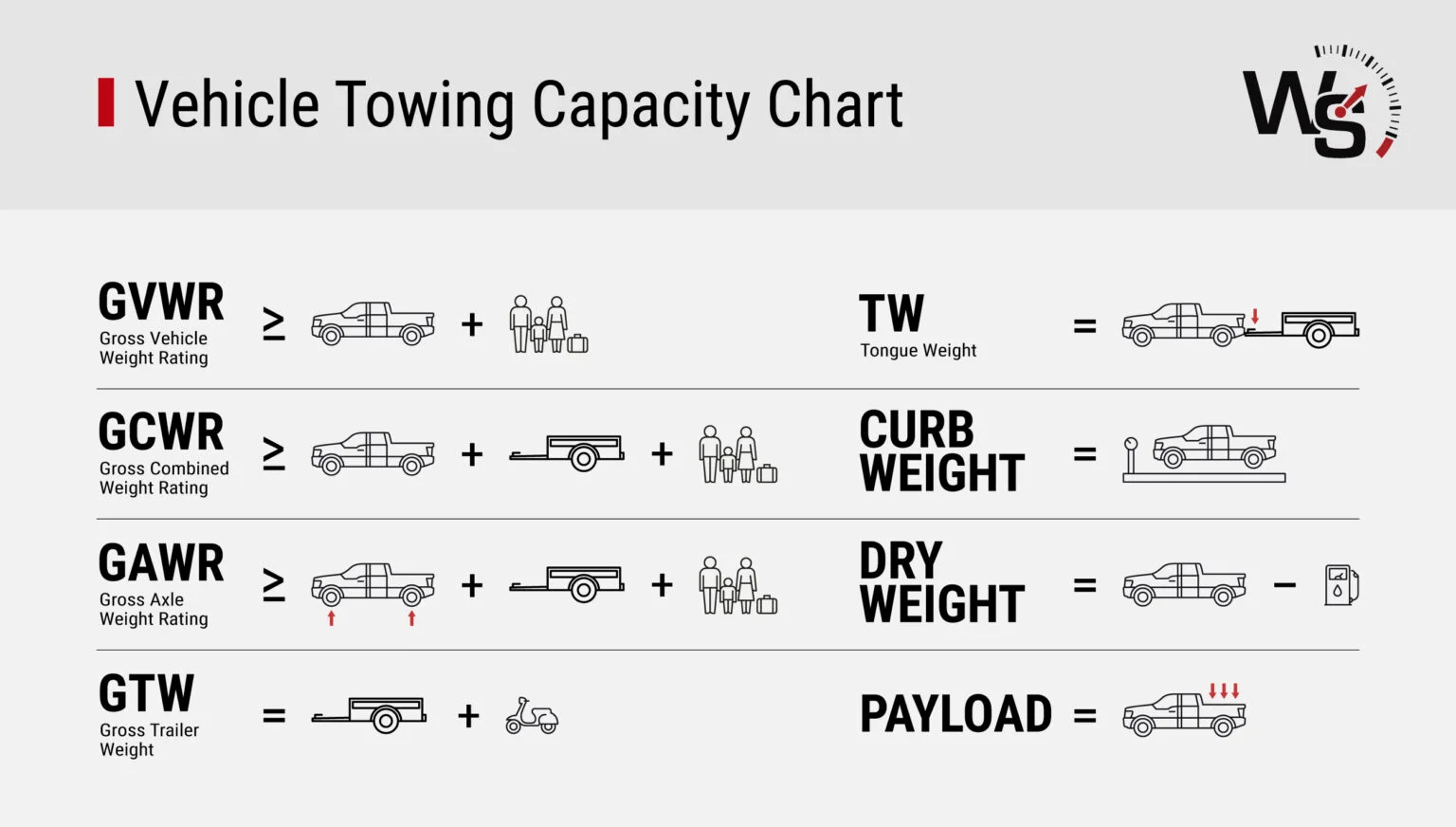

This is very handy but one, possibly dumb, question I have is how are we to determine the load amount? I’m working on my rears and I feel like I’m on the heavier side and plan on weighing my rear axle with a trailer tongue scale. I assume I want to subtract empty vehicle weight to come up with the rest load but I have no clue what that is.
I *think* the calculation goes something like this:
[Observed axle weight (scale)] minus [GAWR weight (sticker)] equals [how much you are over].
Use this amount to select the springs that provide the appropriate amount of capacity for your rig (e.g., 400/800/etc.). This is not always perfect: if you are 250lb over, a 400lb spring set may be too springy. That same set might feel just right when you add the TW of your trailer. I assume that a similar calculation is useful for the trailer, as well, depending on how much stuff people load up. (I don't think you always have to use a Vespa to calculate GTW)
I don't tow much, so have never extended the calculation to add towing needs for myself. But, pic related. (sauce: What Is Gross Vehicle Weight Rating? | GVWR | Weigh Safe - https://www.weigh-safe.com/towing-safety/what-is-your-gross-vehicle-weight-rating-or-gvwr/)
