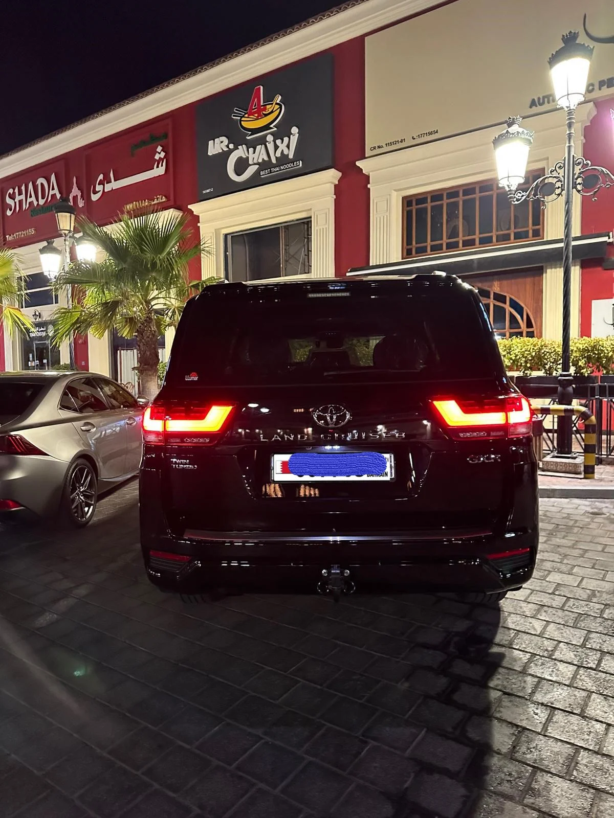

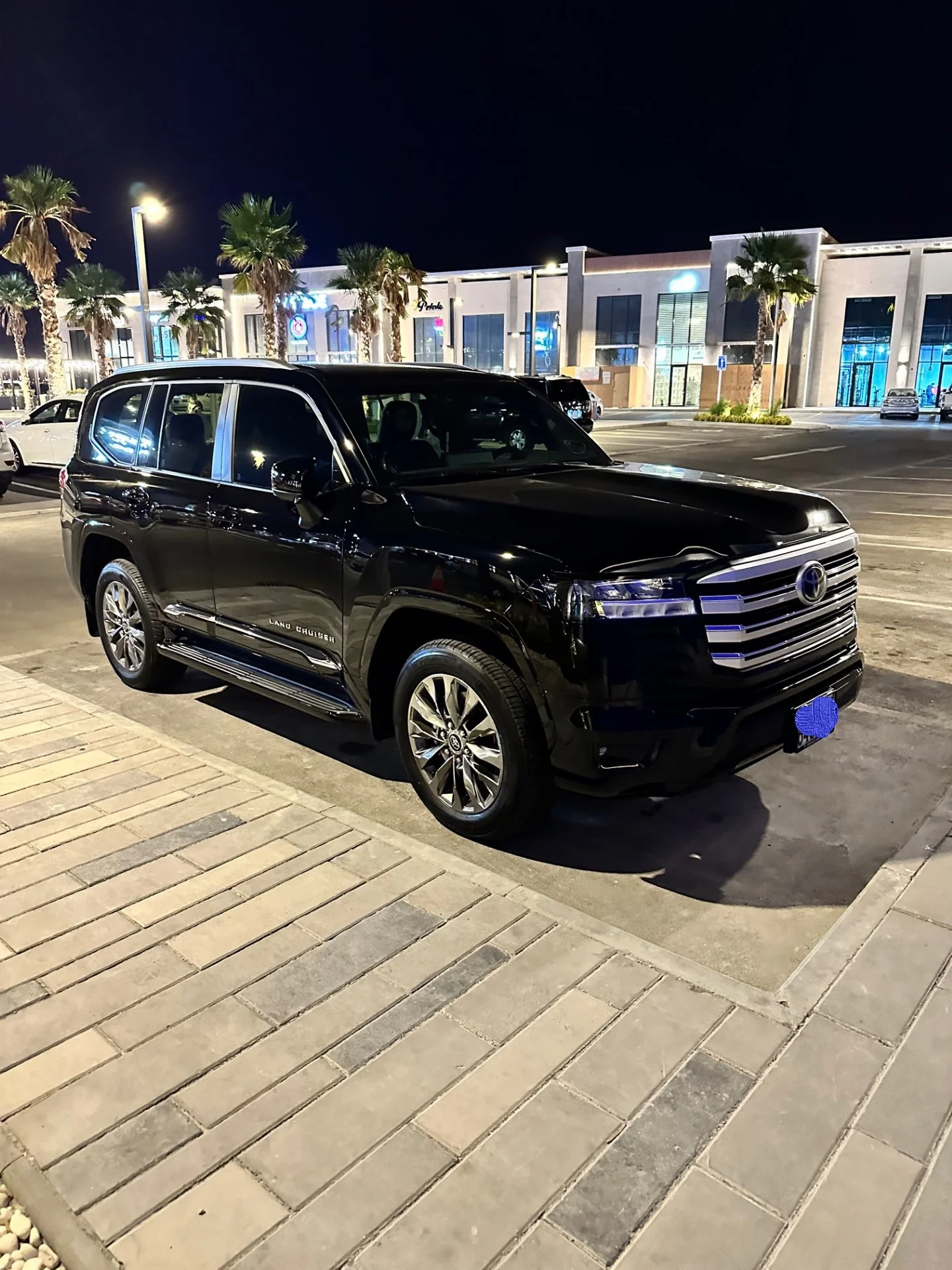

Hi Guys,
I recently purchased my dream car, a GXR trim with a 3.5L petrol engine (Middle Eeast. I am very happy with it and how it drives. However, I have a few questions that I would love to hear your thoughts on.
  • Fuel consumption: My first full tank of gas only got me 650 kilometers, which is less than the theoretical range of 1,000 kilometers. Do you think the fuel consumption will decrease as the engine breaks in and after I change to 10k oil after driving 1,000 kilometers?
  • Engine warm-up: I live in a hot climate (40 degrees Celsius or 105 degrees Fahrenheit), but my car still takes a long time to warm up. Is it normal to have to wait 5 minutes for the engine to warm up, especially considering that I have only driven the car 850 kilometers so far?
  • Headlights: I am considering upgrading to the full option VXR (ZX in some countries) LED headlights. The only place I can find them is on Aliexpress, but I am skeptical about the quality of the headlights from that website. Have you or anyone you know upgraded to these headlights? If so, would you recommend them?
I look forward to hearing your thoughts.
Beautiful vehicle. Congratulations!

First of all, congratulations.. The back mica is always my preferred colour choice and it feels more natural than other colours

For the headlights, I won't recommend going for the VXR units as it won't be a straight plug and play and a lot of wiring work needs to be done. but if you insist on going that root, you might consider the VX variant as the GCC sepc of that model doesn't include the adaptive high beam system which might make things easier to retrofit. Also, be mindful that going this root is going to cost a lot...If you are only going for the aesthetics, you might consider the after market options but i doubt if they would perform better than OEM. What really suck about the LC300 is that the LED lights are integrated within the main headlight housing. Hence, in case the LED fails, you will have to replace the whole assembly.. not to also mention that this will kill off the ability to do lights upgrades. I would suggest that you keep the OEM for couple of years until the after market gets more matured. Probably by then, someone would have figured out a way to replace the embedded LEDs as well if you are after that
