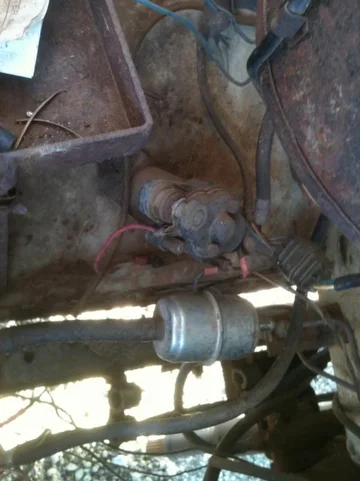

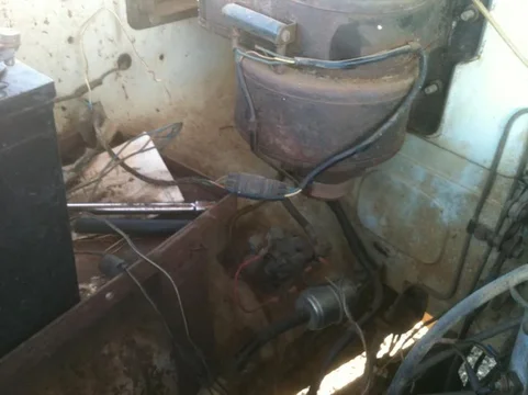

Any ideas what the electrical component next to the fuel filter is? It has a rather large negative lead coming off it which looks kinda important... It doesn't help that the negative post on the battery still has the clamp with no wires attached...

PabloCruise said:
I am not sure!
Did it have a winch or plow on it that you can tell?
Not that I can tell. I'll trace the wires and see if it connects to anything with the positive wire. Also while working on it today I think I spied power steering. I'll post a pic tomorrow and maybe someone can help me figure out what it came off of.
It looks like some odd combination of an old ceramic insulator and the back of a dimmer switch.

Might be some kind of selonoid for an auxilary tank switch

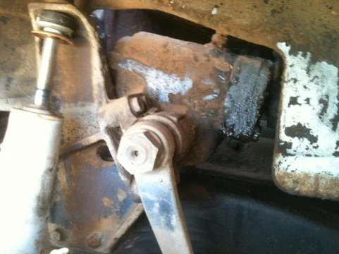

Followed the wires from the unknown electrical component and of course they're cut. They went through the firewall into the cab but didn't see anything with the same black/white wires. Posted a few pics of the power steering. Any ideas what it's from? I'm wondering how to tell of my axel is 55 or not since it has power steering and discs.

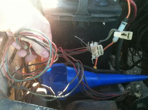

Also, found a nicely wrapped and tied group of wires tucked under the horns. They run forward behind the battery toward the front. Any ideas what they should plug into?
I don't see any lines running to that steering box?
Am I missing seeing them?
That is location of 55 box, so if it is PS, maybe the PO installed 40 or 55 PS from '79 or later.
Can you post a pic of the lockouts used on the front axle hubs? It may be that you have a later 55 or 40 front axle on there w/ discs.
40 & 55 front axles are interchangeable.
