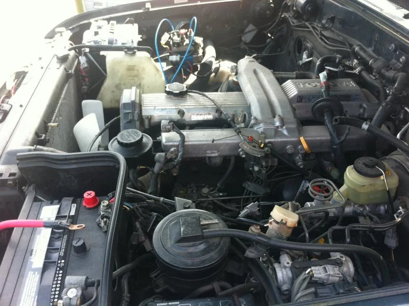

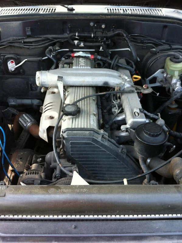

Here’s a little story of mine, about how I stumbled into a fortunate situation, perhaps a once in a lifetime moment.
I was at the local cruiser shop a few weeks ago getting an engine mount swapped out (I didn’t want to risk my fingers, I’d rather they theirs!) and I off-handedly mentioned that I was interested in switching over to an 80 and eventually doing a diesel swap. The mechanic stopped what he was doing, walked over to the door and pointed out to the lot and proceeded to inform me of an interesting situation they were in with another owner. Wouldn’t you know it, there was a guy who was having them do the work for that very same thing over the course of the past 4 years. They were nearly complete when he decided he wanted to pull the plug and just get rid of the thing for a song (I won’t even say what I just paid for it, I don’t want anyone to hate me) and would I like to take a look? Why, yes. Yes I would.
Here’s what I found.
-1996 FZJ80 in decent shape except for the fact that it’s been sitting for 4 years and has moss or algae growing everywhere! Thanks for that, Portland.
-1HZ engine, which I’m told came from Outback Imports and was in good operating order before it made its way stateside. I’m planning to call Jesse tomorrow to confirm all of this.
-A442F, hydraulic out of Australia, rebuilt, also from Outback Imports. Again, I’m calling Jesse to confirm this and ask if it has the Extreme VB as I have a hunch it does.
-ARB lockers, front and rear
-ARB rear bumper, but no tire or jerry can carrier
-A whole mess of other random mods that I’m sure I’ll be sorting out for months.
So, the real challenge is going to take up someone else’s project when it’s most of the way through but has lots of loose ends. The shop hasn’t touched it in a year or two so their recollection of details is scant, and I’ve been a FJ60/3B owner for the last few years so the 80 stuff is completely foreign and seemingly much more complicated electrically. I’ve been doing extensive research on this particular swap and am still sorting out what I might need to source or mod and will be meeting up with the shop guys for an hour or two to review early next week. To my knowledge all that remains to be installed is the coolant plumbing, air intake, drive shafts, and quite a bit of wiring. Well, as much wiring as these engines have. So for now, I guess I just have a couple questions if anyone’s listening and/or knowledgeable.
Given that it’s a 1HZ with a manuf. date of 4/94, is it still the same simple electrics that I read the 93’s and lower have? Will the OBD II ever work with this combo?
Mated to a hydraulic A442, does anyone have any sense of how the wiring will go? My guess is that this will be fairly simple with the only items in question being the “Power” and “2nd” switches.
What gauges do I need to change? Tacho obviously, but anything else? Does the whole cluster need to go? Since it had an A343 originally, was this electric and not a cable? Am I looking at a complete rats nest? In which case I think I’ll just call G&S. ;p
If you made it this far, I might as well share some photos. I’m sure folks such as yourself can see a diamond in the rough. :cheers:

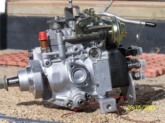

Fuel cut solenoid is on the pump. I can see yours ,it has a green wire coming off it like mine.You can test by applying 12v and listening for the click.
H20 sender? Do you mean coolant sensor? I just plugged my old 3F wire to the 1HZ and it worked fine .
There are at least 2 other sensors that adjust the glow time to the engine temp.
Fuel filter sensor requires the dash light that comes with diesels.Im sure there is a way of rigging something up to alert you of water.
The ASCD is a legal(smog) requirement in some countries and will not affect the engine if you dont have one.
HAC were an option in oz I think and later became standard.You wont need one at sea level and you are right,its a location thing.
There are only 2 pumps AFAIK when it comes to the 1HZ and that is pre99 and post 99(the year will differ in other countries)
The newer one has 2 more teeth on the timing belt.
You can id the pump by the part number on the pump.
