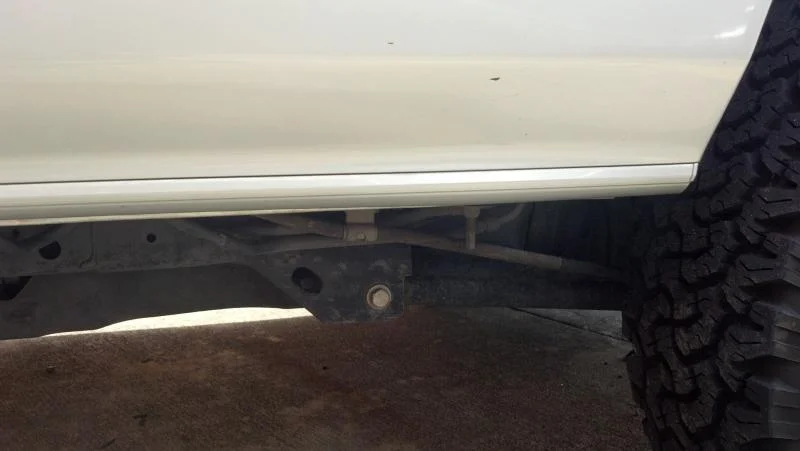

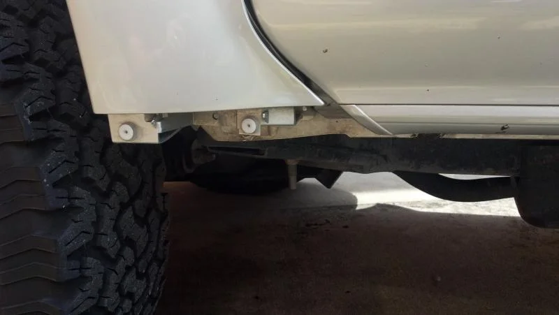

I love the look of your truck with the lift. I was just wondering, after taking the running boards off, in one of your side shots...it looks like some stuff is hanging down a bit towards the back of the truck in front of the back wheel.
Do you have any issue with that? What is it exactly? Do you rub or bottom out on it? Thanks for the info.
I will not wheel my rig hard until I have my sliders on... As it sits nothing is hanging down other then some factory skid plates. That picture looks weird becauses you can't even see the frame rail. If I get a change I will take a closer up picture.

Better late than never...
First image is the left overs of the front mud flap being removed.
Second image shows the KDSS lines just down the frame a little bit.
Third is right past the KDSS and is the factory skid.

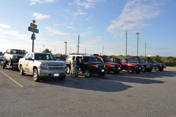

Correct me if I am wrong but isn't this your rig on the trailer in this picture? We were convoying to BVORR last year.
