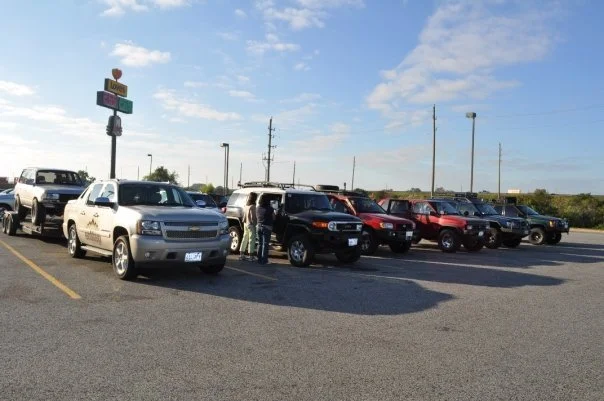

Correct me if I am wrong but isn't this your rig on the trailer in this picture? We were convoying to BVORR last year.
