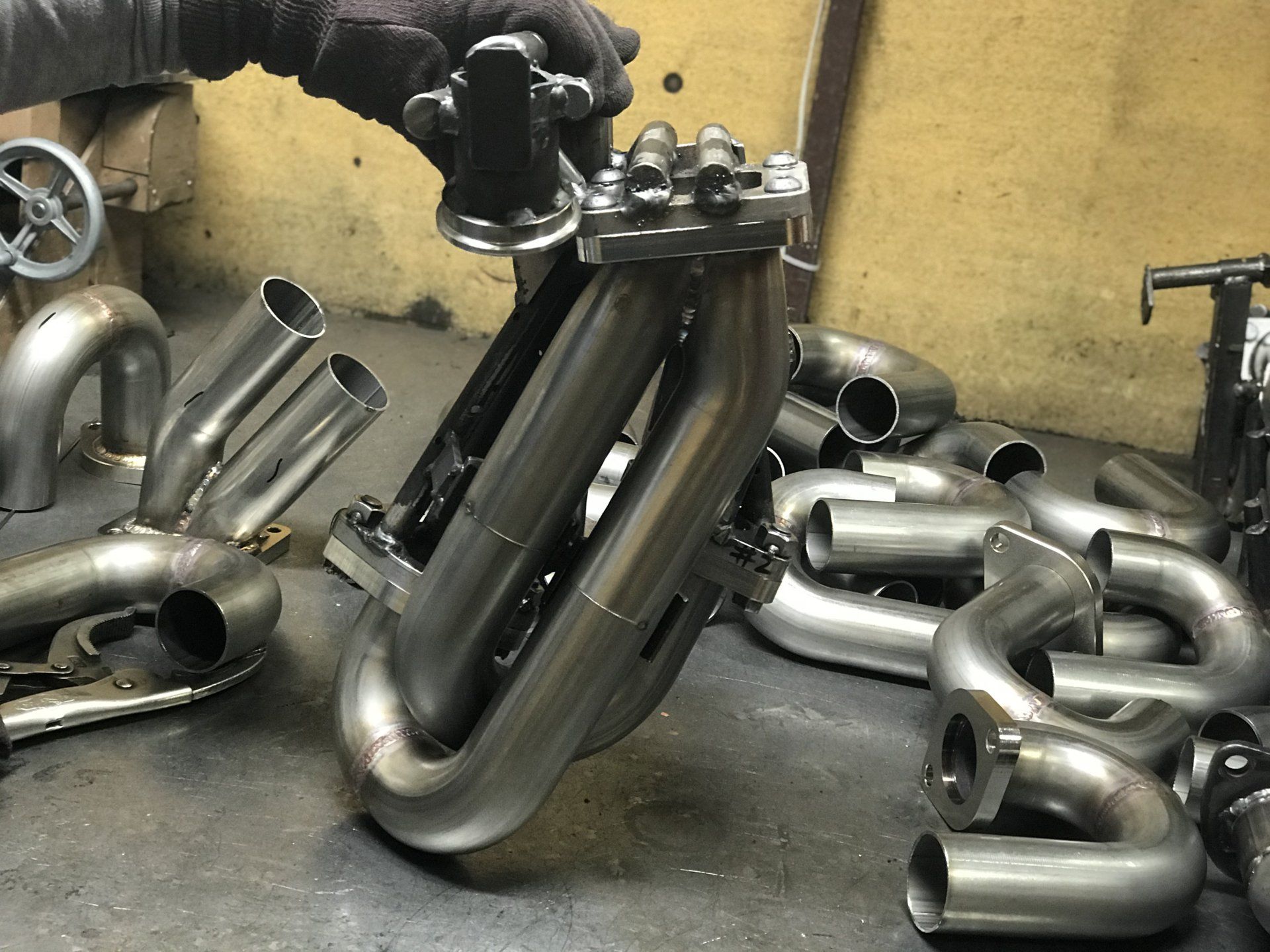

Ok a little bit of an update. I just got back from the J-Pipe manufacturer again after a few false starts and 4 changes. Unfortunately I had to leave for a doctor's appt that I couldn't miss but my first article will be ready later today. I will pick it up on Monday. I had a few changes to make in between the entire build out because they made a few changes I didn't like and then there were others we mutually agreed on. Initially the plan was to make the J-pipe collector further down from the T-4 flange but it proved to be pretty difficult AND since this was a single scroll turbo and not a single scroll, the collector really just needed to be somewhere before or at the T-4. So the design changed. Then I was going to have a balance bar before the T-4 for the wastegate but again, since this is a single scroll turbo it wasn't totally necessary and it could just be off one of the supply pipes pre-collector. Had this been a dual-scroll I would have changed the design.
The last change I made last week was to the Toyota exhaust flanges going to the exhaust manifold. The OEM setup had the pipe projecting past the flange and then domed slightly. Turns out this was for positioning the gasket and for centering the manifold to the Y-pipe. Initially they didn't include it because they didn't see it as necessary and because the pipe does go straight through the flange. Making it work would have meant redoing all the flanges with a slanted ID. Not worth it. I didn't like that. I wanted the pipe sticking out to give the same assembly aid. So they are cutting a 1/2" piece of tubing and tack welding it in place. Works for me. I also ordered the wrong number of Tial wastegate flanges so they can't finish them til I get the rest ordered. Doing that now.
On Monday I'll take some better pictures without the jig in place and then probably head over to SEMA Garage.

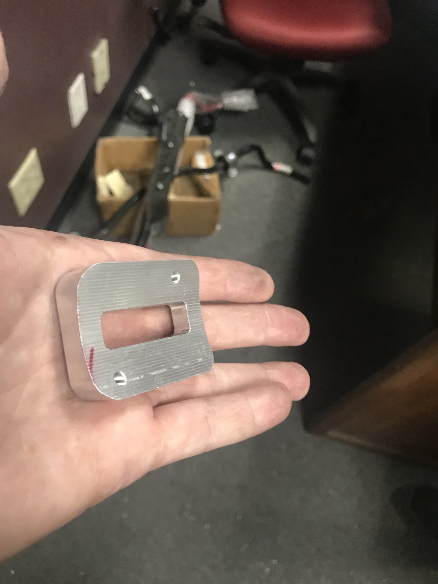

Looks great! So one other thing those flanges do is I think they prevent gasket blow out not usually an issue but kind of nice.
As for the MAF flange I think it would be silly to have it machined into the tube you would have to have a fairly large section of tube to start and machine a lot away. I used an almost identical weld-on flange when I did mine the first time and it worked very well.
