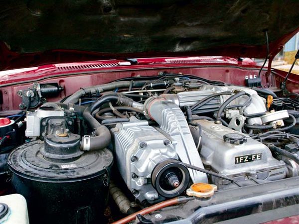

As a fellow 94 owner I understand the frustration, but after a lot of research it seems v8 is the way to go. Obd1 can't change parameter enough to compensate for forced induction from my understanding. So unless you're willing to build a standalone fuel injection system you're kinda sol.
I’m not frustrated, after Bob worked his magic my rig runs like new. I knew the cons of obd1 when I was looking for a 80 but I prefer everything about a 93-94 over 95-96. Yeah having obd2 would make things easier But a stand-alone like megasquirt fixes the issue. I asked just to see if someone had already made the effort.
I know few '93/'94 units have superchargers with some kind of Intercooler solution, so it can be done. CruiserDan has methanol injection in his '94 since the get go from what I can recall.
Oh it can be done for sure, I've saw a lot of talk of extra injectors. The prices on supercharger kits now really put a damper on that.
He did design it to work alongside the york OBA system. :)
