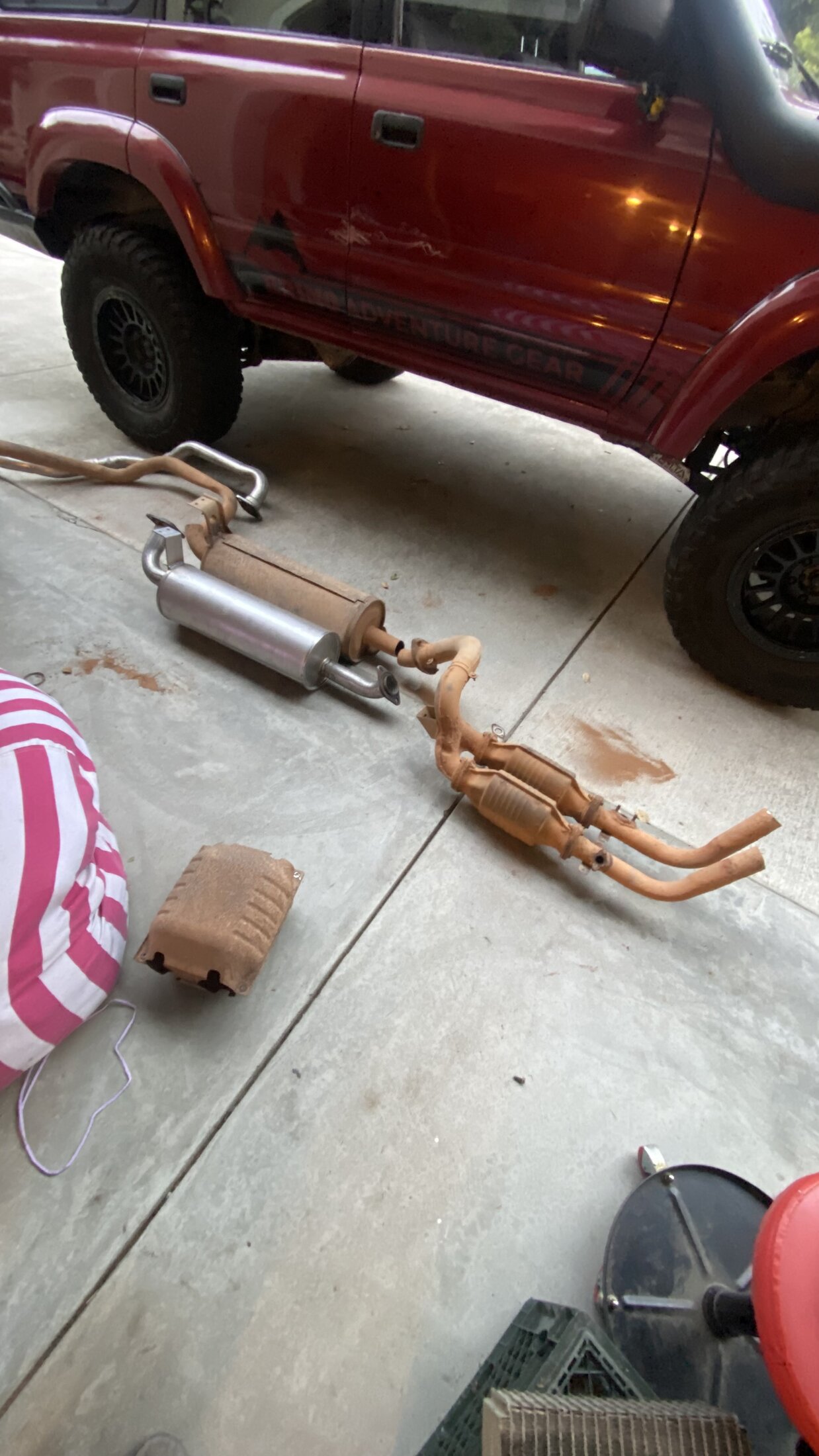

@Rifleman that’s good to hear you are still able to use the OG muffler. There definitely isn’t anything like the OEM build. Regarding aftermarket mufflers for the 93-94s, when I replaced my full exhaust system I used all OEM except for the muffler and tailpipe. I’ll try to find the number but the aftermarket muffler matched in size almost exactly. It is much lighter and I don’t doubt I’ll be replacing it quicker than OEM but so far it’s been very good, no drone.

@Rifleman that’s good to hear you are still able to use the OG muffler. There definitely isn’t anything like the OEM build. Regarding aftermarket mufflers for the 93-94s, when I replaced my full exhaust system I used all OEM except for the muffler and tailpipe. I’ll try to find the number but the aftermarket muffler matched in size almost exactly. It is much lighter and I don’t doubt I’ll be replacing it quicker than OEM but so far it’s been very good, no drone. View attachment 3806861

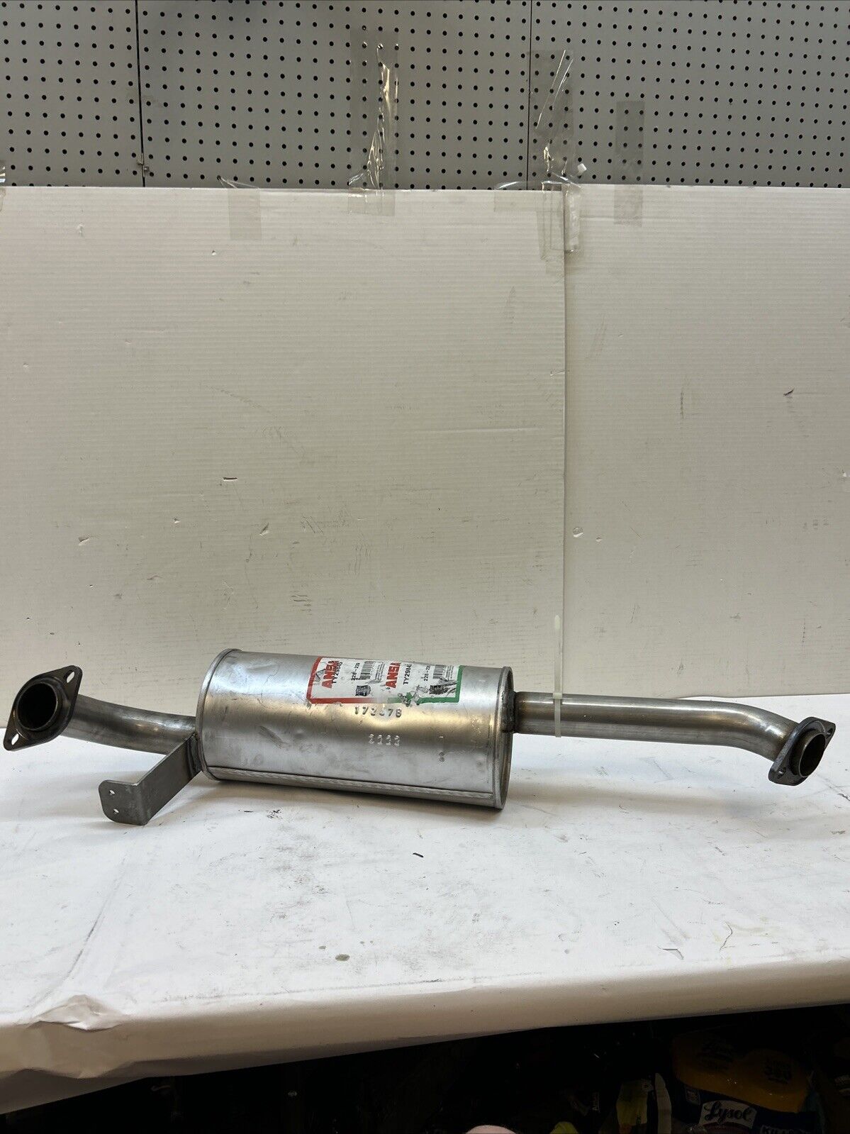

The funny thing is, all the spec's at online retailers say that the BRexhaust muffler is 22 1/2 inch's in OAL just like what your photo shows,
The muffler i ordered was from Summit Racing (order date of 12-20-2024) and got drop shipped directly from the Magaflow factory, and per Magaflows tech rep i spoke with, he said moving forward all their current production replacement mufflers for our trucks will now be 16 inch's in OAL,
All i can figure is this, by making the muffler body shorter it's a way for them to cut labor and steel cost on what must be a VERY limited market item for them,
So moving forward I'm sure some of the older/longer Brexhaust mufflers may still be sitting on the shelf at online vendors warehouses, but any new replacements ordered by them from Magaflow will now be the new shorter version,
