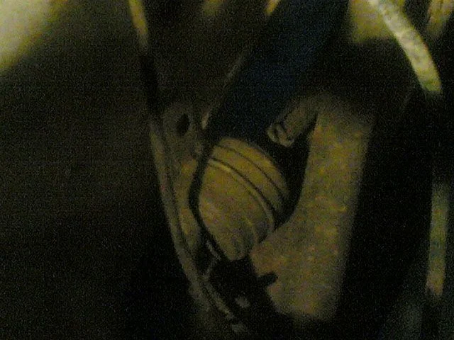

So, I think either it is the fuel filter or the fuel pump that might be going south. Has anyone had to replace the fuel pump on a 2F? I think the engine is a 78 or 79. Also, does anyone recognize this fuel filter? Is it even a fuel filter? Sorry for the crappy pic, I can snap a new one during daylight if it is unrecognizable:
Do you recognize that filter? it is resting on the passenger frame rail near the oil filter.
Is that a part I can get from NAPA or should I go with OEM stuff? Keep in mind I want to make the fix as cheap as possible to make sure that is the problem at hand. It doesn't look like those glass or metal bottomed fuel filters I've read about in the 40/55 forum.

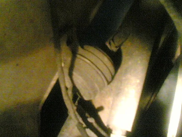

That's the fuel filter there in the picture.
Once when travelling, I developed fuel issues and limped it to a NAPA store. They were able to make a decent enough match to the OEM one in terms of the bends and such. I don't have the part # handy though... just bring the filter in there. After that, I was off like a rocket! Well... it ran better.

I just grabbed a metal in-line one, as it was one of the few that had the right size inlet/outlet and the right number of inlets/outlets and happened to put the lines in the somewhat similar orientation as before.
Now the problem seems exaggerated, like a true dirty filter where when you put on a little gas just sitting there and it dies.
Do you think the $2 filter is that bad? Could my gas be that dirty? I know, I know I should have grabbed a clear one.
apparently on some carbs their is also a fillter in the housing where the fuel inlet bolts on. Might be worth unscrewing the inlet and shining a torch in to have a look.
