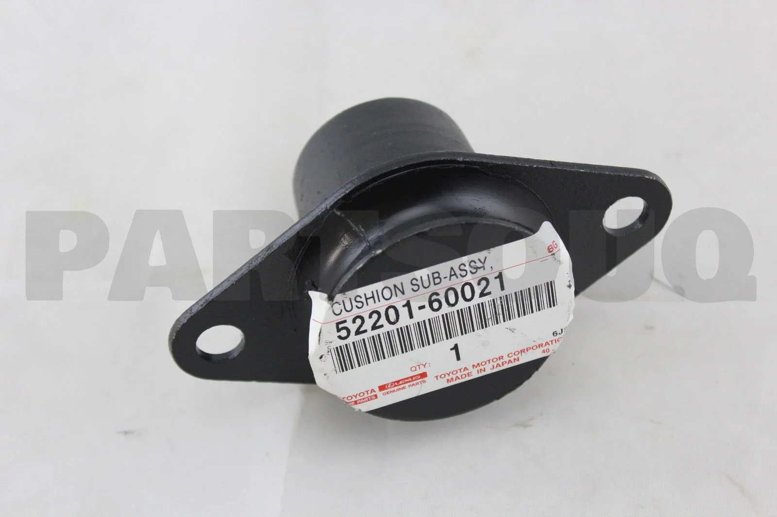

Very old thread, but bang on what I need to discuss. Does anyone have specifics on what parts I need to replace the front right body mount? OEM, not a lift. ToyoDIY.com
I believe I need this? (attached)
For install... loosen all mounts on the one side, jack body up a tiny bit to get the mount out? Anyone done this?

Apparently with an 80 aka LX450 (and probably the same with the 105 aka LX470) the two front-most mounts are impossible to replace without lifting the body as they are a fairly different design to the others (I think there are a total of five mounts each side?).
I have not attempted to source a complete set of new genuine parts (there are lots and Toyota doesn't supply body mounts in 'kits') but I see no reason to not fit genuine ones again if they're available. Body lift causes problems with other things and various juridictions have different rules on how much lift is considered legal.
