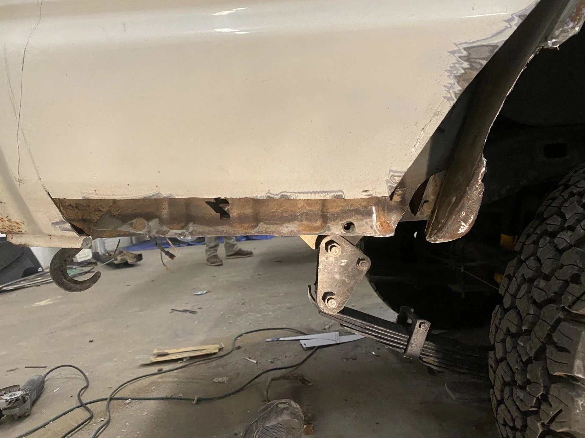

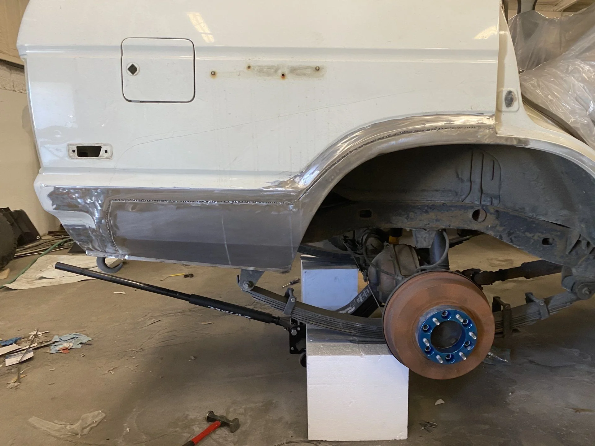

This 60 had rusty quarters, inner fenders and a fair-sized rust hole in the rocker panel. The vehicle is disassembled thoroughly, and bodywork is near completion.
The project:
1. Cut out rusted quarter panels, and rusted areas of inner fenders & tailgate.
2. Rebuild/fabricate new inner fender sections, weld in.
3. Cut quarter panels down to desired size, weld in.

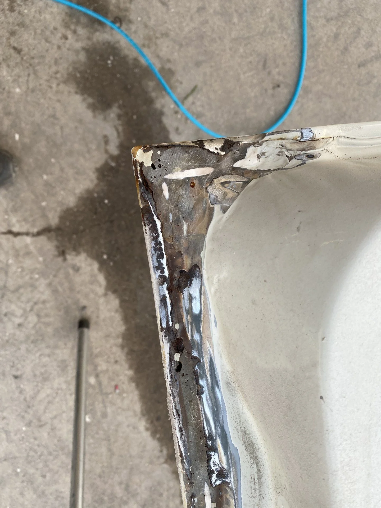

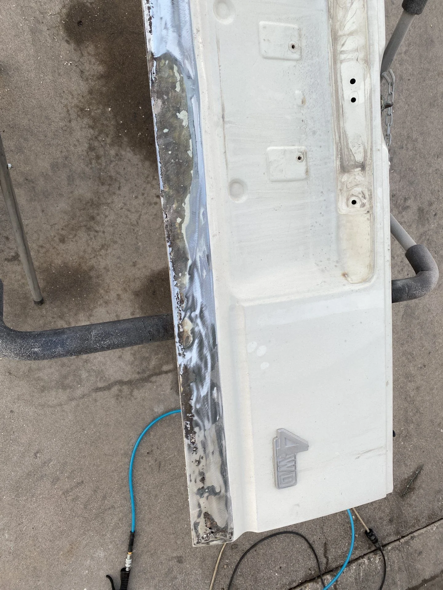

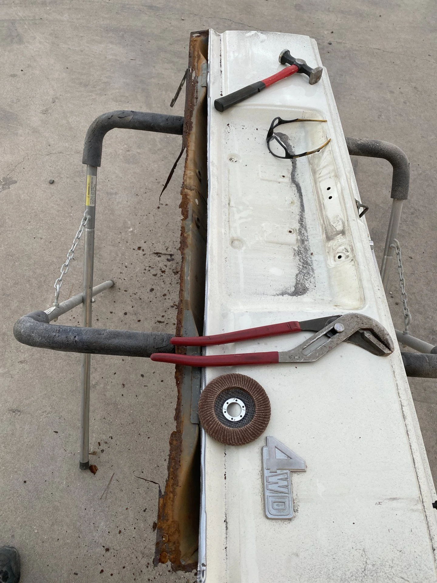

4. Replace tailgate.

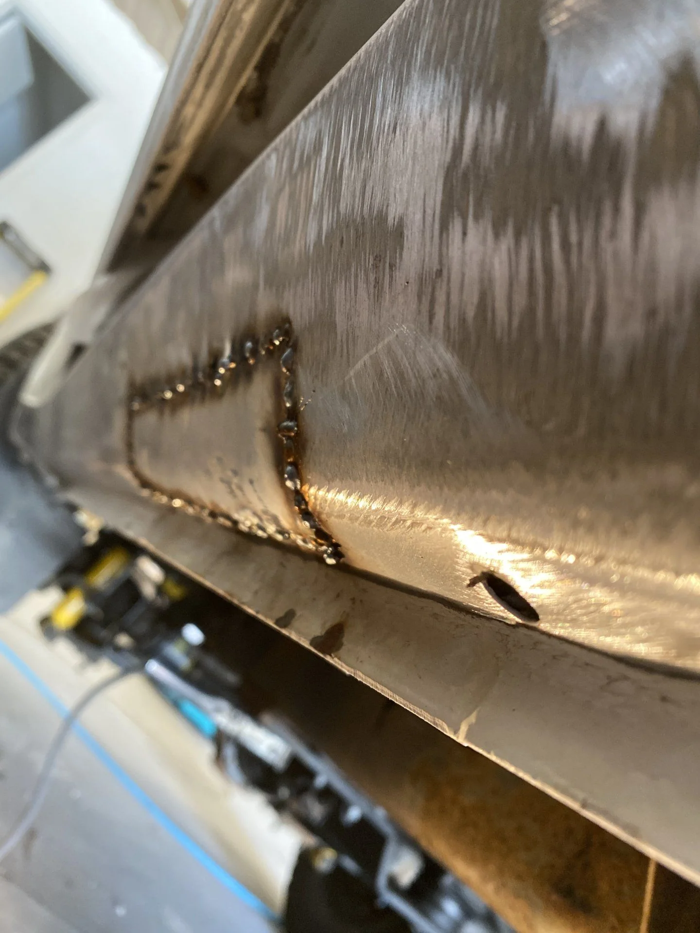

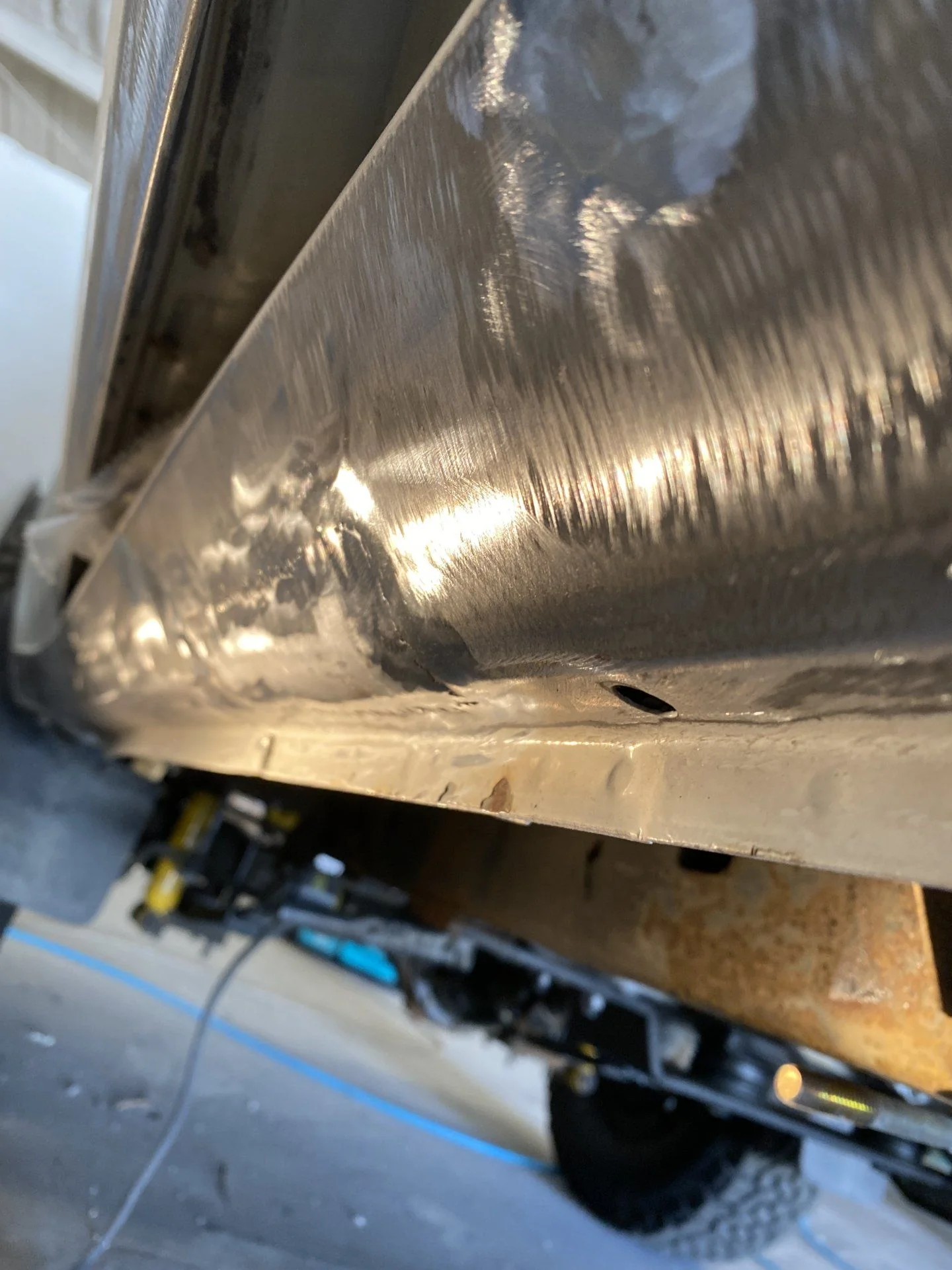

5. Repair rust hole in rocker, weld in new metal, fabricate to fit.
6. Weld closed all holes in rocker panels.
7. Remove seam sealer in roof gutters, and windshield area, repair any rust, seal again.
8. Remove seam sealer in lower doors, treat surface rust, new seam sealer and paint.

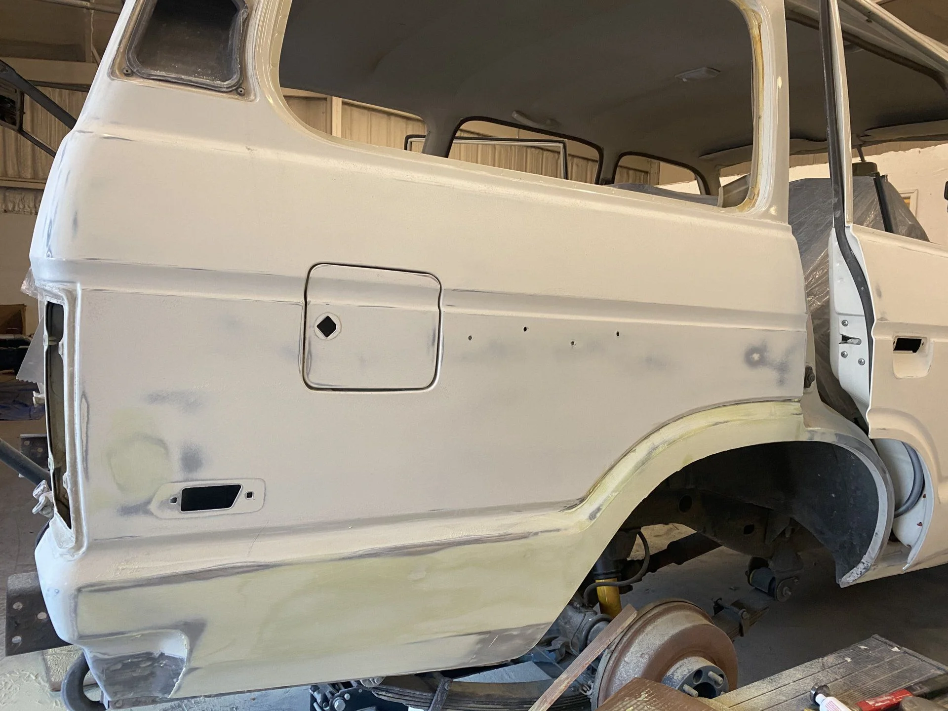

9. Fiberglass reinforced filler on all welds/seams, then filler.

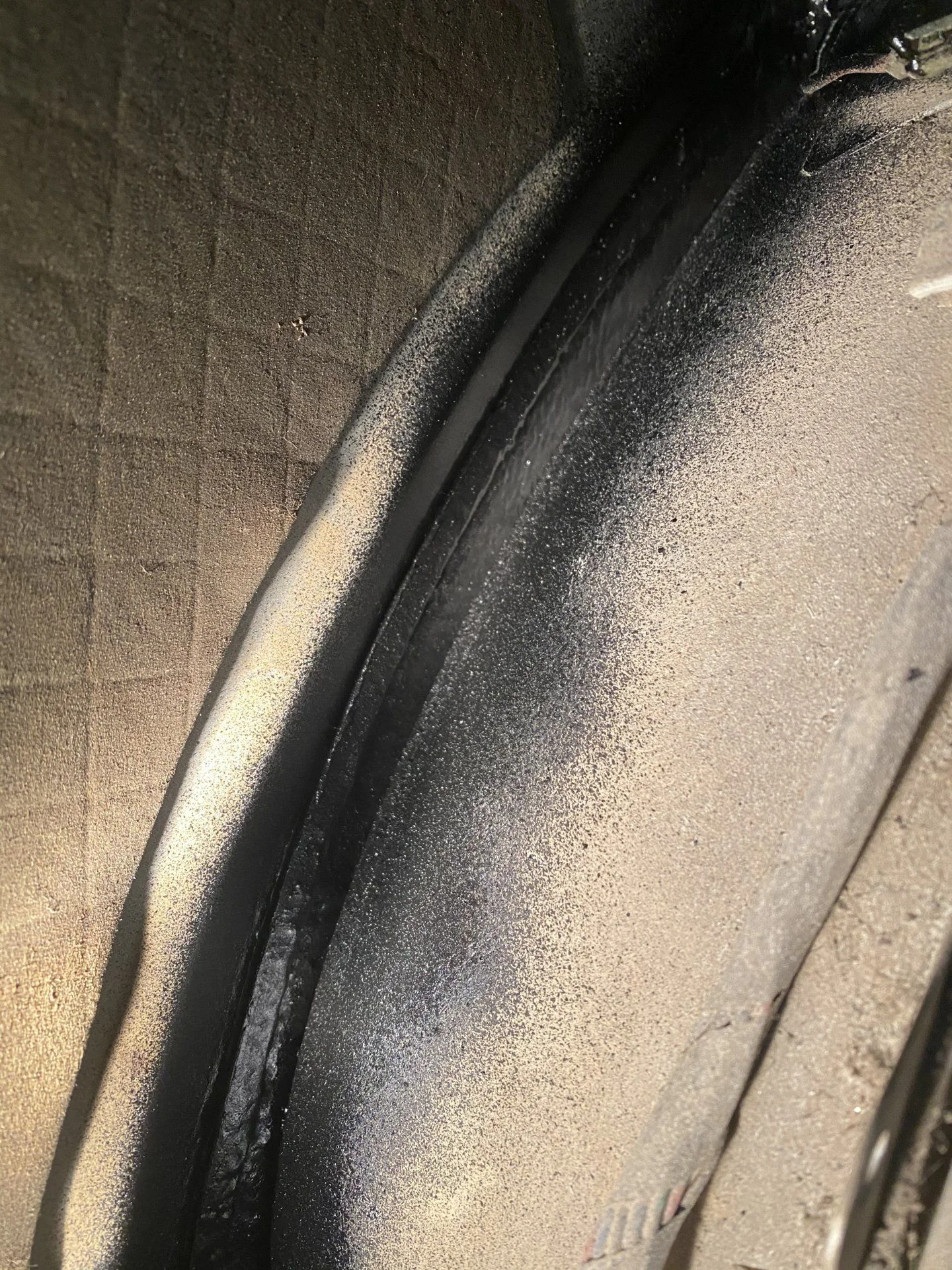

10. Rustproofing/sealer on all accessible, inner areas that were repaired.
11. Exterior paint, no jambs. wet sand, and polish.
Rear quarter panel replacement
Love this kind of work! Well done.
Nice work! Glad you are doing this.

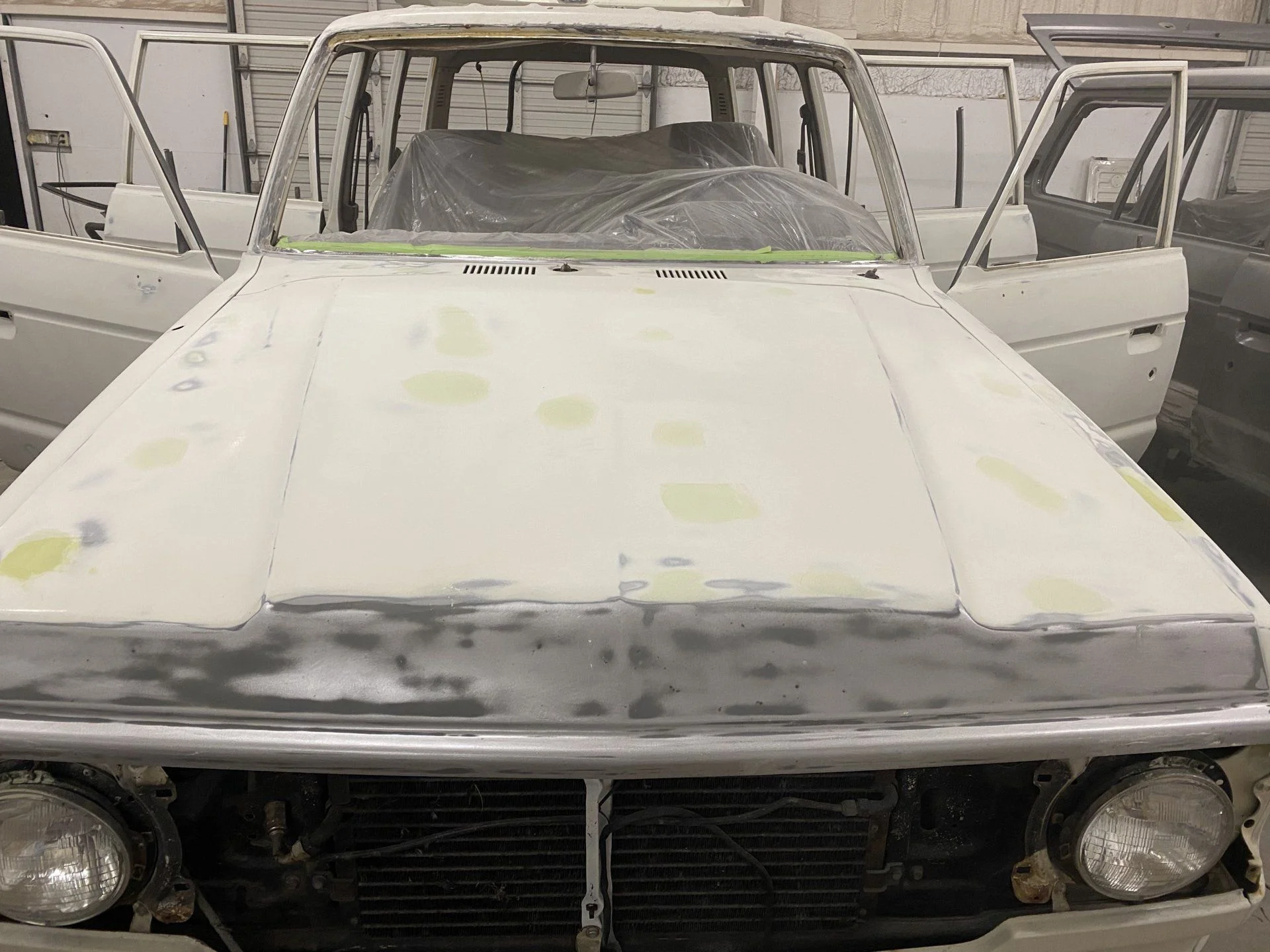

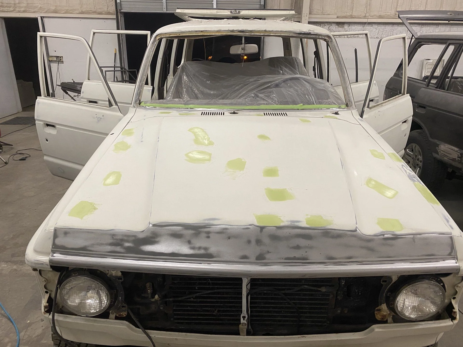

Hail damage repair on hood. Also, the front of these hoods will most likely have rock chips across the front. If the vehicle has been repainted previously, then it's very possible that the old rock chips are trapped underneath and rusting/rusted. It is best to remove the paint to bare metal and investigate.
Almost there, paint day is close!
